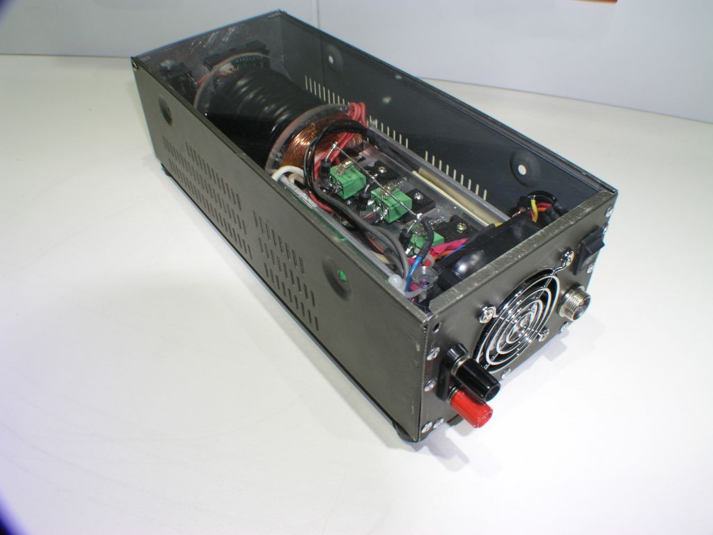

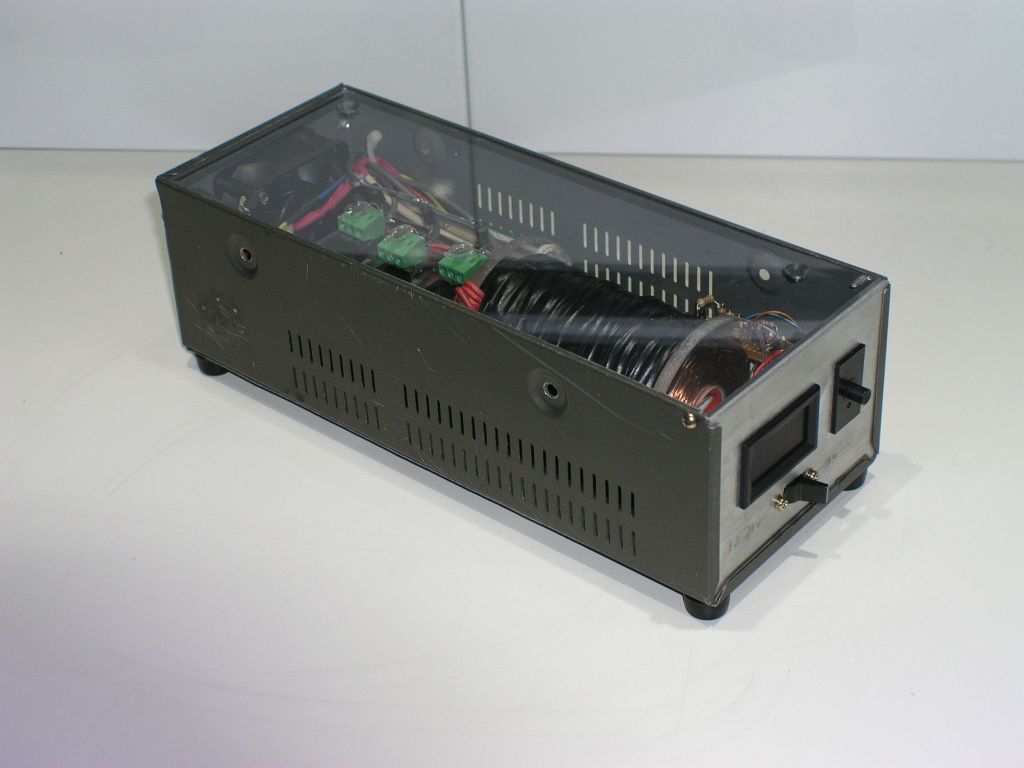

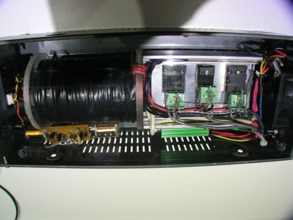

    Hi Tom sorry for the late reply. Been flat out busy. Pics attached.
    Basically I used a lot of recycled bits to build it. There is a "charge control" circuit included to stop overcharging and also detect undervoltage.
    Coil is quad-filar 70m per length on a bobbin, 20mm ID, 130mm long and about 75mm in OD.
    Neons were included in this one for swapping over transistors without internal protection. I will be changing over to all FJL6920 as soon as I get them.
    Consumption is around 1.5-2A@19Vdc on a 48V bank.
    I really like this style of charger for larger batteries...on smaller batteries it is a bit much for them...
    Btw base resistance is 50R 50W aluminium cased resistor.

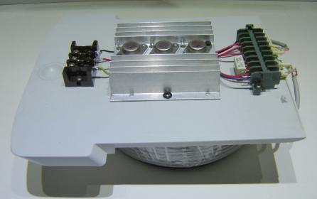

          Recycled network cable cat5 solid state coil
          Hey just thought I'd share another little experiment I knocked up. Basically it uses 3 old school 2n3055, solid state circuits fitted under the heatsink...running a 100R base resistor.
          The coil is basically 80m (est) of Cat5 4 pair network cable AWG24. I doubled each pair to make one circuit (giving a resistance of 3.3ohm per winding). So one trigger 3 power.
          It works like a dream. Self triggers nicely....
          So there is no need to go and get magnet wire to try these circuits out....
