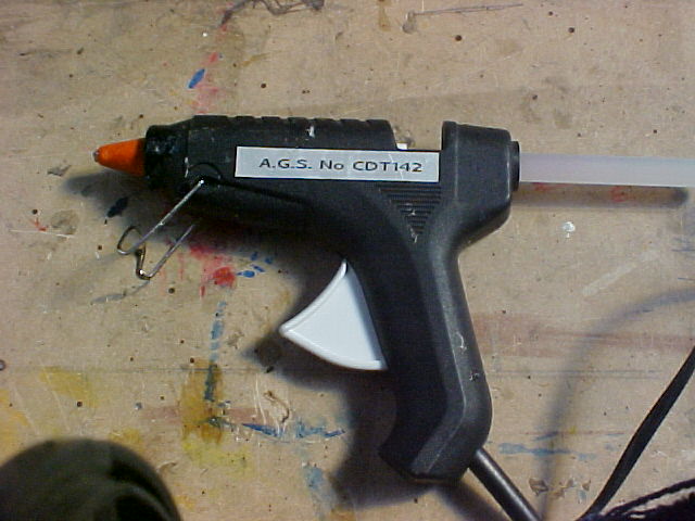

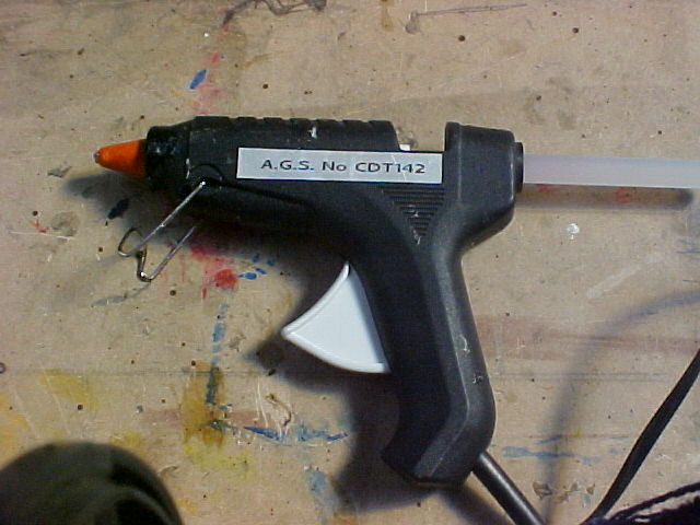

    I use glue or glue gun

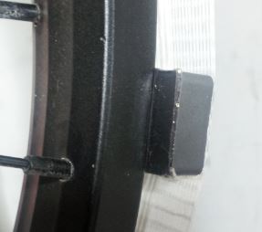

        I use double sided VHB tape from 3M it has very hi holding, can be repositioned easily for a few seconds and is hard to peel off after it sets. add a bit of strapping tape to the outside and it will never come off.
          Agree with Tom, I have had my rim close to 600RPM and the magnets are solid. Allows you to swap magnets/change spacing easy.
