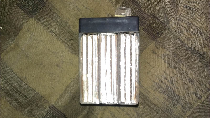

I know that it possible to fill up with distill water the SLBA battery, and i done so already, the problem is with SLBA battery that it depends on cells shape, in my case if i start charging battery with conventional charger the voltage of my battery jump to 16 Volt and some bubbles came off the battery, so any advise will be appreciated.

Take a very small screwdriver and carefully pry around the top cover and it will pop off. Under that cover you will find small rubber caps. Remove those but first do you notice that they are under a vacuum pressure, meaning sucked inward, when you remove the cap does it suck in air? If it does than that is a good indication that you dried them out and over discharged.
Take the rubber caps off and put about 8-10 drops of distilled water in each hole. Do not fill all the way. There are porous separators between the plates that you want to moisten but not flood. Let the water soak in for an hour.
If you charge these on your wheel there is a good chance you can bring them back to life. You may have a cell reversal which you can correct sometimes. Charge it up and discharge it several times and you may see improvement. It is worth a try since they are junked now anyway.
If you can get them working again then only charge them to 14.8v in the future. The main problem with sealed cells is that you will convert the electrolyte to hydrogen and they will dry out. If you put a few drops of water in them every once and awhile you can counter act this process but it is not an ideal situation. You are better off with the other wet cells.
