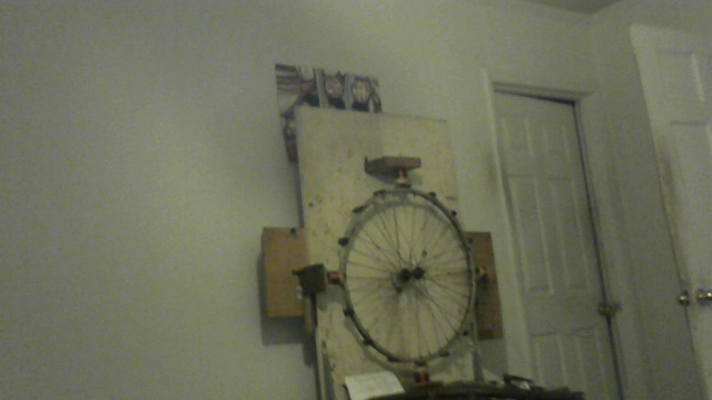

        21 on a 26in rim is about max/ my 16 mag 26in rim works great you need that spacing so you get the south pole between the north facing magnets//its so the transistor turns OFF and on all the way

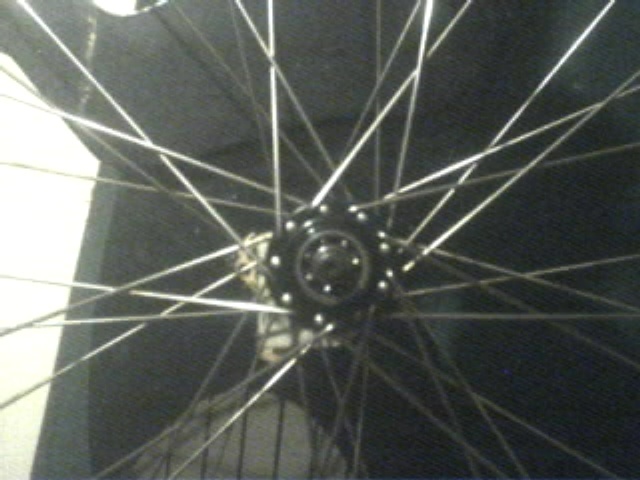

        iv seen wood wheels work but why build in a problem into the hart of your system when you can get a rim with great roller bearings .light weight .long spin time //when i went to the bike shop told them what i was doing [showed them a pic of a ssg] said i need a rim with a good spin time they were more than happy to help [something diff than bikes all day]
        NOT CONE TYPE bearings. since its going to run for hundred if not thousand hrs GET A GOOD RIM he who has the longest free spin time is on the road to a good c.o.p. [winning] i think i spent 75$ best money i ever spent , iv had same rim 6 years thats 12$ a year . i had a mich. shop cut slots to recess magnet into rim they kill that rim [bad im still madd] DWTAI i could have done better with hack saw and blindfold

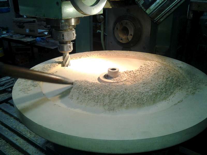

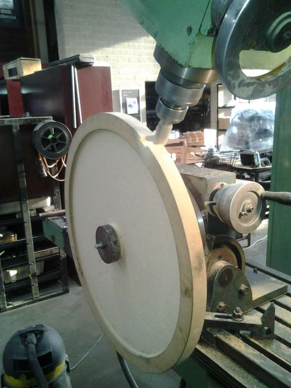

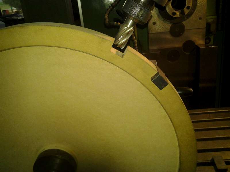

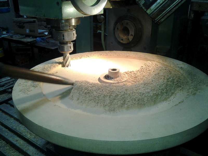

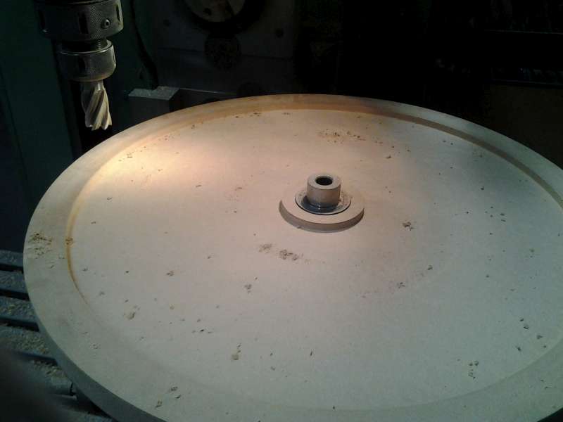

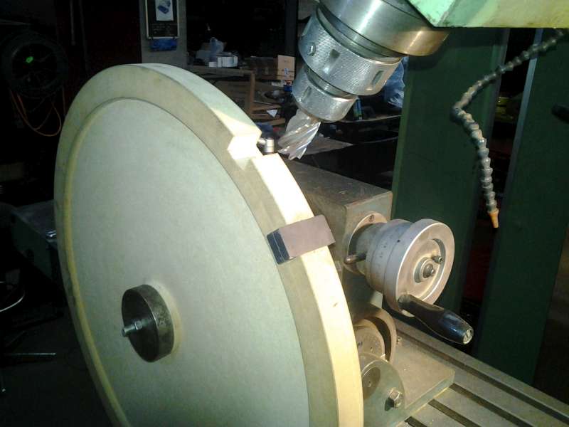

                  here are some pics of the new wheel under constuction
                  spacing is accurate to 0.05 degree

                    just tested frre spin time without magnets and its now at 9.5 minutes on new bearings
                    i expect improvement after some run in time

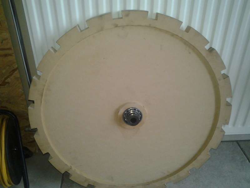

                    pic of finished wheel
                      Cannot see the last picture and really want to! Looks like you need to fix the link. Really interested in the build. Nice work, I'm envious of the tools you have at your disposal.
                        retry on the pic

                        the tool s we can use are from my work
                        i work in a engine rebuilding company so we have a lot of good useble machines.
                        we only need to watch the dust
                        im glad my boss allows us to use the chop for those things

                            Originally posted by wild weasel View Post
                            retry on the pic
                            [ATTACH=CONFIG]3478[/ATTACH]

                              hello Yves
                              yes its mdf
                              yeah i can imagine that its not easy to do this if you dont have acces to machinery like we have.
                              im Lucky i have the tools at work and allowed to use them in free time
                              as for bearings
                              i used standard machine grade bearings inner diameter 40mm and used a piston pin of same size
                              steel shaft of the size of the bearing could do as well i just had the pin arround from an engine we took appart
                              as for the wheel.... we started with a square plate 36mm thick and roughed it round with a saw
                              finished it on the machine to a diameter of 66.85cm
                              outer edge is still on 35mm after milling out the slight wobble of the plate and the middle we dropped down 1 cm to reduce weight on both sides
                              regards
