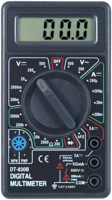

              One more question whilst i'm on, how do you measure the amps going into the charge battery and out of the run battery? I've tried every setting on my multi meter but can't seem to get a proper reading. Does this multi meter even have the right function on it? I'm new to multi meters as well! lol

                  Thanks for the link tom. Just saw the video. I get how a multi meter works now pretty much. I knew how to select DC volts but that was it.
                  I still don't get where on the SG i put the test leads to check for the draw. I understand that the positive lead goes on the positive of the battery but where do i stick the other lead?

                    • #25
                      it goes in series on the primary battery positive wire. I dont know why your pot is not changing things there are lots of reasons. test it with your meter see if its good.
                          Hi Tom. Could you be a bit more precise please. (still learning the basics) If i want to test the draw on the primary, where exactly would i put each test lead. The red lead on the positive terminal of the battery and the black lead where??
                              Hi Marine, red test lead on run battery positive and black test lead goes to top wire of coil. Something like "Primary+----<O>-----Coil" (where <O> represents your meter.) Again, remove the wire that goes to primary + and insert meter in series between the battery and the wire that goes to primary +.
