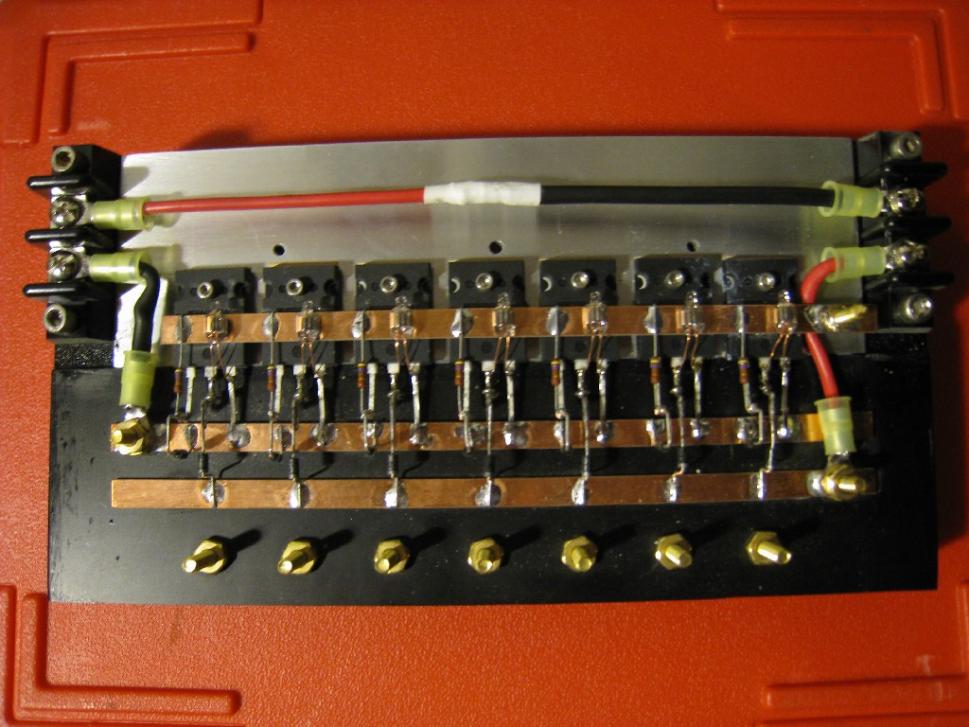

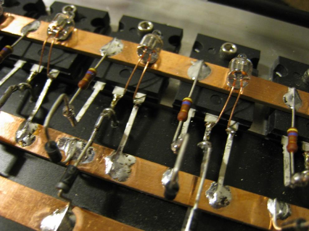

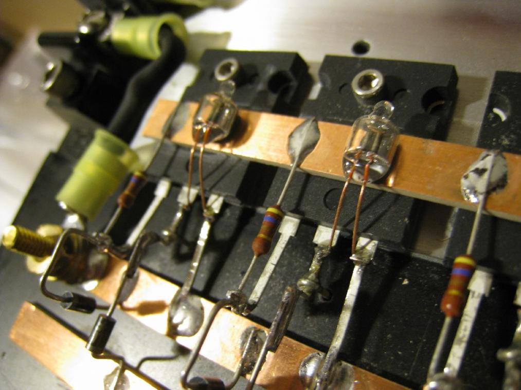

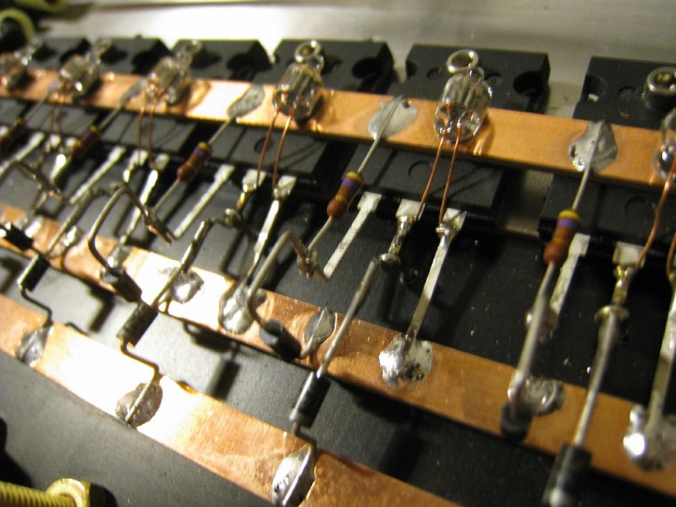

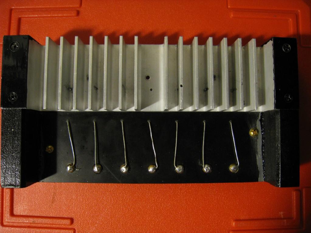

        Got my terminal strips today, put on a little paint, added the wires so I'm officially getting close. Pretty exciting. I promised some pictures, so here you go.

        Thanks again... Hopefully I can get the stand built soon so I can get back with the completed unit. Ciao.........
                  [ATTACH=CONFIG]2744[/ATTACH][ATTACH=CONFIG]2745[/ATTACH][ATTACH=CONFIG]2746[/ATTACH][ATTACH=CONFIG]2747[/ATTACH][ATTACH=CONFIG]2748[/ATTACH]
                  <marv>
                  Marv I dont see any insulators behind the transistors, are there any?
                    Looking at Marv's set up, where do you buy the copper strips from? Is there a particular place that i can find them online?
