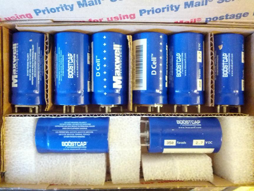

    I recently ordered some Maxwell 350 Farad 2.7V Supercapacitors, but I have had some problems trying to charge them. When I put it on a normal battery it acts like a short and the wires will start melting. Probably because it's trying to charge it all at once. When I try to charge them on an SSG it acts like a short as well. This is probably a noob question but how do I charge a supercap on an SSG circuit? Has any one done it before?
    Thanks.
