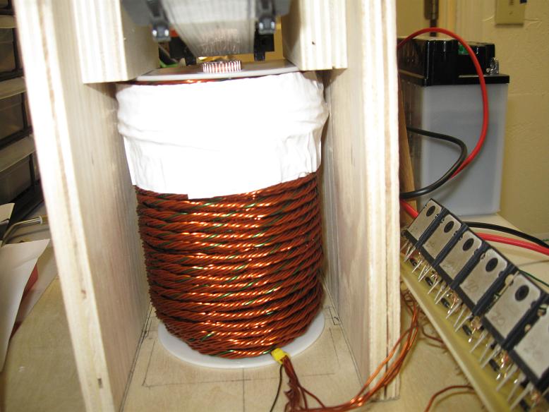

I just wanted to post some pictures of my newest build. I took out the old r-charge #23awg and #26awg bifilar coil and wound a new 130' 9 filar #18awg and #20awg coil. I heard some weather was coming in so I litzed the wire in the driveway and the next day we sure enough got hammered by snow for the next few days. I now had a bunch of litzed wire and all the components I needed to upgrade my old bike wheel. Made for a great winter storm indoor project! I could not get all that wire on a standard Pittsfield spool so I took two of them and cut about 1/2 inch off one end and super glued the two longer pieces together for a 5" long spool. The wire just fit on that spool. Here are some pics:

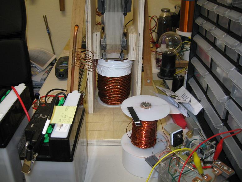

In this first one, you can see the old coil in the foreground. Quite a difference!

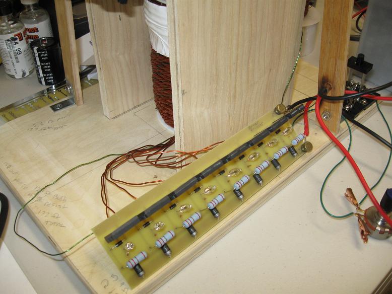

Just beginning the first runs. Looks good so far. I'm starting with 220 ohm resistors on the bases. So far my draw on primary is 440ma with about 200 RPM and 178 ohms on the trigger pot.

You can probably tell you don't even need heat sinks.
