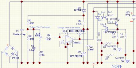

this is my comparator circuit with reset point adjust.....
it is reverse input on the opamp from what JB's comparator circuit is...... this allows the Hysteresis reset point adjust to work correctly........
the MAX931 is a very Low power comparator, and can be used in less than 12V circuits, like SG oscillators run from a Crystal battery to charge the capture cap...
as always, the values may need to be tweaked for your system.....
i have a couple of versions of this circuit running with small differences between them.....
for 12 V systems or less, will NOT Work in 24V battery charge systems
JB has not approved this circuit, so i will take it down if he does not approve of it.........
PS: Ignore the lines coming off of the top of C2, an the line off the output of the comparator, and going off page to the left.......
