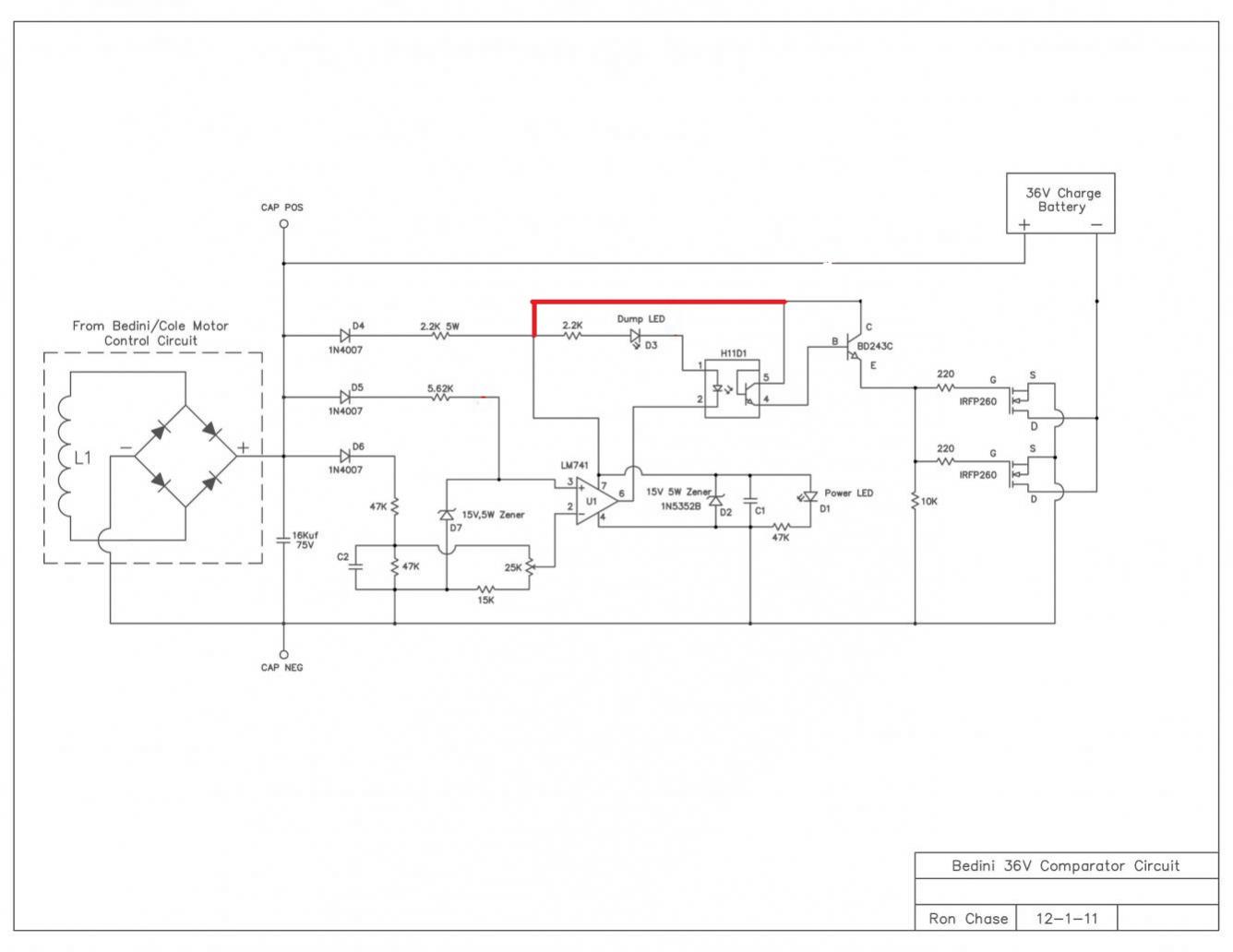

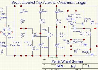

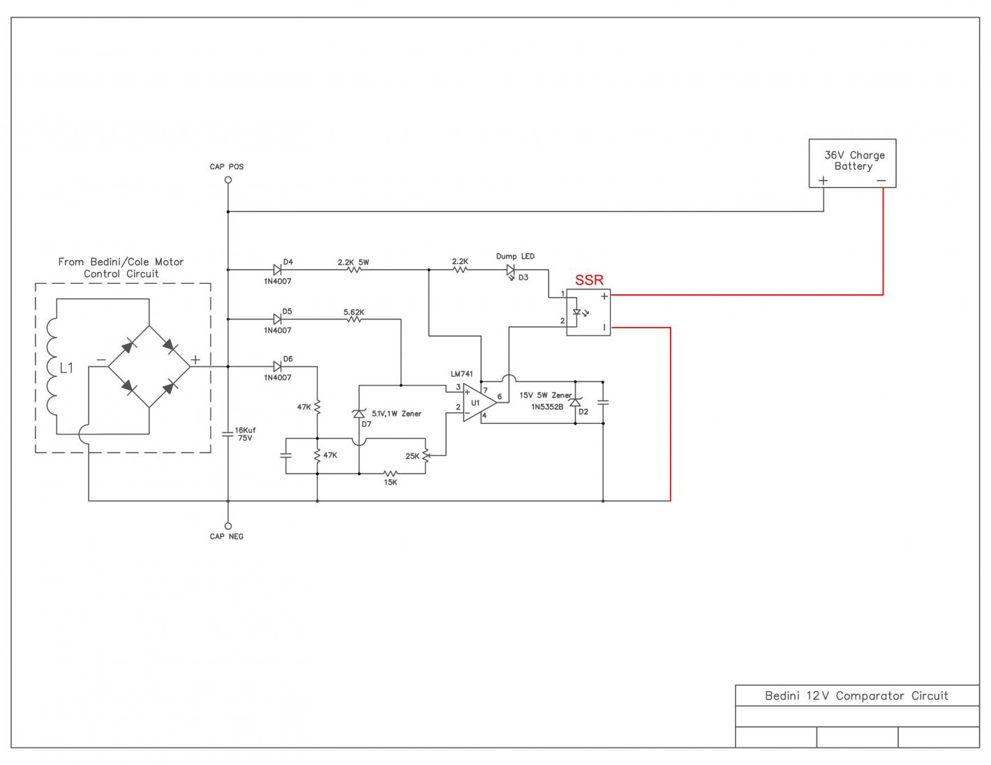

Originally posted by vallentin
Perhaps. Im still catching up myself. The comparator circuit was talked about in the Ferris Wheel thread over on Energetic forum. Ron posted his schematic over there. My basic understanding is that it is a Cap dumping circuit which is triggered when the voltage in the capacitor reaches a pre determined level. Beyond that I am still a little hazy. Perhaps someone who is more familiar with it could expand on its functions.
Shan

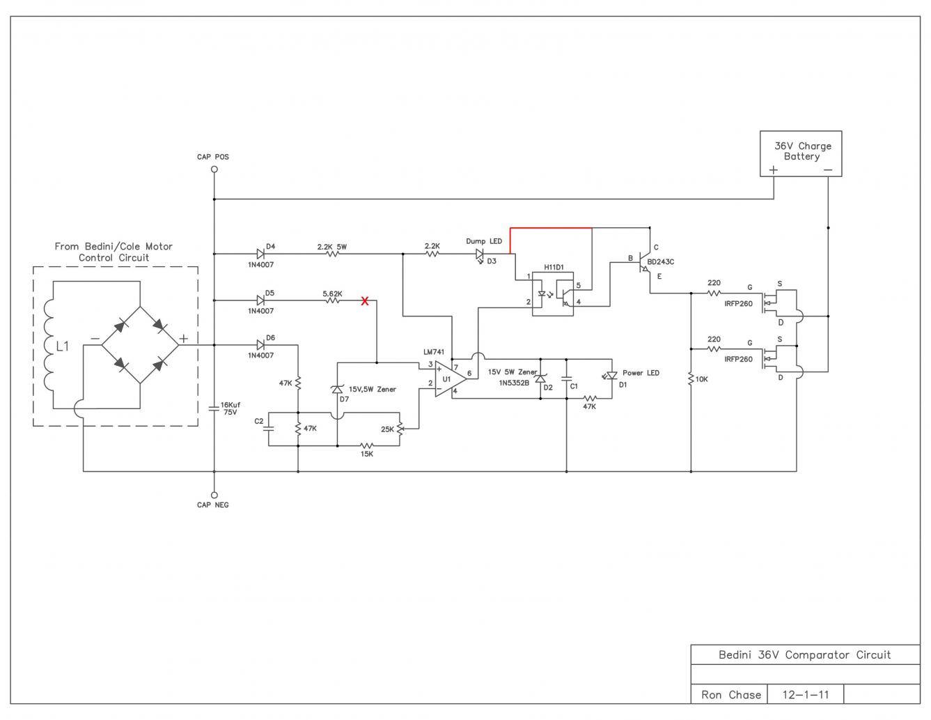

action of the SSR or FET. The circuit with the neon bulb trigger is also triggered by the Bedini/Cole switching action but will not switch with the SSG circuit. Just stays on so no sharp spike to the battery. Interestingly though the batteries do charge up even in the latched state. This is similar to the solid state chargers without wheels. There is a pulse charge occuring but at a much higher frequency than the ferris wheels.
