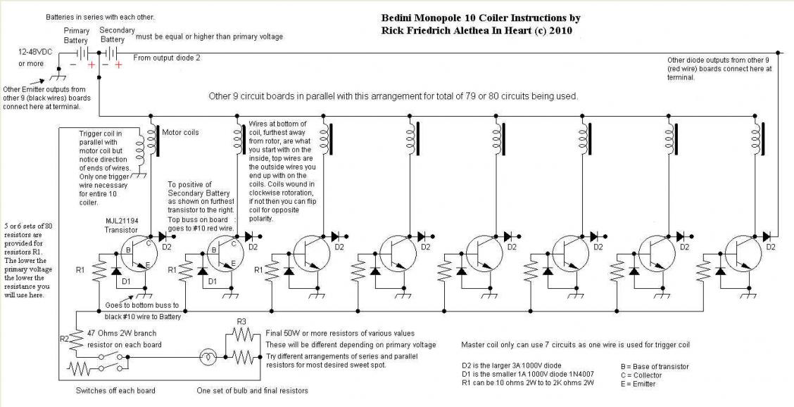

Hi All,
I recently asked for and have received the 8-coiller circuit board, together with the 8-strand #23 coil.
I have tested the 8 coils with the single transistor SSG and believe that it is now resistance tuned.
So that the next step is to remove the single transistor SSG and replace it with the 8-transistor circuit.
The mystery is how and where to make the connections to this 8-transistor circuit board.
If there are perhaps some pics somewhere? Or if someone has enough patience could they help, please.
What I want to do is bring this machine up slowly, if possible connecting one transistor at the time.
I see there are 24 connection points across the top, and I know there are 16 wires. Two wires are for the trigger coil,
and 2 wires are for the first power coil. My sense about this tells me that the power battery and the charge battery are connected,
but I am confused about exactly where the connection points are.
To be clear:
1. What/where are the connection points for the two ends of the trigger coil, and which one is the
connection point for the top trigger wire?
2. What/where are the connection points for the two ends of the first power coil to be connected,
and which one is the connection point for the top one?
3. What/where are the connection points for the positive of the charge battery, the negative of the run battery,
the negative of the charge battery, the positive of the run battery?
I am looking at it with the heat sink at the bottom and the terminal block at the top. The resistors and other components
are exposed in this view. This means that the number one transistor/#1Tran is at the lower left hand corner.
Once this machine is up and running I will have another story. Right now I just need help making the connections.
By the way I am surprised with testing results so far, with the one transistor circuit. Cheers.
I do have the included circuit diagram, for reference.
