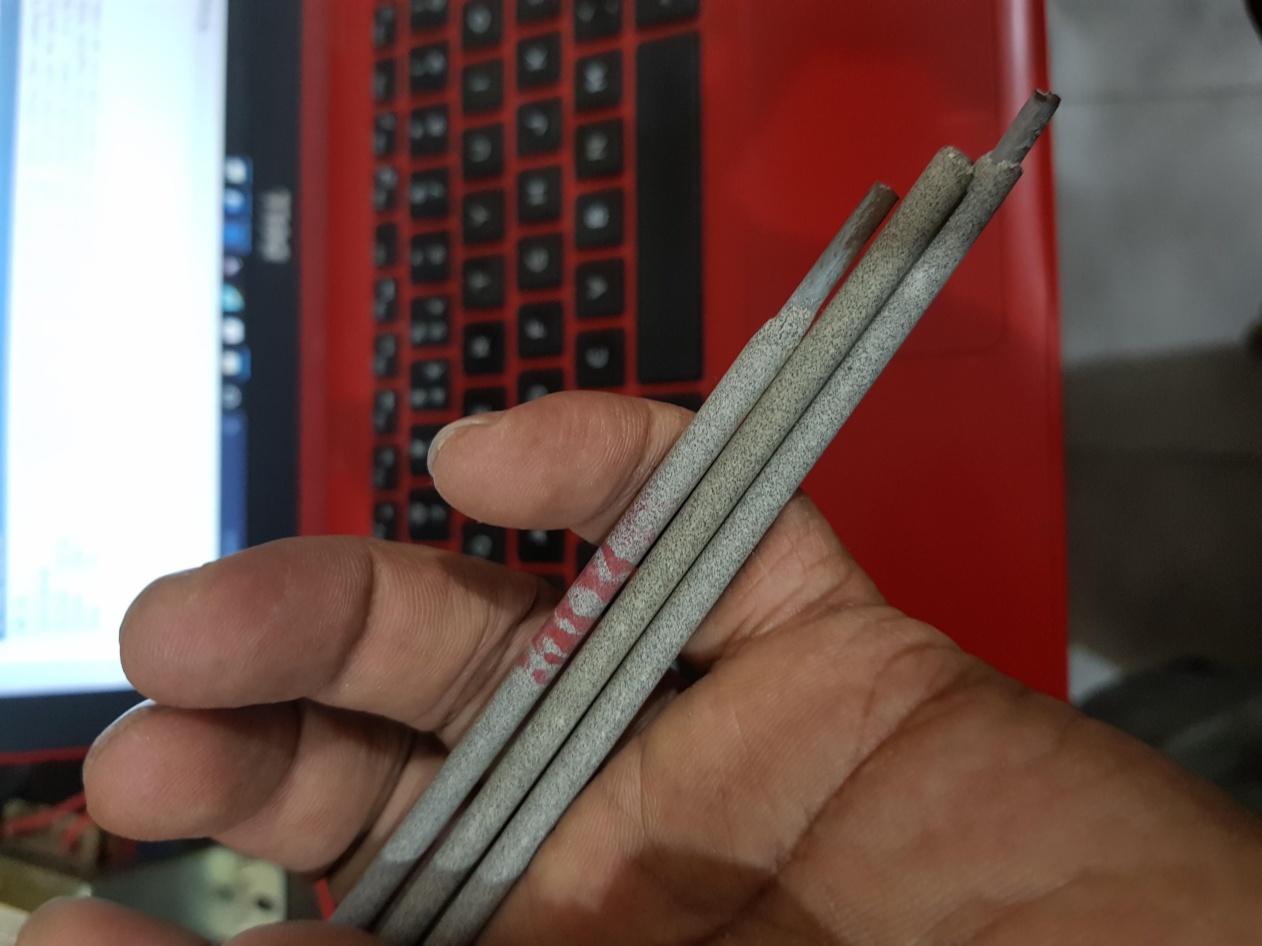

          Hi,
          Here in India we get this type of welding rod, which doesn't have the copper coating but instead has the welding flux coat (The grey coat over the main iron rod) that acts like an electrical insulator between the rods when you arrange/stack them in the core.
          here is the picture below:

            The problem with those welding rods is that the grey flux is too thick.... if you soak those rods in water until the flux melts, and then sand the rods a little, and soak them again and then let them rust they will work, and you can get way more rods in the core than with the flux on them

                    RS ,
                    Thanks for your inputs however, I noticed that despite of such thickness of the gray flux,the core is seen getting hot due to eddy current Induction, imagine what would happen if you further reduced the insulation?
                      If you are having heat issues in your cores, than your rods are to big in dia, or they are the wrong material
                        RS,
                        You are right, I have switched to using ferrite filled cores ever since this issue, no more heat now.
