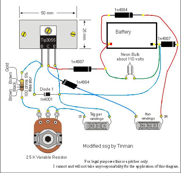

    I have used this circuit from 2v to 48v. You may have to double/triple up on some of the diodes if you are going to the higher range. Click image for larger version

    If you are looking to build a vehicle of some sort you may want to look into commutation as well. You can push a lot of current and not have to worry about blowing transistors.
      I have used this circuit from 2v to 48v. You may have to double/triple up on some of the diodes if you are going to the higher range. [ATTACH=CONFIG]5482[/ATTACH]
      What is the point of the 1n4004 diodes in this diagram? Why not use 1n4007 for all of them?
      Also, I would like to conserve as much current as possible, but it needs to be pushed upwards of over 2k RPM. I tried something similar to this diagram a while ago, using one of my mjl transistors from a SG machine, and only a 9v battery. It ran, but it got nowhere near 150 RPM's, let alone over 2k... However, I haven't tried this particular one yet.
      Is it completely necessary to use the TIP3055? Or would another trany work? Im not familiar with the specs on that one...
      -Pastor Gordon
        I use that circuit just to get my devices motoring before I hook up a permanent circuit to them. I actually have a 1n4007 in place of the 1n4004 and it runs fine. As for the transistor, you can use any NPN that can handle the voltage/ current if you are just looking to make a pulse motor and not an energizer. I have a TIP41C (.35-.45 each) hooked up on my module. Check the data sheets online before you purchase. I have only been able to get skateboard wheels to spin at 2k+ rpm's on the SG type circuits with one coil. The last one I put together was on a 22mm diameter skateboard wheel with 4 - 1/4" neo's with norths facing out running in repulsion. The one coil was trifilar with 2 power wires at 28 awg and one trigger at 30 awg. I put 850 t's on a small spool. I put 1/4" wide bundle of welding rods in the middle. It spun up to 2700 rpm's with 12 volts. If you are going for a larger flywheel I could only speculate.

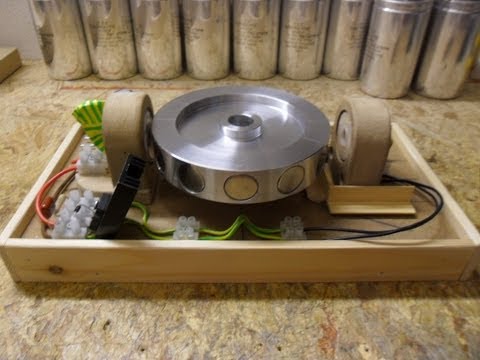

          Here is a video of a very similar setup I want to build... Notice the high RMM's this thing puts out...
