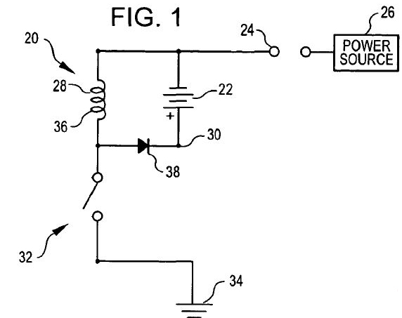

            James perhaps this will help.
            From Mr. Bedini's Patent #US79990110
            FIG. 1 is a schematic view of a circuit 20 according to an embodiment of the invention. The circuit 20 can be used to recharge a battery 22, and can also be used to repair and/or rejuvenate a battery by improving the proper removal or deposit of material from/on an electrode of the battery. The circuit 20 includes a supply node 24 that can be coupled to a source 26 of power having a voltage. The circuit 20 also includes a voltage generator 28 that generates a magnetic field when the power from the source 26 energizes the generator 28, and that generates a voltage from the magnetic field's collapse when the generator 28 is de-energized. The circuit 20 also includes an output node 30 that provides access to the voltage generated by the voltage generator 28, and a switch 32 to allow one to control the flow of power from the source 26 to the generator 28 to energize or de-energize the generator 28.
            In operation, the circuit 20 generates a voltage spike—a high voltage condition lasting for a short period of time—from the collapse of a magnetic field that is generated by the voltage generator 28. Because the magnetic field collapses quickly, the voltage spike forms quickly, and the voltage in the spike is high. When the magnetic field is generated and then collapses, repeatedly, the circuit 20 generates a series of voltage spikes. Each voltage spike is directed to the output node 30 where it is available for use by the battery 22 or some other device. When the circuit 20 generates a series of voltage spikes, the voltage available at the output node 30 pulsates. Thus, the circuit 20 can apply sharp, high-voltage spikes to recharge the battery 22.
            The voltage generator 28 generates the magnetic field from current flowing through the generator 28. When the voltage generator 28 is coupled to the power source 26 and the switch 32 is closed, the voltage of the source's power causes current to flow through the generator 28 and toward ground 34, thus energizing the generator 28. To collapse the magnetic field generated by the generator 28, one opens the switch 32 to stop the flow of current through the generator 28, thus de-energizing the generator 28.
            Because the voltage spikes are brief moments of high voltage, the spikes can be used to provide a battery 22 pulses of substantial current to recharge the battery 22 without generating excessive heat in the batteries anode and cathode plates. Current delivered to the battery in the form of these high energy impulses can improve the proper removal or deposit of material from/on an electrode of the battery. In addition, because the voltage of the voltage spikes is typically greater than the voltage of the power source 26, the circuit 20 can be used to recharge a battery 22 having a remaining voltage or a fully charged voltage that is greater than the voltage of the power provided by the source 26.
            I built this circuit exactly, accept I used a micro controller in place of the manual switch. One of the best boards I have EVER built, want to learn about mode one,,,, try it!
