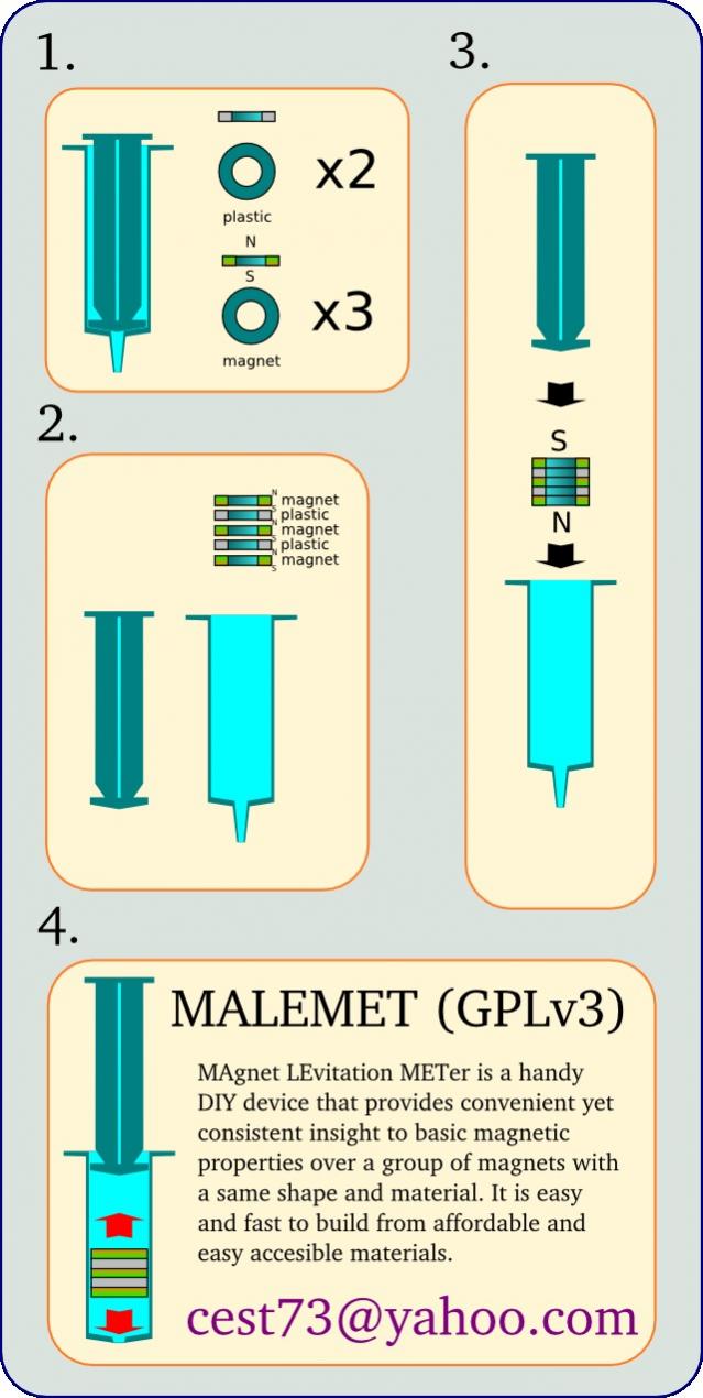

      i built a 4c 16 t 133 foot 20/23 a foot 1/2 lead out each coil; all 16 p wire same ohm ;went through 50 mags to get 16 on a 28 in wheel -free spin time 20 min + . It is not a sp. the build b4 was the same but coils were wound sloppy and not a match and magnets either . the improvement in neat wound coils core [same no. of rods] same ohmage long spin time, match magnets is it runs on less alot less .it is important to me to have all run wire same length/ then ohms [oh BALLANCE ] https://groups.yahoo.com/neo/groups/...otoFilter=ALL# this is not my pic but what i madeClick image for larger version

        In my last little build I selected 20 magnets over 40, I made a little gauss meter with 5v dc + lineal hall sensor + voltmeter,
        But it was a very hard work, first I took measurements of all 40 magnets south and north poles, then I picked the best 20.
        After that I stack them in pairs, because I have 10 magnets slots in the wheel. After that I used again the gauss meter with the magnets on the wheel, and started to take measurements again, 1 by 1, changing them around, etc, etc, a very long work but necessary.

          You all must be better builders than I am. I thought I had gone beyond the call of duty to match everything, including malemet as per Guy and Cest, same number of core rods, wire, using circular busses,matched diodes, matched resistors and even with matched transistors (from Teslagenex) all on the same Teslagenex board! Using two separate coils - the spikes differ in amplitude, and this is with my "cheap" $250 scope my spikes are solid and do not jump up and down, no ghosting moving h waves at 300RPM or even 4500 RPM on smaller machines, I'm not even using the $5,000 scope john had in DVD2.
