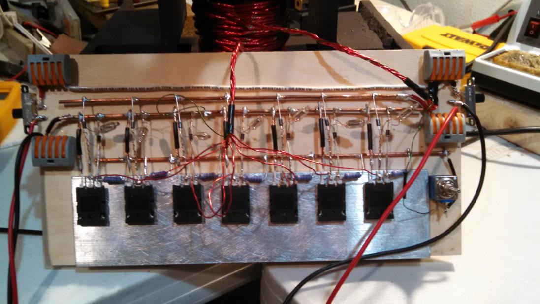

I just read through the post by Lman about Beta Matching and find myself in a similar pickle. I have purchased a set of 7 matched transistors from teslagenx. However, one of my transistors is overheating big time (some smoke happened which I hope was the glue). Here are the symptoms and tests I have made:
*1 transistor overheats even before the wheel is spinning - just by connecting source and charge batteries (I think the charge battery starts the instant heat up)
*I thought maybe a diode failed. I replaced the 4n007 on the base but problem persisted.
*all the 100 ohm resistors to the base are matched
*At first, there was not continuity from all the trigger coils to the collector - I changed this.
*Using the diode setting on my dmm, the "resistance" across the base diode is 63 while the same measurements for the other transistors is about 83
*The transistor is not shorting to the aluminum heat sink.
Thanks for any insight.
