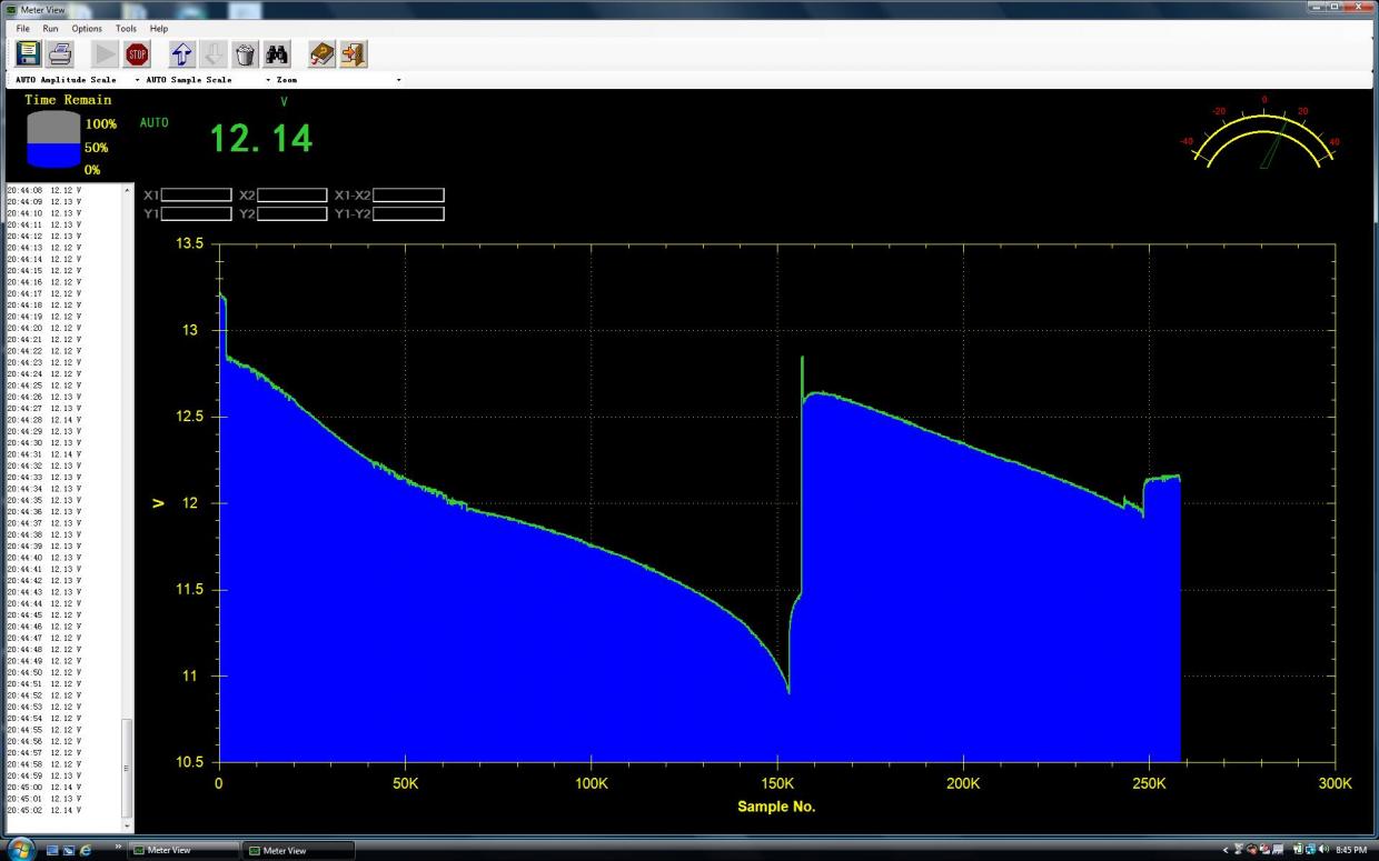

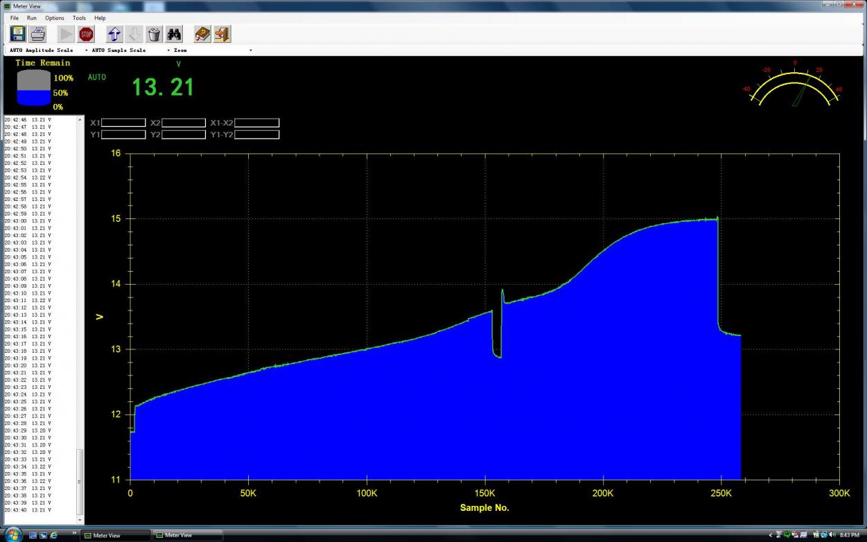

                              Run Update:
                              Ok that first run is completed and I shot a video of me checking in on it a few times while it was running, making comments if anyone wants to see that it will be posted below.
                              Reminder of what we are looking at on this run. I started with two identical batteries which were the walmart "109AH @ 1A" deep cells. I would guestimate these are about 50AH or so on a c20 @ 3.5A but who knows, maybe later we can run the CBA on them.
                              We did not get a 1 to 1 on this Run, not even close. I put a second primary in to finish the job. The run was done at 1.5A pull on the primary throughout the whole run. I adjusted once and you can see that just before I switched the primary out. It had drifted about 100ma because of the voltage drop so I compensated, other than that one time the resistance was not touched.
                              Here are the charts:
                              And the video:
                              https://files.secureserver.net/0sFkzHMfZwP8DK
                              Over all I am happy with the performance of the charger so far. Next I am going to recharge that first primary at a 3A draw rate. I think the machine does need a bit more on the draw that 1.5A , maybe not 3 but who knows. I am bringing you guys along for the ride with me, remember I just built this thing and this was the first full run I ever did on it.
