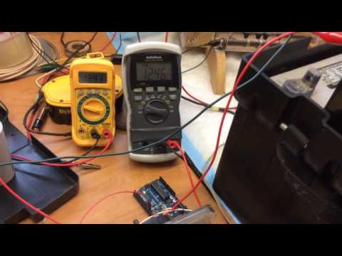

                    I finally received the little 4 amp relays you mentioned earlier on, i put two of them in parallel and the setup worked just like it should. I could not find data sheets on the other relays that i purchased. However i did order some of the crydom's d1d40, ( they actually sent me d1d40z) they will work when the chg neg is parallel with run neg. i think it may have something to do with "z" designation, it signifies an internal voltage suppression device. They are sending me the correct ones, i'm feeling confident now that i can get this to work. I have the capacitors on order, that could take a while.
                    My setup is laid out pretty much like Bob shows in his videos, coil is a bifilar 20 ga and 23 ga. The arduino is running at 9.5 hertz, run battery is a 76 ah agm wheelchair battery (approx 16 yrs old) started @ 12.81. (Pause) i forgot to mention i also have a welding rod core in the coil that extends higher than the coil iself, on the core i have two small pancake motor coils in series hooked up to a voltage multiplier circuit, output is then looped back to the run battery. ( resume) the charge battery is two 2.9ah agm security light batteries ( roughly same age) starting voltage was 12.23. I ran the setup for about 2 hrs and 15 min. And in that time i was able to charge batt 1 to 15.33 and batt 2 charged to 13.56. Setup is drawing about 200-250 milliamps, kinda hard to be sure do to the pulsing. The run battery sat at 12.73-12.74 during the entire time, this morning i checked the battery voltages, they are: run batt 12.81 Batt 1 is 12.89, Batt 2 is 12.71. I will try to post some pics or a video at some point.
                    Thanks again Bob for your willingness to share your work and findings, i appreciate it, i am looking forward to more videos.

                        • Here is a video of my "replication" i need to tidy it up but at this point i am just pleased to have it working. It took about 1 1/2 hrs to charge from 12.54v to 15.48v. Both batteries are 2.9 ah the one with bedini on top was conditioned with an energizer that my son and i built for his science fair project years ago, it normally rests around 13v. Tonight when i started it was at 12.78, when the switch was turned on it dropped to 12.46 and stayed there the whole time, occasionally bouncing to 12.47. When the run was finished it returned to 12.73 within 15 minutes.
                            Brian that's great man, thanks for sharing!
                            One thing I notice is on your charge negative you look like you are doing a common ground setup right? Typically I will put a diode between the chg neg and Pri neg if i'm doing common ground. What I actually do is put a double throw switch there so that I can switch from mode one to common ground quite easily.
                            All you need to do that is get a double throw switch ok, run the charge neg line from your terminal block into the MIDDLE pole of the switch. Now take the top pole of the switch and run an extension over to the chg pos. Run another extension from the bottom pole over to a diode (black side) then from the top side (stripe) to the Pri neg. When you want to run mode one flip the switch up, common ground put it down.
                            Anyway that's great work you have already, I am just suggesting an addition that I run on mine. One reason you would want to do it is because in common ground you really can only have two batteries of the same voltage because of the common ground (otherwise the higher voltage will force itself on to the smaller voltage with a lot of current). If you want to work with dis-similar voltages you can use mode one say like having 24 on one side and 12 on the other or whatever. It is also just worth studying the effects of each way.
                            I like your back pop setup but you should be aware that that usually results in messing up the primary. Mr. Bedini did this in his early machines but later said not to do it because the constant chg/discharge action destroys the battery. He said it was better just to take the energy and put it to another battery charging it only and not taking a load at the same time. With that said I still see people running similar concepts like the 3 batt tesla switch for example. I don't know but it's worth mentioning.
                              (Response) good observation, i had it that way because of your video, after you mentioned it i looked and i actually have my + and - reversed from your video, i must have done that when i drew it out. Patrick made a suggestion on a you tube comment about just making another setup instead of changing anything on this one to see if I can replicate the results. I think i am going to try that before doing anything to change my current setup.
                              The back pop idea was a sort of a test to see what would happen, i have a large 10 farad capacitor that i would like to see if i can get this to run off of at some point in time.
                              When I build the next setup I am going to put the switch in place, i just wanted to see it work, i really got a littlle frustrated with the other relays. On a side note, i checked the voltage on my primary this morning before heading to work and it was at 12.78v, i checked again this afternoon upon getting home and it was still 12.78v. I am glad you shared this info Bob, this setup charged the battery in less than 2 hours, my wheeled ssg draws about 145ma and it take probably 12-20 hrs to charge it up like that. I am excited to see what it can do on larger batteries.
                              As i am typing i am thinking about your response and i am wondering if maybe the charge battery was pushing back on the primary. Something worth more testing.
                              One other thing i wanted to mention is the amp draw went down when putting the core in the coil.
