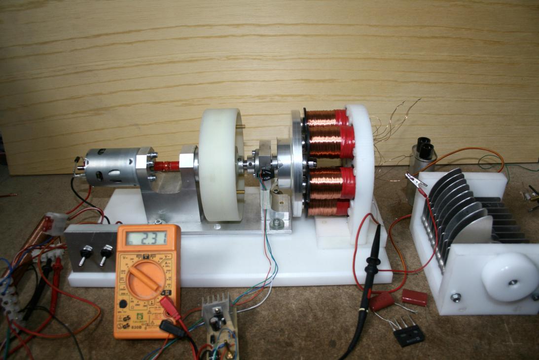

Bedini Original machine FEG 1984
Hi Peter,
Nice work on that. I want to build one of those too. I plan on arranging my coils radially around a drum type rotor, rather than a disk rotor. Thats the only change I intend to make. Where did you get that variable cap? Let us know how it performs!
-Woody"It's not a mutiny if the commander is leading it!" - Wally Schirra, Commander Apollo 7
Thanks Woody,
I got the plans from this site http://www.metaphoria.us/hamradio/DL5DBM_cap_plans.pdf for a 220pF 5kV variable cap. It took quite some time to construct. I am not 100% certain that it is a must have, but time will tell.
A radial set-up will get around the problem I had with the magnets creating eddy currents in the rotor bearing block
Best regards
Peter
Thanks Faraday. I remember you mentioning the depiction of the variable cap being a way of conveying the function, but not the specific hardware. I wonder though, would J.B. depict it this way in a diagram that he released to the public domain to assist people in building these units? I understand how it would be drawn that way in order to protect proprietary information in a patent, but I believe that drawing was not a patent drawing. I'm still trying to figure out what else could provide the same function as a variable cap without literally being a variable cap. Would simply using a variable cap work, or do we lose a necessary contribution provided by the "other method"? You definitely have me thinking, which I appreciate! I'm not the sharpest knife in the drawer, so give me some time.....and a few hints, maybe?
Hi Woody,
the thing that is 'Variable' can also be viewed as 'Tuneable' what is key to the system is the G-Field coil why is also of the 'Variable -Capacitance ' Nature. recall J.B does not show a Bridge Rectifier in between Energiser Coil and the 'Variable -Capacitance. that is good enough guesture i must say..!
the tunable nature of the function servos to the Dipole (Battery) being charged. it does it in two ways.
do you get it now...?
Hi Woody,
Clues for you:
1) This machine is an exact compliment of the SSG : I call this Inverted Inducto-Capacitive Fractionation.
2) The Switching (Tesla) takes place in the Magnetic Circuit (as opposed to Electric Circuit in the SSG)
3) J.B emphasis a lot about the Brass (non-Magnetic) make of the Staft to assist this Magnetic Switching hence a Flux -Gate
iteration.
4) I belive that the higher topology version of this machine which i am still studying can give massive Overunity performances. (>400%)
the above clues are the result of pure Physics of the Radiant Electricity...belive me.
Woody, Faraday88 & all
Update on the energiser testing.
I first tested the coils without any switching and found I had a base voltage of 210VDC.
This could be increased to 400V with only a modest increase in input current to the motor. This was done by adding various sizes of capacitors in parallel with the coil. When I tried the variable capacitor it did not make any difference.
I then turned my attention to a SS HT switch. When I first got it working, I found that without a capacitor I obtained a spike frequency of over 10MHz. JB has stated in the past that it should be between 1 – 6MHz. I tried the variable capacitor and found that this frequency could be changed from 5.6MHz @ 15pF to 4.46Mhz @ 100pf. So I now have the option of modifying the variable capacitor with shorter spacers between the plates. Add more plates or the easiest, get a couple of high voltage 100pf capacitors thereby increasing the range so that I can ‘dial in’ a frequency range between 1 – 6MHz.
The variable capacitor is not a must have piece of equipment, but it only cost me my time to build. The same results can be obtained with various size capacitors in the low to mid pF range. It is a good feeling watching the frequency change live on the scope when the setting on the variable capacitor is changed.
By the way do not check the temperature of the transistors with your fingers while the energiser is on. It’s a shocking thing to do. Ouch
Best regards
Peter
