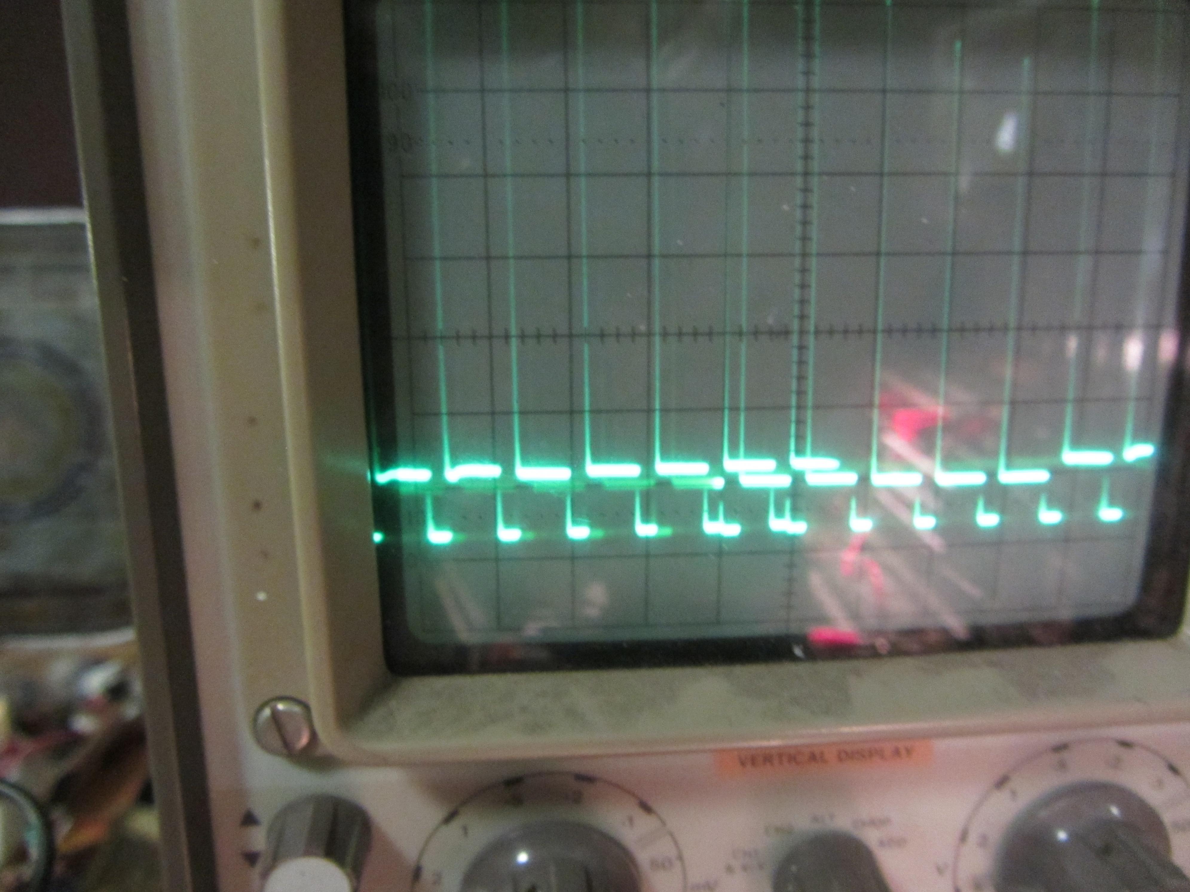

                I have knocked up a small test using an IRFP460 driven by one side of a TC4427, using a single coil wound with bifilar windings, the trigger coil is tied to the primary coil and the output is 6 wound hexfilar(?) . This is pulsing around1khz. Here is a picture of the scope output, its a bit unstable, but, you should see the pulse and"h" result . It is using approximately 200ma of pulse magnitude on a current meter. Is this what you are getting? I am using Peter's circuit framework as you are.

                      Hi Dwane, hard to say with that scope shot and without seeing your setup. What are the scope settings?
