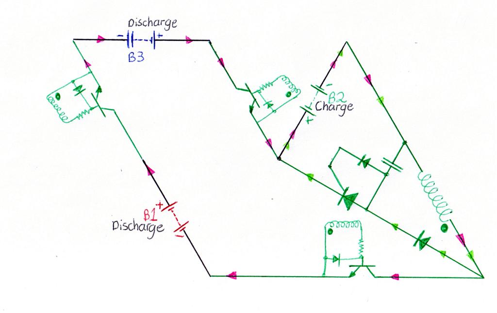

    This is a circuit I designed a while back, it rotates 3 batteries. Every battery gets a turn in every position. So every battery gets a turn to be the charging battery. This circuit is intended for use on a monopole energizer wheel. Each coil has 3 trigger windings, as well as 1 powering/motor winding. The circuit can be modified for as many powering windings as you like with is own transistor. The 3 trigger windings of each coil turn on 3 transistors to power the powering/motor winding. When current is passing though the powering/motor winding, the current is saved in the charging battery. When the powering/motor winding is turned off the back emf from the triggered coil charges a capacitor, when the capacitor is raised above 0.6V the capacitor is dumped into the charging battery. The circuit is Tri-Symmetrical so the same process happens for every one of the 3 coils.
    Q1b,Q1c,Q2b,Q2c,Q3b and Q3c can be replaced for low voltage drop SCRs, since Q1,Q2 and Q3 are turning off anyway which will turn off the SCRs and stop them from latching on. All switching devices must all have reverse blocking capability. So mosfets and IGBTs (insulated bipolar transistors) may not be suitable as switching devices in this circuit.
    The 3 coils are at 120 degrees out of phase with each other, so they are triggered one at a time. For example if you had 4 magnets on the wheel the coils would be placed evenly around the wheel, at 120 degrees apart.
    As different coils are triggered, the batteries are rotated in different positions.
    Here are 3 schematics showing 3 different battery rotation positions, with 3 different coil triggerings. This will help you get the idea.
    The red arrows represent the current flow, the green arrows represent the back emf(energy recovery from the coil).
Name:	Seg3 (Large).JPG
ID:	51188Click image for larger version
Name:	Seg1 (Large).jpg
ID:	51186Click image for larger version
Name:	seg2 (Large).jpg

    do you need the circuit in triangular shape? it would be easier to lay it out and etch it in a regular square format... is the shape important to you?
          Yes the triangle shape is important to me, it represents the best layout of the circuit with the shortest tracks. And if one was to design a circuit board layout, they would simply follow the triangle schematic layout. I have built 2 other variations of this circuit, and found out that if you don't follow the triangle layout, it results in many over-crossing wires as well as being very confusing to build.

            jamesgray3rd There are so many things you can do with this circuit, very many possibilities. The Tri-Symmetrical Switch is a framework for many modifications. It can be modified for a multi-transistor/multi-motor winding configuration like with the ssg. With some modifications it can be controlled with a 3 position sequential timer circuit, such as a 555 timer pulsing a CD4017 decade counter. So you can rotate the batteries every hour, 12 hours, 24 hours etc. And you can use the Tri-Symmetrical switch framework on 3 solid state oscillators.
            You can have all the power/motor windings on the same coil, I have tried this. But there is an issue with the trigger windings all on the same coil. The trigger windings need to have capacitive isolation from each other to prevent false triggering, but there are ways to design around this.
