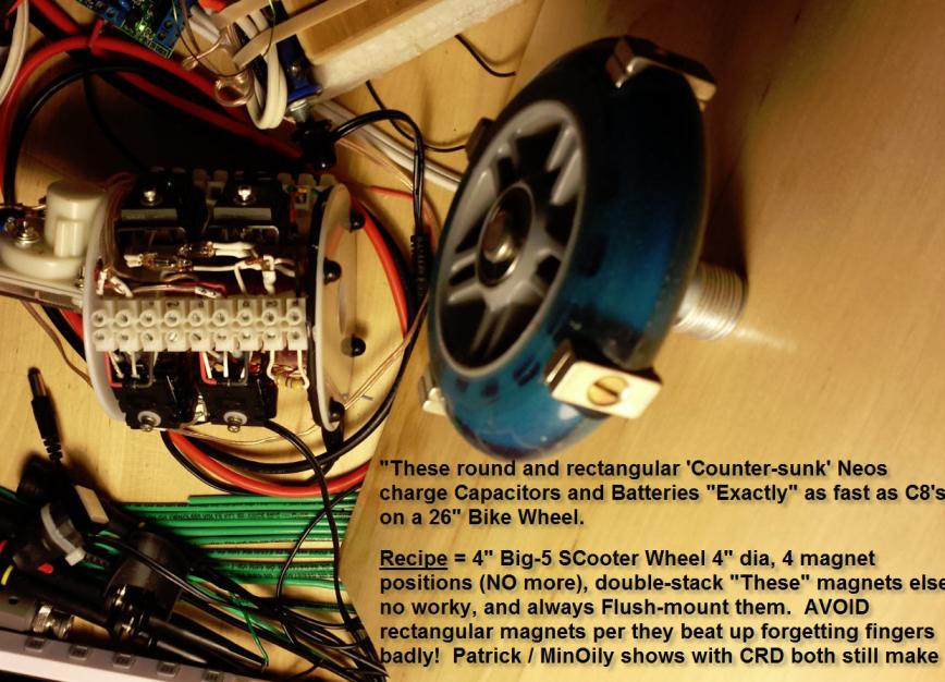

    I tested extensively the Officially Rx's C8s on a 26" Bike Wheel Vs. the Neos shown in these Pics I show below, and comment on with the pic's.
    I found this is NOT "Necessarily" true, and that "These" particular Counter-sunk Neo's are of correct strength for PERFECT SG operation. Absolutely zero difference between Cap Dump Charging dump frequency no matter if C8's + 26" Bike Wheel or either of "These" rectangular and "These" rounded counter-sunk Neo's, on "This 4" Big-5 Razor SCooter Wheel ! 2 for $18US.
    Samey same without using Cap Dump and just charging batteries. I have done this for 10 months going back n forth. I have zero use for the BIG wheel until I have enough coils and correct electronics to surround it with. Some of JB's 10-Coiler coils may really be generator coils, and may be using the Trani's to short those coils at 90 degrees and 270 degrees, I am not certain and no one is coming forth here so far to answer such things. I have focused on switching because the Tesla Switch showed me how bad switching the Beginner's way really is. Do you or your group members know how it is set up to make it charge both batteries???)***

    Addendum - Comment on Pic with Scooter Wheel and Rectangular double-stacked Neos that work! Comment says Patrick shows both Rectangular and Round make SAME shaped bundle of Magnetic lines of force.

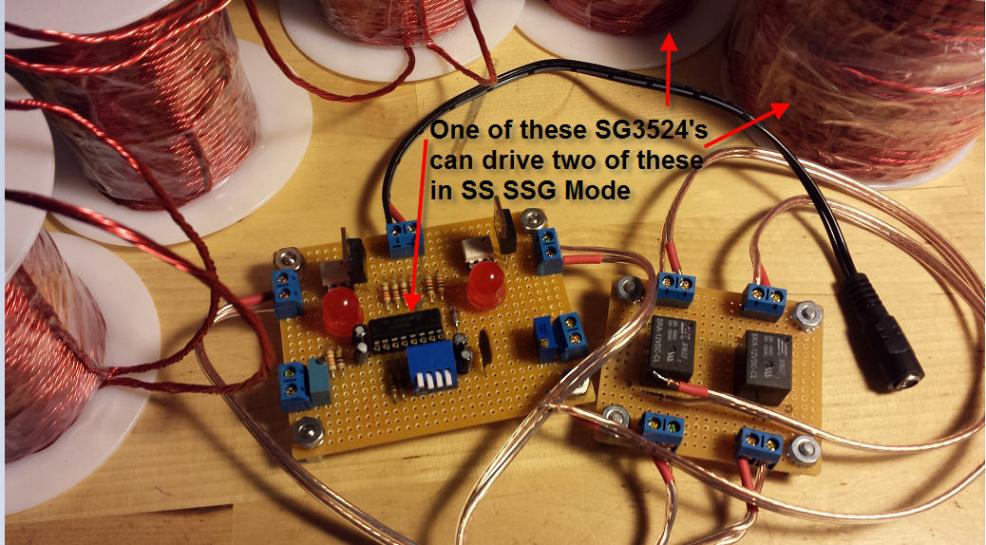

Name:	Sg3524 Relay Switching Setup for SS SSG  or Tesla Switch  or  MEG  or  DC2DC Converter or SGBHBp.jpg

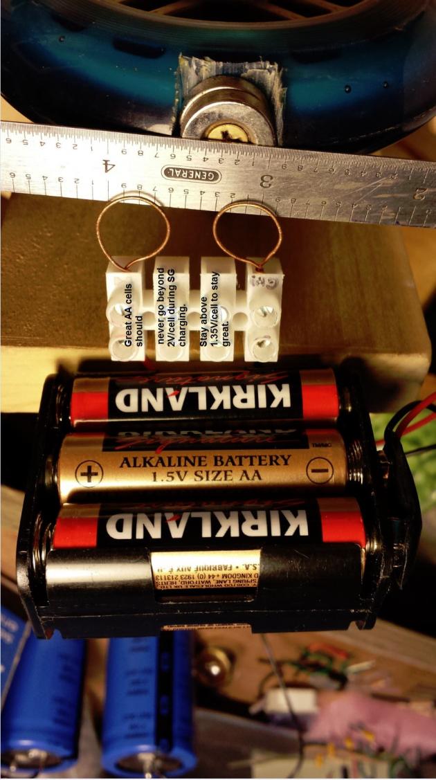

Name:	EverLasting Alkaline Solution NEVER Go Less 1.35V Else Gas Bouncy Alkali-Poppers.jpg

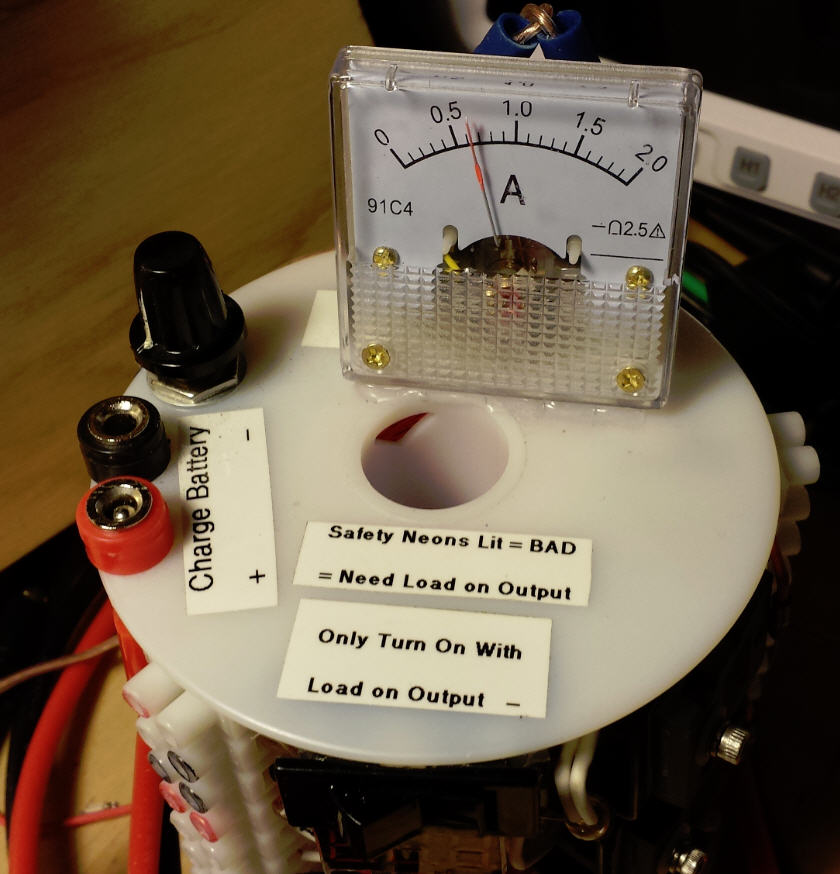

Name:	Neo-Rotored Ganged w SS SSG wCPD Mod Charping Li-Poly Zagi HP Battery.jpg

        For small 5 to 7Ah batteries, I found it needed smaller Capacitors than 15,000uF at times, else charging takes too long, and dumping, while incoming pulses wasted. So I found selectable 741 input Cap's on 741 Op-Amp allowed easier adaptation to various sized batteries dump-frequency, making the dump take longer or shorter time "On-the-fly" really helps. Dump Speed Cap selection I also change depending on how many SS SSG's I gang together, all charging the same battery as a single rotored Beginner's Handbook SG. I switch between dump-speed Cap's of 4.7, 10, 33, 47, and 100uF slowest.
        I switched between 26" wheel with C8's and Neo Scooter wheel until more coils makes it practical. edit***

        Sticking On means harming your Electrolytic cap's and you will hear them cracking inside with dielectric discharge to the plates. Soon they will bulge and turn resistive and start leaking and sapping your performance. So please use only the 741 Op-Amp Cap Dump. I want to modify this to turn on opto upon High threshold voltage Vs. Low Threshold voltage .

        ***(The timing required for Tesla Switch at JB's IceHouse.net site is same SG3524 PWM as shown in SG Beginners Handbook page 109, Figure 2, to be used with Figure 1 'full-cap-dump'.
        (now you can eBay SG3525 PWM's for $2.27US, and you will never want to bother with any 555 or 556 timer ever again I promise. This PWM stomps all over 555 w. 555 PWM using second 555)
