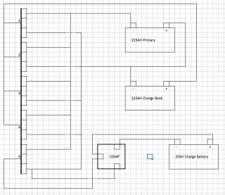

    I have a reworked r-charge 10 coiler that is able to charge up a 215AH bank from a 215AH bank. I got the large comparator made by JB and have been told that the output of the machine would likely burn up the comparator. So I've tried running the output from one coil only through the comparator, but wonder if any of you have done that?
    Those who have used the comparator know that there's a post for the output from the collector diode and the positive of the charge battery to attach to. That is clear enough. There are two other posts. One for the negative of the charge battery, clear enough. The third is to connect to the common connection between primary positive and charge negative on the energizer. The interesting thing for me is that the energizer is running off a 215AH bank and charging another one. So that common connection on the energizer is between those two banks. I have no place where the 25AH battery being charged by the comparator connects to primary. So currently I have that post on the comparator connected to the common buss on the board for that coil. The 25AH batter is not fully charging and I'm pretty sure that's because of how I have it hooked up.

    Here's a crude drawing of what I have currently with coils labeled 1 through 5 and assume the other 5 are like 1 through 4. Coil 5 outputs to the comparator. I'm pretty sure this is wrong. Any ideas are welcome.
    thanks

      Hi Howard,
      When I had a friend's r-charge 10-coiler I had no issues running the large comparator on all 10 coils. These were 10 coils of #18, pulling about 5A @12V. In fact the results were very good. The only thing I had to do was run a fan attached to the heat-sink as the FETs would warm up.
      I couldn't quite make out your diagram, but I think you have it hooked up right. Just to recap - the charge positive from the 10-coiler and the charge battery positive go to the same post. The charge negative from the 10-coiler (which is also primary positive) goes to the negative input of the comparator and the negative output of the comparator goes to charge battery negative.
      Remember, the function of the comparator is to charge the caps from the output of the 10-coiler and then dump the caps to the charge battery via the negative - so the FETs are switching the negative of the caps to charge battery negative.
      Hope his helps.

          Well all, I just hooked up the 10 coiler to the big comparator. All collectors are feeding to a common buss that goes to the comparator and, at the comparator, is attached to a wire that goes to the charge positive. The primary negative goes to the ground buss on the energizer and the primary positive goes to the buss that used to be primary positive/charge negative. Instead there is a wire leading from this buss to the negative input of the comparator and the negative output goes to charge negative. so the only commonality between primary pos and charge negative is through the comparator. This is how the diagram looks, if I'm interpreting it correctly.
          As soon as I turned it on I noticed that there was no pulse, just a solid green light from the comparator. I tried turning the pot on it counterclockwise and still no pulse. Then i noticed the smell of something and looked around and saw the neons lit up like christmas trees. I took a quick amp reading and saw a 1.8A draw and shut off the machine. My usual draw was around 4A. Also in that thirty to 45 seconds I was running the machine there was only 0.01 v increase in the charge battery, much slower than usual. Just as I was shutting off the switch I looked at the LED on the comparator and it was off. It may have burned out and that was the source of the smell. No high temps on the comparator that I could find.
          I've checked all my connections and all seems right. 0.1ohm or less resistances.
          Any thoughts are welcome. I'm afraid to try again for fear of burning out the comparator if I already haven't done it.
          h
            Howard,
            Can you post a drawing of how you have it all hooked up?
            I'm not sure I understood from your post how you've done it.
