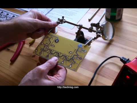

    This is the kit assembly by Peter Lindemann, but even if you don't have a kit, this will address many issues that you will encounter even if you make a homemade one.
    Here is the video - How to Build a Bedini SG Energizer - YouTube

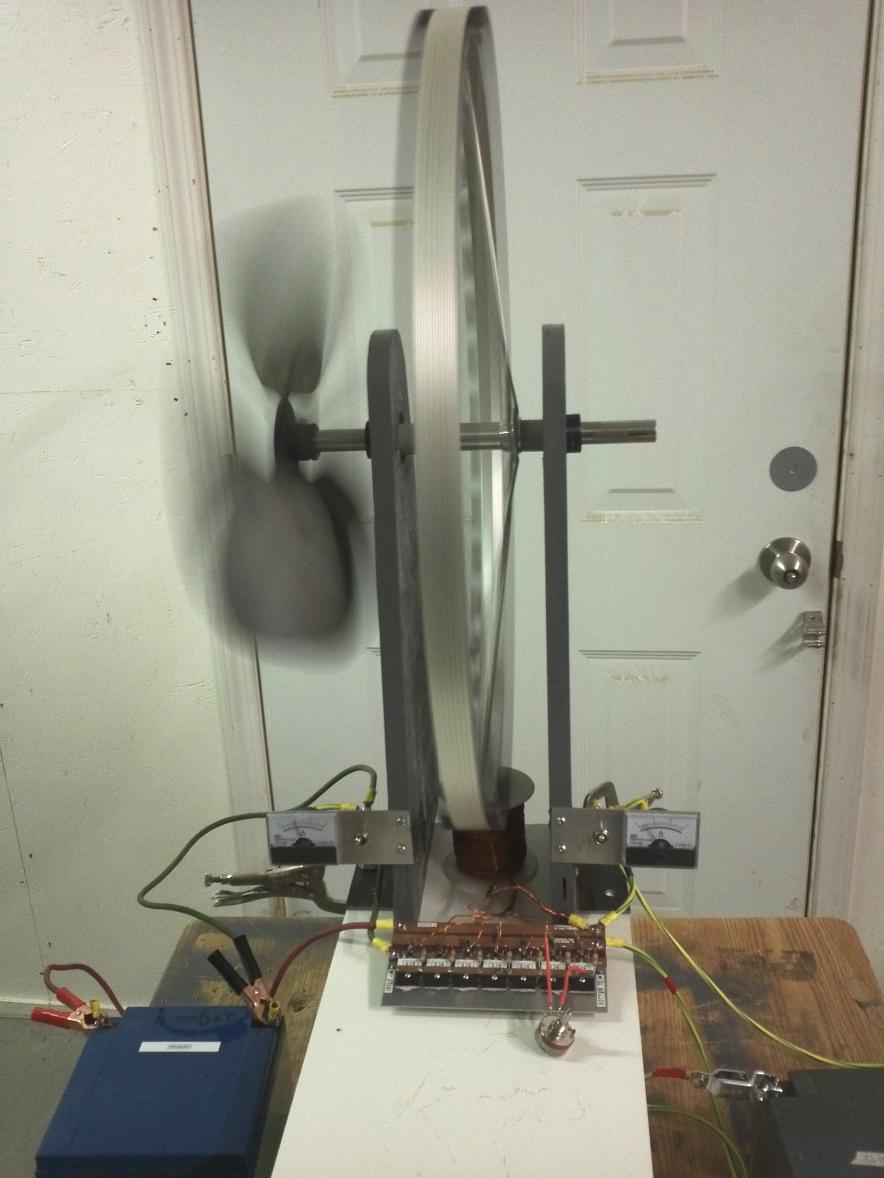

                  I just did a test on the SG that we just filmed - it's going 250 rpm with the fan. I haven't done any real measurements yet, but it pushed the output battery to 15.67, which is a bit much. 15.2 to 15.3 is about the max I should push the batt to.

                      Here's a new video of a short test just showing the Bedini SG Energizer running.
                      Bedini SG - pushing output battery to 15.67v - YouTube

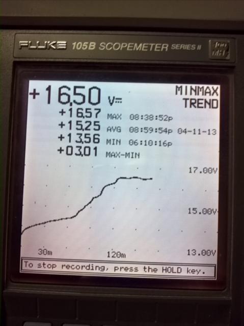

                          If I can push a 26ah sla battery that high, does that tell you mine sg energizer is in top performance?
                          If you take a close look at the gragh, you will notice that it was on that battery too long, because the voltage
                          is droping, I think it's a great experience gragh to see wath is happening inside the battery.
