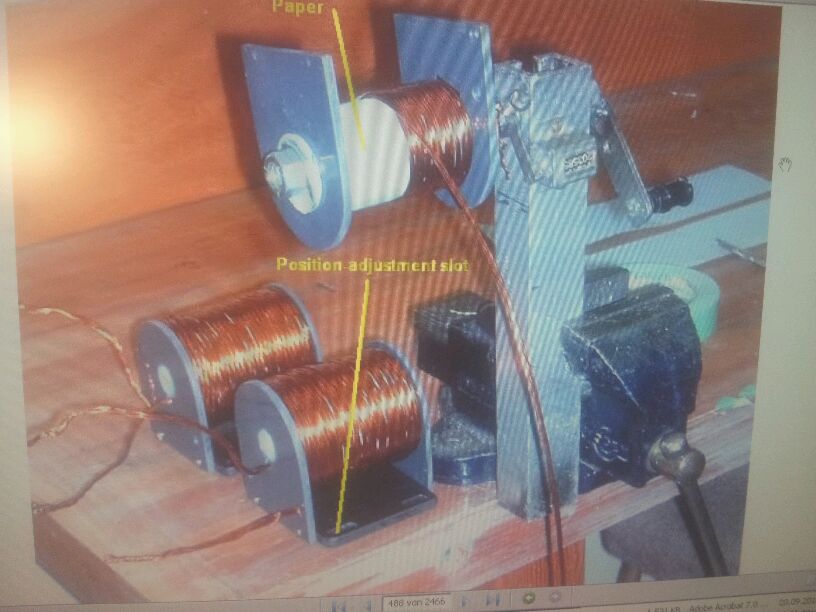

            actually i have the coilwounddirection from http://www.free-energy-devices.com/PJKbook.pdf chapter 6 from Ron Pugh from Canada there you can see a foto where he is winding the coils and achieved a COP of 12 and these are wound clockwise.

                Hi everybody,

                  Hi onesmore,
                  here is a picture Click image for larger version
Name:	Ron Pugh coilwounddirection.jpg
                  i have made it like this.I'm only confused because John made it in the Beginners Handbook in the other direction.

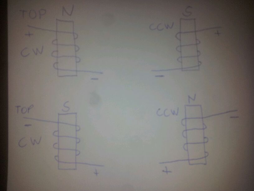

                      Hello to all,
                      i have attached a picture and my question is,is there a difference between first coil in the picture and the last coil?Is there a difference in the COP when the coil is wound CW or CCW since i have a northpol when the coil is powered?Click image for larger version

                        Hello to all,
                        i have attached a picture and my question is,is there a difference between first coil in the picture and the last coil?Is there a difference in the COP when the coil is wound CW or CCW since i have a northpol when the coil is powered?[ATTACH=CONFIG]1192[/ATTACH]
                        Wind it like the top right one - that is what is shown in the book - that is NOT a mistake. With the positive on the wire coming out from the left side of the coil, you will get South at the top.
                        It will make everyone wonder what is going on since it has always been the opposite, but there is a reason that will be clarified in the updated book that should be released by the end of the week.
                        It also needs to be pointed out that it is irrelevant whether any of the leads are at the top or the bottom, the only relevance is where you put the positive. On the wire coming from behind the coil and to the right? That will make N at the top of the coil. Or, on the wire coming from behind the coil to the left, that will be S at the top of the coil.
                        They are inverse of each other in the way the machine runs and both work.
                        The N at top is the standard way and the S at the top will let the machine run different - again - clarification will be in the updated version at the end of the week as to what this is all about.

                            A last question about the coilwounddirection(cant believe that nobody has seen this the hole years):
                            I have wound them cw so i have only to change the wires,but does it make a difference if the electronflow is from the outher side (-)to the core(+,like the left bottom picture) instead like JB makes the coil ccw = electronflow from the core to (-) to the outherside(+),both make a southpole,I guess nobody has tried this,exept JB,i think.
                            Second methode would be to simply turn the coil then you have it ccw,but in many cases the inner wires come out in front of the magnets which would be no problem if the gap is not to near.
