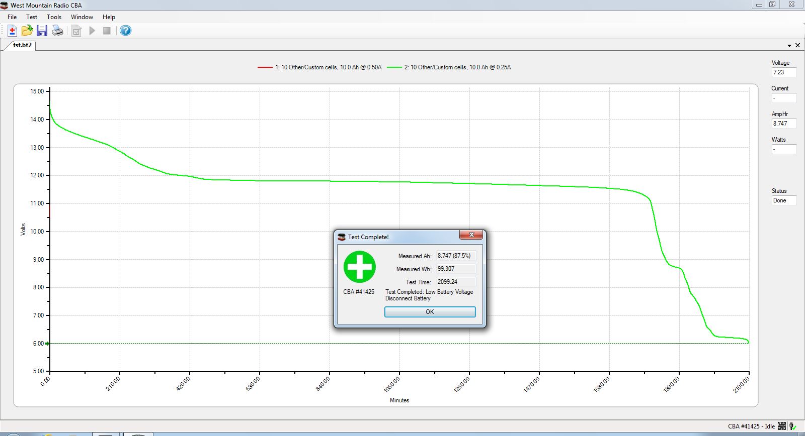

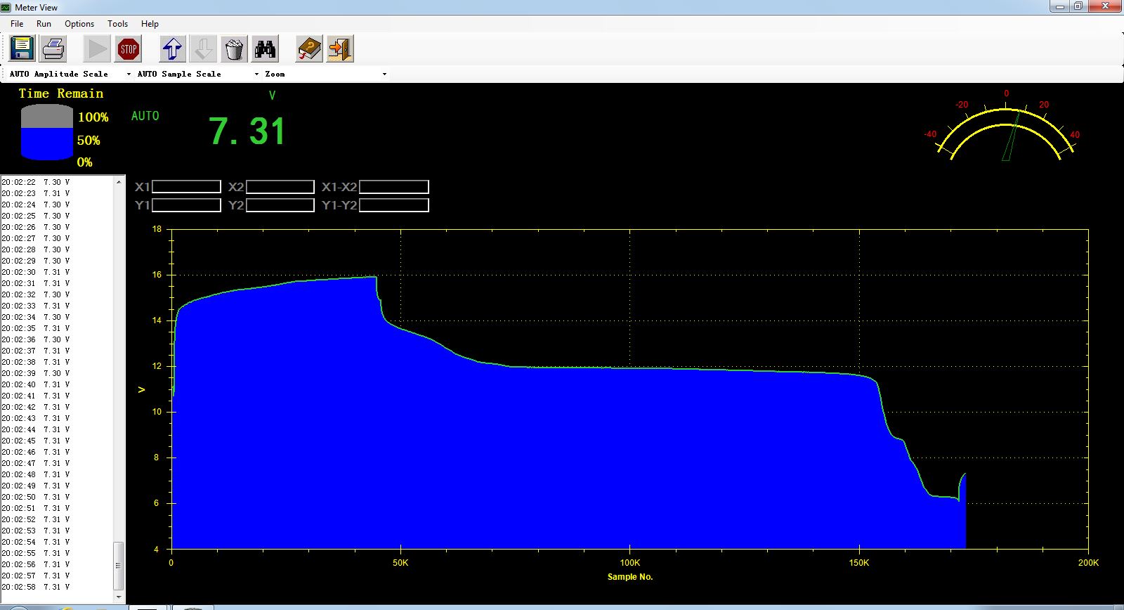

The attachment doesn't seem to work
). Well, aside from causing the electrolyte to go below the lower level marker on a couple of cells, there was no appreciable increase in output capacity.
