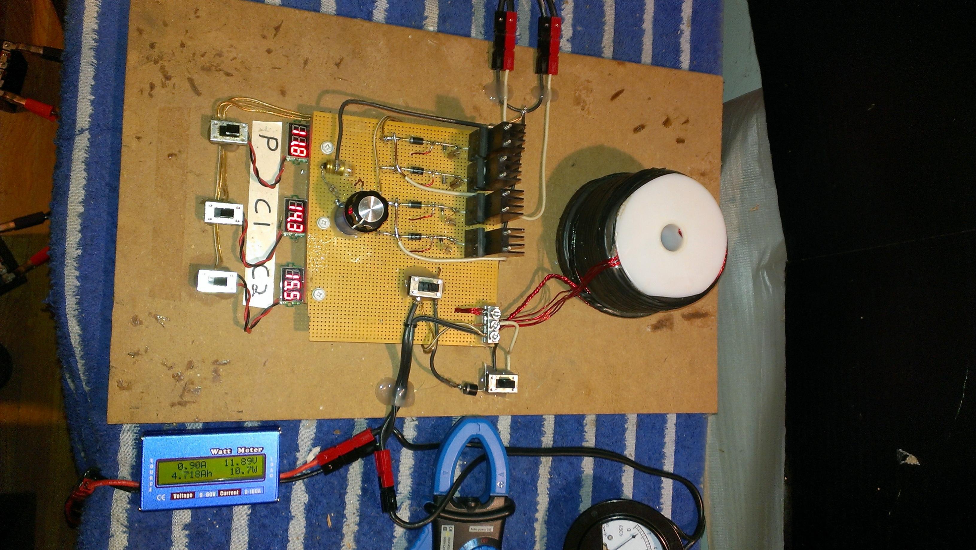

          Anyone remember this old setup?
          I have not run this SS in a few years. I got it out and re-did some of the wiring. It's running in branch output.
          In the picture if you look close you can notice the LTO batteries on the floor there. I want to do a post on these two starting from the same charge state but in this charge one was already way ahead when they started. I went back today and watched Mr. Bedini's videos in the SH Oscillator thread and this machine was what I had built back then trying to replicate his branch circuit. Damm I miss him and I didn't even know him.

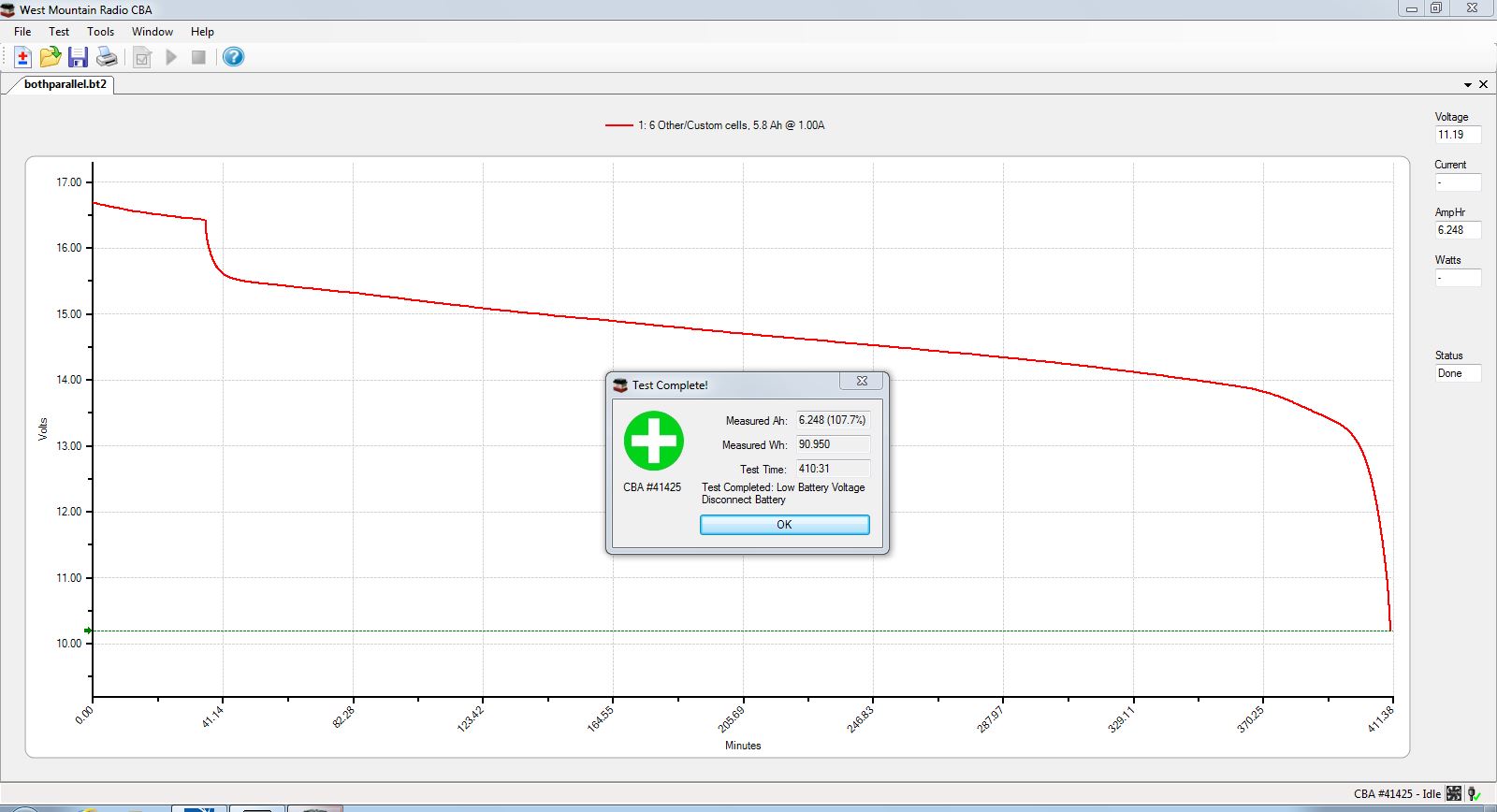

            Hello group,
            I did a charge run on the machine from the last post in branch mode. It did very well but I am not posting the chart because I had to stop charging several times and then come back and turn it back on. These batteries are so small that I could not leave it running while away for fear of over charging so it was not a clean run. I will try to do another one and capture it for you to see all in one shot though.
            I can post the discharge from that run however. What we see here are both batteries connected in parallel to double the capacity. They were charged up to about 16.7v which is basically a full charge for a six series (2.8v per cell). These are supposed to be 2.9AH cells so I actually got more out than the rating. The discharge was done at 1A.
            I don't like posting this without a charge run to go with it but at least you can see the curve on these things.

              I have noticed after doing a few more runs that without bringing these cells up to a full charge you do not get a good capacity discharge back out. What I mean is if I charge to say 15v on one pack I will only get about 1.5AH back out but if I run up to 16.8 I will get 3AH or more out. The last little bit on the charge makes a huge difference. My original thought was to run these sort of in the middle of their range but now I am not so sure on that.
              I think I will remove a single cell from the packs so that a FULL charge takes it to about 14v instead of 16.8. This way I can still hook it up to an inverter but get a full discharge from it. The trouble as-is was that the inverter will not accept 16.8v, in fact anything past around 15v will not work on most of my inverters. It would work fine as a 6S if I was not using an inverter or if I don't mind the shortened run time but these things are so small to start with that I think it's better to at least get the 3AH back out of them.
