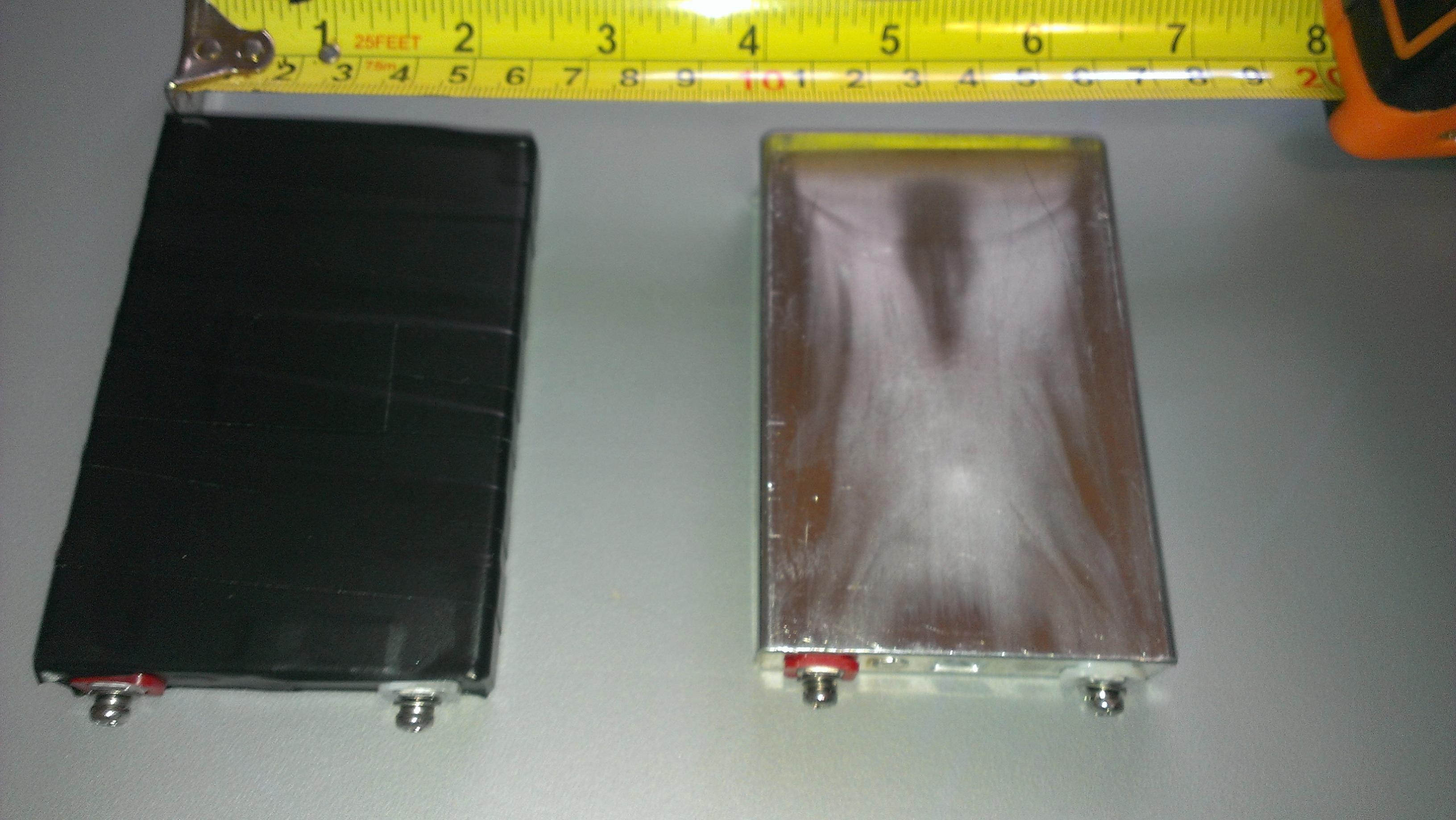

                    I finally got my hands on some LTO cells and thought I would report back to the group my observations with them.
                    I have the Toshiba 2.9AH cells featured on the page linked below. I got the small ones so that I could test out different things before deciding if it would be worth buying larger. These things are expensive but when you consider the lab testing shows that after 40,000 cycles they still store 80% of their rated capacity perhaps it is more economical than any other cell. That roughly works out that you could charge and discharge these things twice a day for 50 years! Now if that holds up to be true or not, who knows but that is how they are rated.
                    Here is the manufacture page for my cells:
                    http://www.scib.jp/en/product/cell.htm
                    The cells come with no insulation and when checked with a continuity check it shows that the case as positive, you might call it a positive ground. The first thing I needed to do was wrap all of the cells with electrical tape. Below is a picture of a bare one and a wrapped one together.

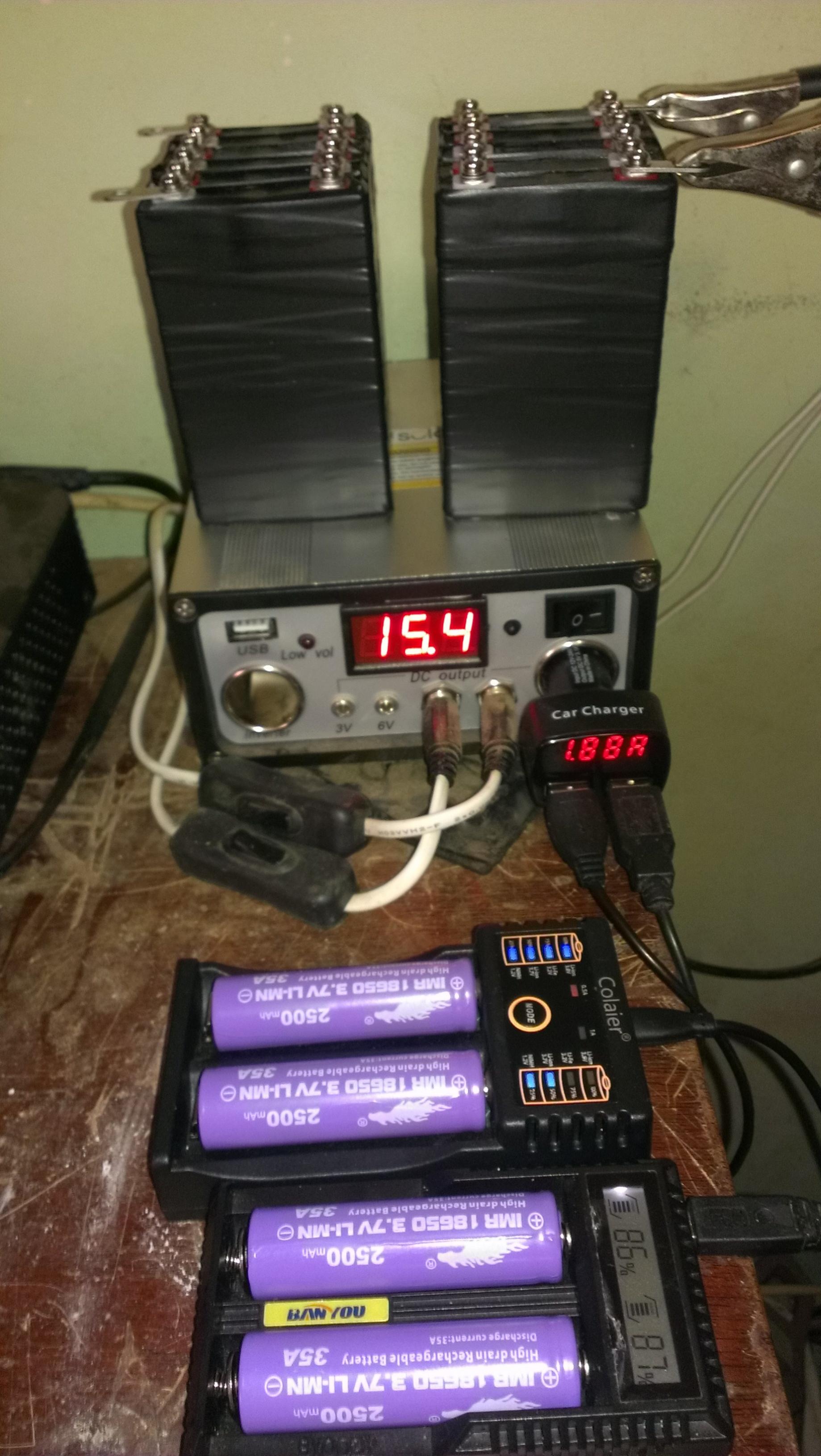

                    I built two packs with six cells each to make a 12v equivalent type of battery, meaning something that could be used to run loads that you normally would put a 12v on. The nominal voltage for these cells is 2.4v and the swing voltage is 2.8vFull down to 1.9vLow. I could have used five cells instead but by using six I am intentionally staying away from the upper charge and the lower limit for the cells and basically operating in the middle nominal range which should make them last even longer.
                    I have been charging them up to 15.5v and using them on a harbor freight solar controller, not using the solar part but using the box as a load controller. I have a 12v plug to USB inverter that I plug two 18650 battery chargers into and charge 18650 cells. I also charge my phone and other USB battery boxes the same way. Now this is where these batteries shine in a way. They have no problem providing serious current. When I have tried the same loads on a garden battery in the past it usually can only run a short time before the voltage sags below the load controllers cut off (10.5v) even though there is still a lot of energy in the battery it cannot handle the 3+ amps I pull. These LTO cells have no problem at all and that is a huge advantage. They are also quite small and light which is nice.
                    As I said these are only for testing and the capacity is quite small but I do get a lot of charging from them anyway. I can only imagine how nice the larger 20AH cells would work. Here is a picture of the charge station I described with the USB chargers hooked up. You will notice the current is shown on the little socket inverter and the pack voltage on the load box. The 18650's being charged were almost there so the current is not as high as it would be at the beginning but even so you can see that under almost a 2A load the battery is still over 15v, those of you who work with batteries often will understand how that is different from a LA battery.

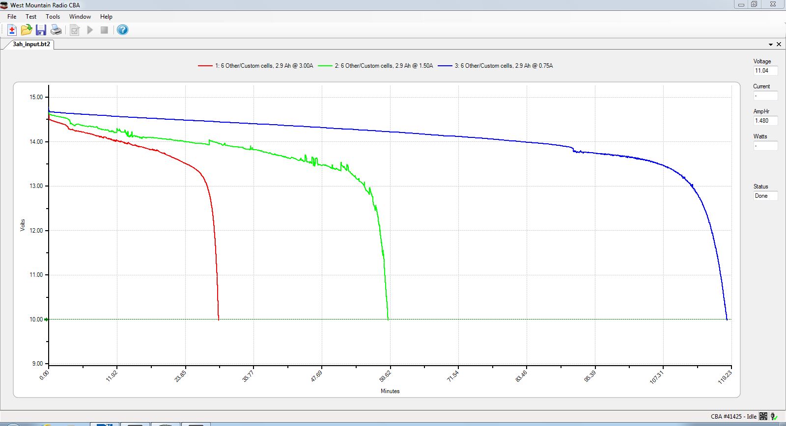

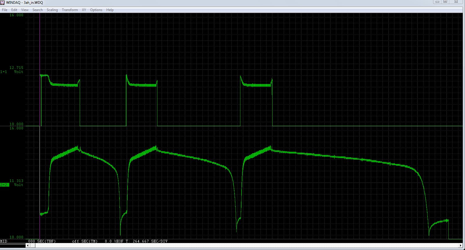

                        Today I am back with some test results. What I have done is run my big machine in generator mode at a high input (around 7.5A) to charge the cells pretty quickly. So that we could have some sort of equality in gauging the results I did three runs each consuming 3AH into the machine. I did a discharge of 3A, 1.5A, and .75A so that we could have a look at the performance of these cells under various loads. I did say in the video a few times that this is not meant to be about looking at the charging efficiency of what I was doing. I ran this way simply to throw a large current at the batteries but I say it so that people not familiar with the machine will not misunderstand what I am trying to show here. I think I could do much better in fact if I did tune the machine to a more reasonable level but that may be for a later post.
                        What I find very interesting about these runs was that I used the same amount of power to charge each time so we sort of know the battery pretty much was brought to the same level but on the discharge we got pretty much the same AH out at each rate, only the time varies because of the load current. My experience with regular batteries would tell me not to expect nearly the same output energy from a 3A pull to 10v as a .75A pull to 10v. I would expect to get quite a bit more from the lighter load but that is not the case in this test scenario at least.
                        These cells are pretty amazing but I am not familiar with them yet. I do not know the best way to charge them or how to tune a machine for best performance on them, they are far different from LA in how they behave. I have no doubt that they can be fast charged with lots of current though. If they truly have the cycle life they claim then I am very impressed by them.
                        Here are some charts of the run. First the CBA showing the three discharges:

                        And this was a chart running on a different meter showing both the charge and discharge. The primary was unhooked during the discharge cycles so that is why it goes flat on the chart.

                          Hi Bob, looks interesting. I know absolutely zero about this type of battery but from the charts it looks like they are undercharged. I would've expected more than ~1.5Ah out of a new 2.9Ah battery.
                          I'm not sure if pulse charging them is a good idea either. For example, I am working with 18650 Li-ion cells which have a specific CC/CV charging algorithm. At the moment I am charging them conventionally and logging some charge curves, just so I can get a baseline. Next step is to use them in a 3 battery switch to see how they perform (or not) there. I'm not planning at all to either radiant or capacitive discharge methods on them. Not suggesting you should do the same, but worth thinking about.
                            John I said in the video but you may have missed it, they are not fully charged. These cells go to 2.8v per cell full so 16.8 would have been full, we were at about 14.6 in those runs. Now with that understanding think of what it says about performance. Even half charged those things put out 3A continuous. When I am using them for actual loads I charge them to about 15.25V which also is not full but I get a lot more out of them. I cannot go higher because the inverter will not take the voltage.
                            I am with you on the pulse though. I read an artical somewhere that I need to find again that actually said the LTO cells do better on a pulse but I also know Mr. Bedini said it was not a good idea on other lithium cells so I'm not really sure but you are right to caution against it. I am about to install a 400 watt panel array to replace a few individual 50 watt panels I have so when I free up one of those 50's I am going to try charging these cells from that instead. I have a little buck converter that I can dial in to say 16v and hook to them.

                              Wow, those cells have some pretty awesome power density. They do "fall off the cliff" pretty quickly at around 13v though. I think they will do great on solar. If you have a charge controller/inverter where you can program the min/max charge and discharge voltages you should be set.
