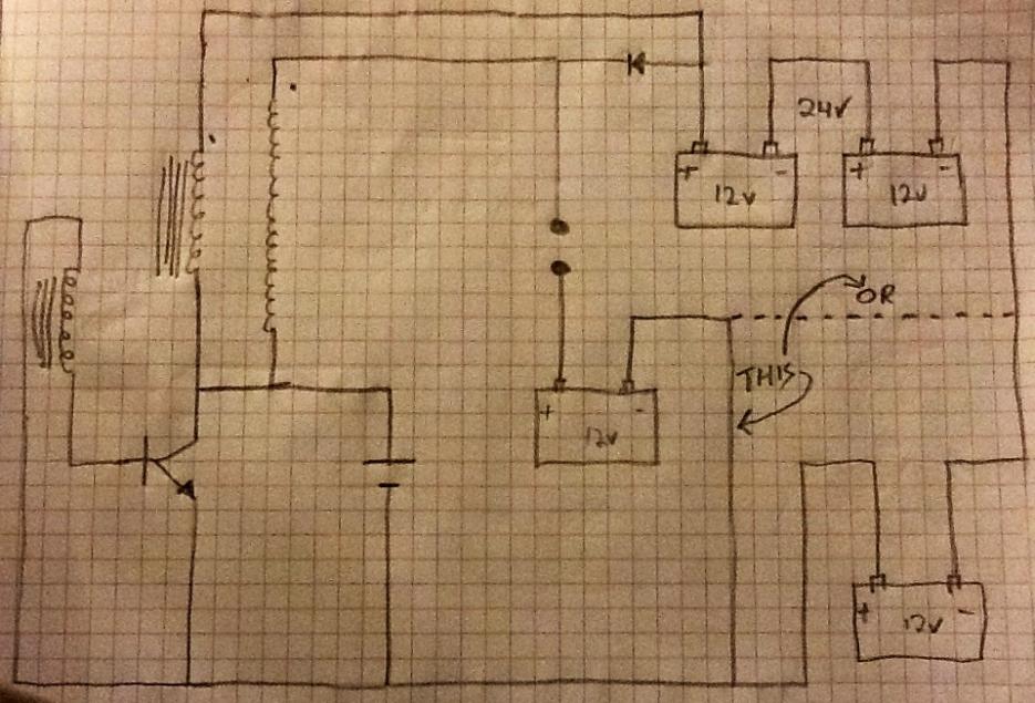

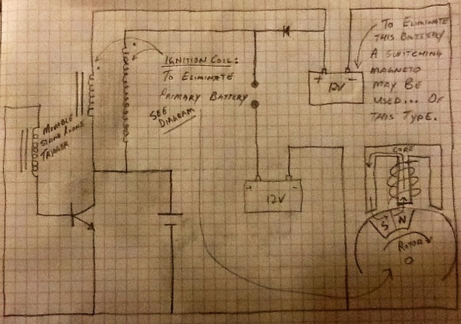

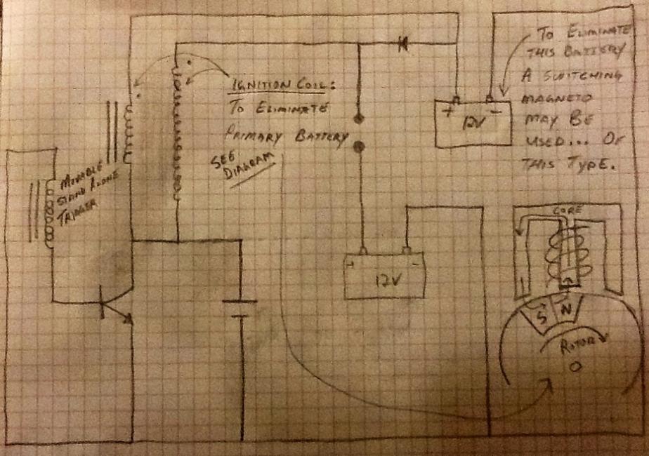

                      Yes I do have ideas...but at this point that is all they are at this time. If you have not purchased Aaron's ignition secrets, along with the Bedini Advanced Book, I recommend you do...
                      Use the circuit found in Aaron's Ignition Secrets to make a magneto generator that jumps a gap that in turn charges a cap and then dumps to a battery. Draw a SG in generator mode and compare it to a battery ignition system as found in the pic below and modify it as found in Ignition Secrets. It should be surprising how close all these things are, one to another.
                      One may be able to directly charge a battery after the spark jumps the gap as well... But I do not know how receptive the battery will be to such a high voltage spike... it may explode or not as I have not tired any of this yet. I also read or heard someone say spark gaps convert electricity into AC. Don't know if this is true though... If it is true then the remedy should be an easy one.
                      One may also be able to remove the primary battery as well and use a magnetic switching coil as found in many Kohler small engines and or modify the laminations of a GM HEI coil to accept the rotor/ magnet arrangement as shown in my hand drawn diagram in the other pic. This should enable the coil to become a good generator that will charge well. The GM Ignition Module could also be used as a switch (instead of a transistor) and it could be triggered inductively as well.

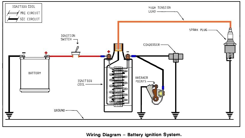

                      Here is some good information, switching speeds, resistance value, duration etc. for the GM system found here...
                      "In a points system, it would take 10 milliseconds for the current to reach maximum with a coil that has 2.6 ohms of resistance. The primary windings of an HEI coil have only 0.5-ohm resistance, allowing maximum current to be reached in approximately 3.4 milliseconds... As an example, an HEI system has the ability to produce 40,000 volts to the spark plug for short periods of time...
                      Attaching some numbers to this, an HEI system can arc a spark plug for 2ms and 20 degrees CA. A points ignition would, at best, only support approximately 1.1 to 1.5ms and 10 to 15 degrees CA..." http://www.hemmings.com/mus/stories/...feature19.html
                      We may even be able to throw the Tesla Switch example in there as well. My second hand drawn diagram incorporates 24 volts on the primary and 12 volts inverted to catch the current coming back, which otherwise would be going back to the primary negatives.
                      Just throwing some ideas around.

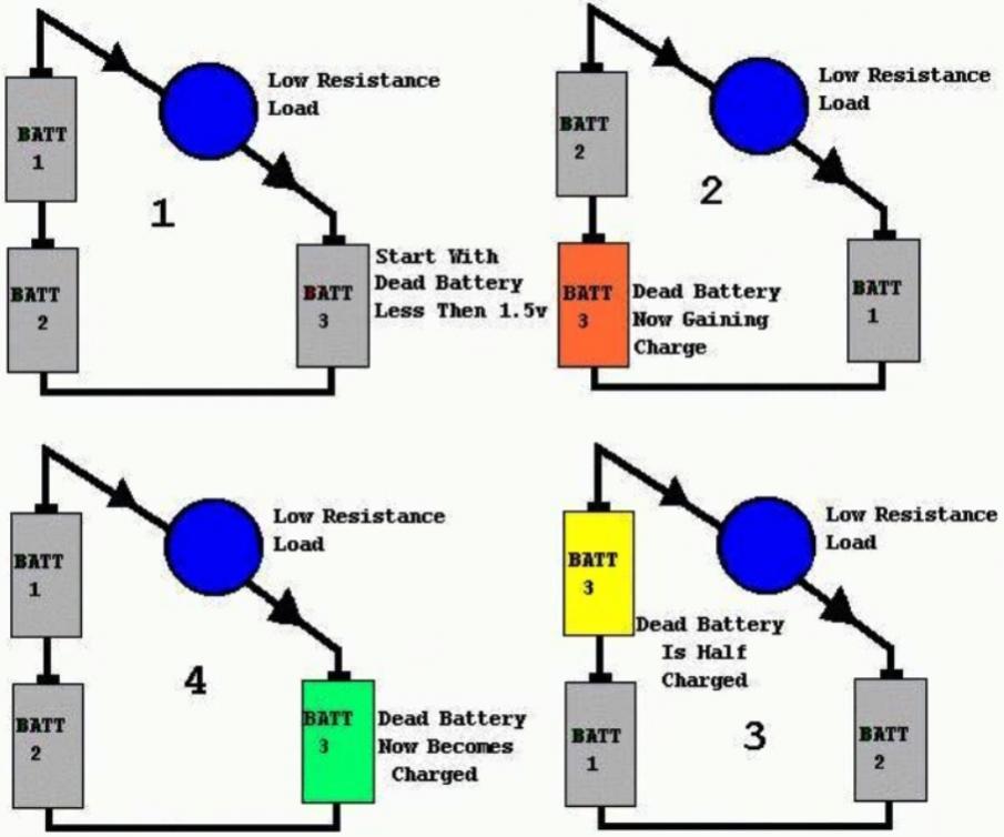

                        As Dave says the 3 batery system is definitely a "must do" thing isn't?
                        My thoughts at this time are:
                        tap extra energy with impulse tech, maybe between power coil/s and cap (in the coil collapse event), and between cap and battery (in the cap dump event).
                          -Dave Wing

                          So you have a battery dropped to the primary of the coil, HV sparks goes over gap to recovery battery and what is your low voltage high current source? Is it that cap below the coil or is it the input battery as the low voltage source to jump the gap after ionized by the spark?
                          Same question for the 3 battery system where you have 12v different at the coil to do the same thing.
                          For the most part it all makes sense - just need clarification on your LV source that is meant to jump the gap.
                          IF you can get a battery to jump a gap as a low voltage source, that is all I really think the Gray motor technologies comes down to in principle. I didn't have strong enough cap discharges to ionize it enough to have a battery discharge and I did try, but could only get caps of maybe 150v minimum to jump.
                              I will get back to you on this... After I review your literature and a video again.
                              Perhaps one could run some batteries in series to boost the potential up a little. Then it may jump the gap with your caps? Although I am not really sure what you are doing here.
