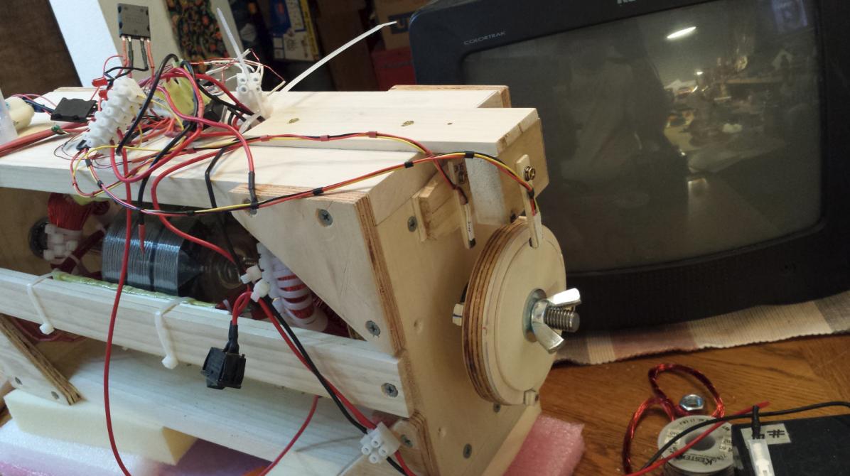

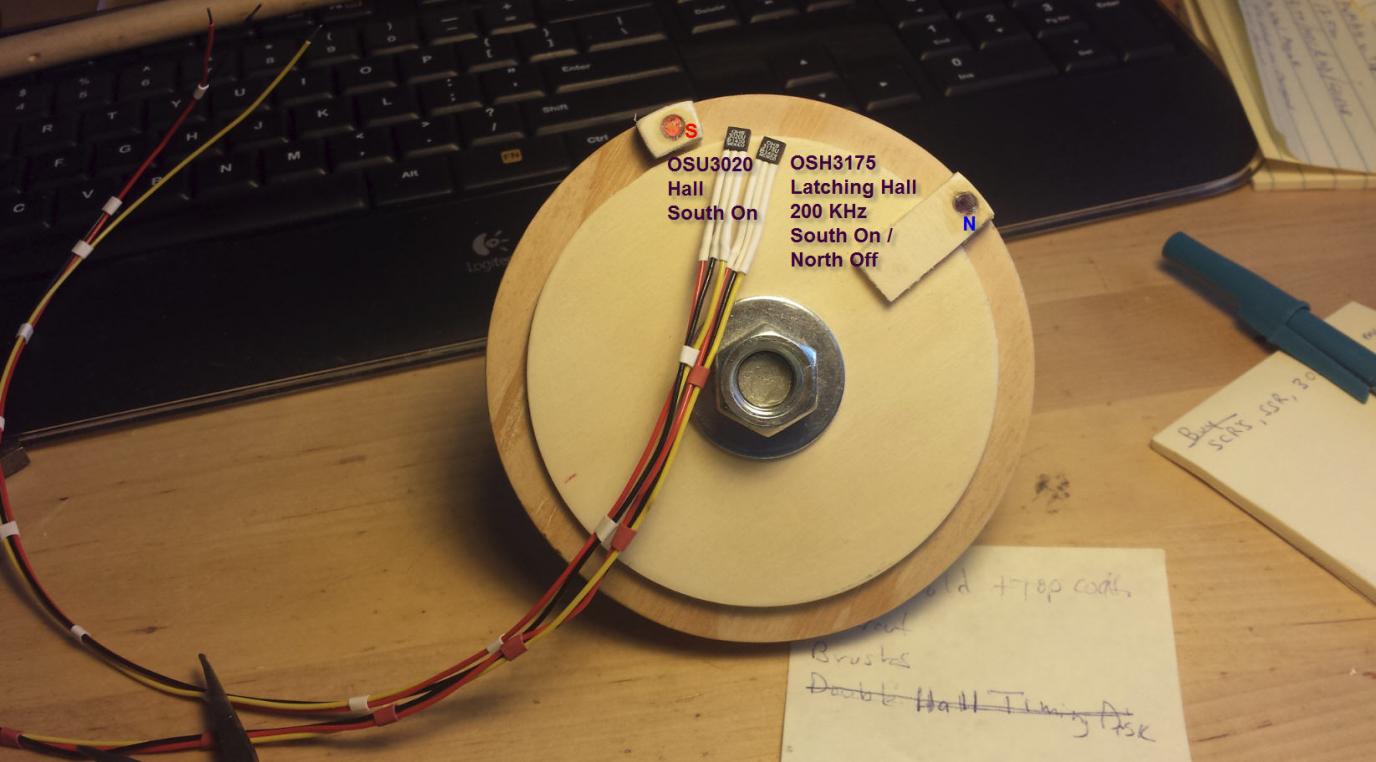

i have been doing a few experiments just now, i have to say MUCH better with hall switching to see what's going on, you can pick a point on the magnet to look, and monitor output on the neon and battery input / output
just tried some coil shorting which i have not been able to do until now, and have seen the sec battery charge with it with just a spin of the wheel by hand. might have to put in a reverse diode see if i can get the current loop.
also have seen energy flowing back in little blips on the scope when the power is turned off, dont really know whats going on there, sometimes its high as half the supply voltage for an instant and then drops down to a volt, you put the wheel in a different place and it changes instantly not sure whats going on there yet.
the coil shorting is interesting shows the forces at work "inside" the coil you can see the current flowing on the needle in reverse, and how different switching positions affect it.

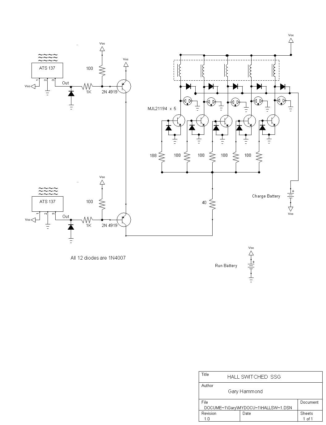

If I can improve the output of the genny coil just a little I think it will power the hall switching circuits and reduce the input current draw by the same amount.
