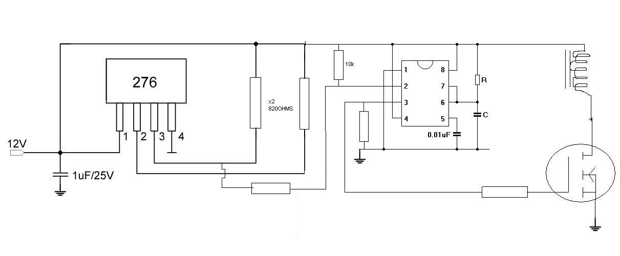

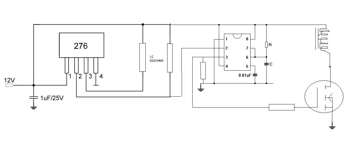

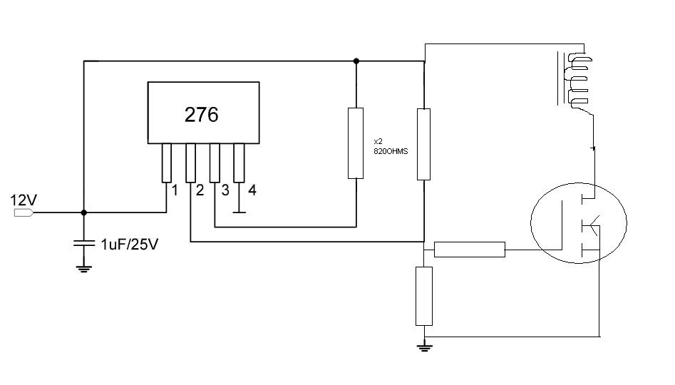

decided to try out hall switching before my next build so i grabbed the junk box and pulled apart some fans and got the hall sensor out and connected them to a mosfet driving an SG bike wheel.
seems to work as i expected, needs an astable, pulse width is quite long, charging seems good but the battery is pretty dry and sulphated.
