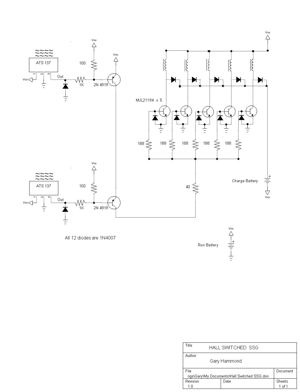

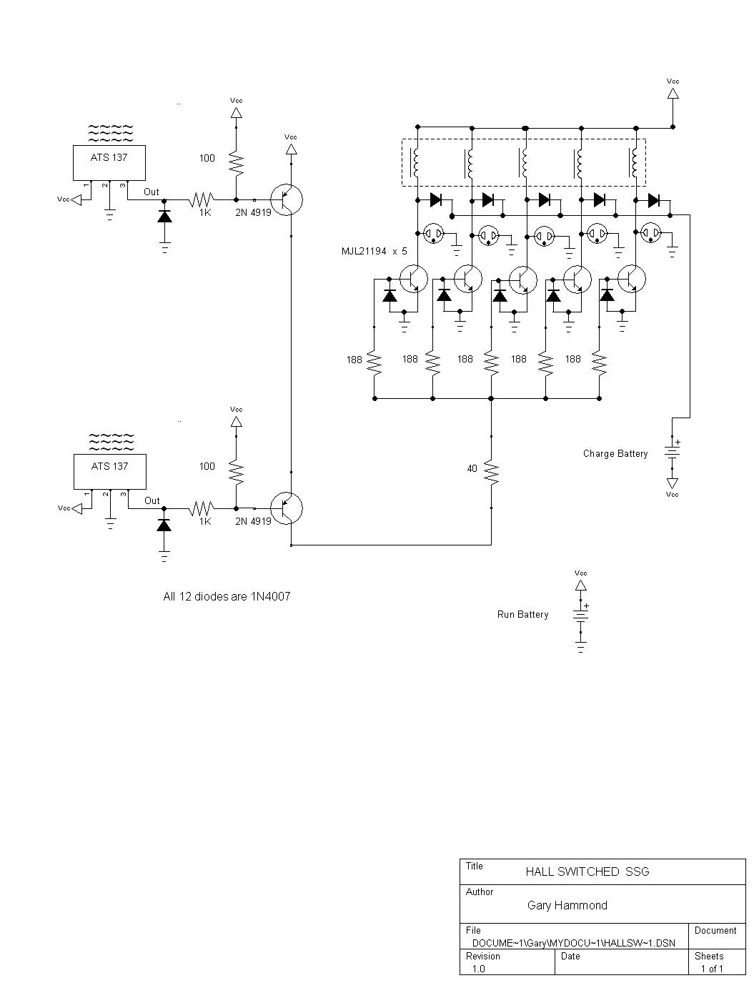

          Back from vacation now, so here's the schematic of my circuit using two hall switches on two small PNP tranistors to trigger the five MJL21194's. The hall's are mounted separately for adjustability, but both are triggered from the south pole of the same magnet whose north pole is approaching the coil assembly at that same time.
Name:	Hall Switched SSG.JPG
          Last edited by Gary Hammond; 09-05-2014, 12:54 PM. Reason: added a more correct drawing showing neons

              Thank you Gary, I would like to try triggering my sg with a hall, just to see the difference.
              Hi Brain,
              [ATTACH=CONFIG]3738[/ATTACH]

                    Gary
                    Can I ask, why two hall sensors? What is the benefit vs. one? Also if it is possible to just eliminate that top hall? Curious I guess, I hadn't ever seen two used like that.
                    • #25
                      the two hall sensors are configured so you can adjust the pulse width otherwise pulse with will be determined by the magnet length, which will waste alot of current.
                      i will put up the schematic i used with a 555 for the pulse width, it can easily be altered for driving transistors, either will work just fine, mine uses the hall sensors found in brush-less fans, pretty easy to get hold of.

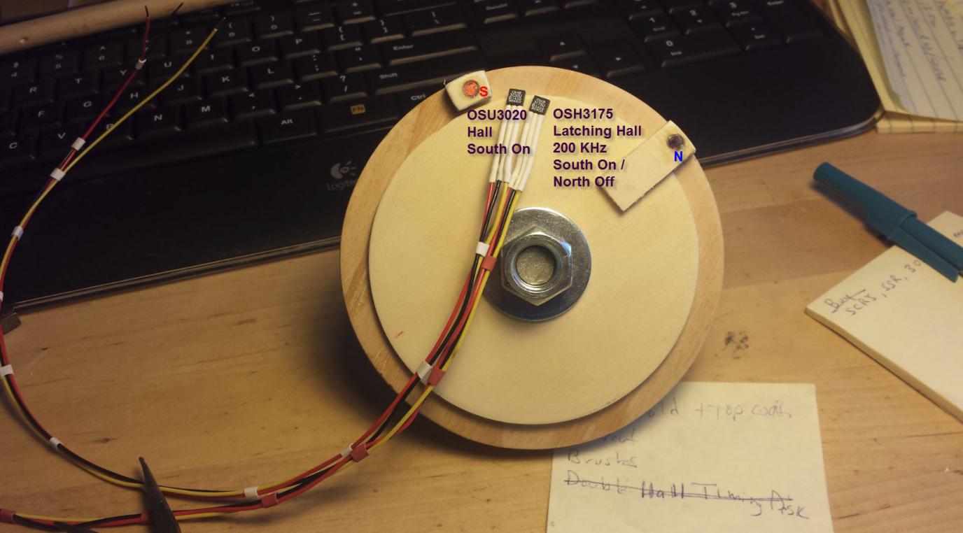

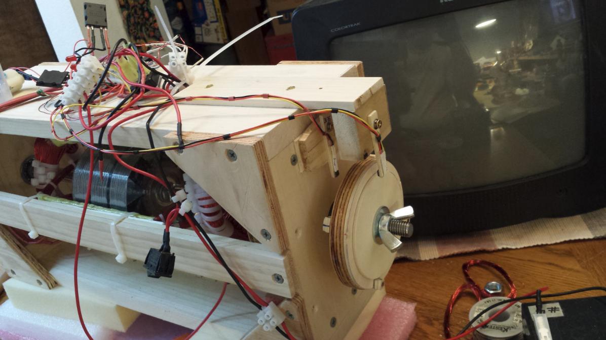

                              • #30
                                Hi Gary,
                                Instead of shorter Hall On-time with two in series, this way or a slanted bar magnet can make longer On-times using 3175 Latching Halls. For SG, most find the bike shaft is not meant to rotate, but magnets on the covered spokes one side allows placing small magnets at almost any radius. The second side of this one was to be for FWBR + to Battery, but that i will mechanically commutate
