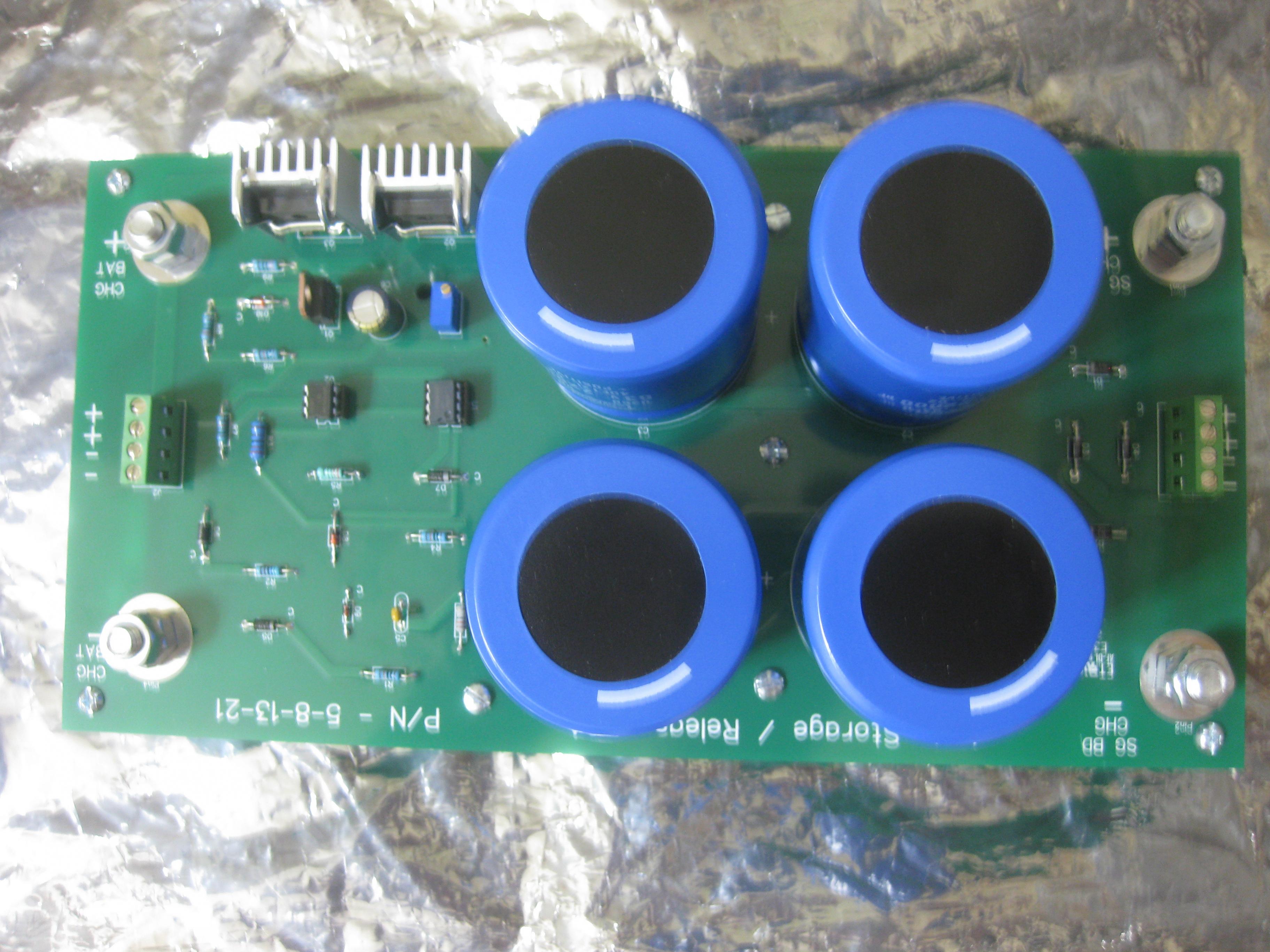

Hi Gabriel --Originally posted by gabiX87 View PostHi everyone,
currently sourcing the parts for the 12V comparator circuit which RS_ posted (KRL RS revB, 08/12/14). I have a couple of questions guys. I have no formal electro background , just a self learner.
There are a lot of information in specs sheets which I cant interpret , need some help.
1. I have all the resistors but I have problem to find D3 1N5242 12V Zener .... can I use 12V/1,3W = BZX85C12; 1N4742A ?
2. Also none of the supplier have exactly LM741 ,they do have with different specs. Will these do ? LM741CH/NOPB (1MHz; 3÷18VDC; TO99) or LM741H (1MHz; 10÷44VDC) or UA741 CN = LM741 CN (DIP8) (1 MHz ,Supply Voltage Min 5 V , Supply Voltage Max 40 V )
3. Also there are variations of IRFP260 MOSFET ... I suspect the higher the A rating the better for cap dump. I have some 3x or 4x IRFP260MPBF (HEXFET; 200V; 50A; 300W) Will these do ?
or I can order these AUIRFP2602 Transistor: N-MOSFET; unipolar; 24V; 380A; 380W; TO247AD
4. The capacitors should all be electrolytic ? Do all caps have to have the same Voltage rating ?
Thanks for help
Gabriel
For the 12 Volt Zener use the same part number with a "B" added on the end. 1N5242B.
For the 741 I used the better rated one which has a 44 volt swing. Which means the max
+/- voltage is 22 volts.
For the FET's it really depends on how much current you capacitors are going to store before
you let them dump. I used a part that was rated at 200 volts @ 130 Amps. The IRFP260MPBF
will be fine if your capacitor total is not to big.
It is best if all the capacitors are rated at the same voltage. I used four totaling 88,000 ufd.
The voltage rating was 63 volts. See my completed board assembly running on AC house
current. It also works off the back of the SG Machine.
James McDonald
