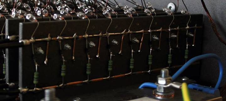

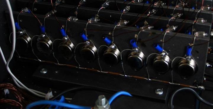

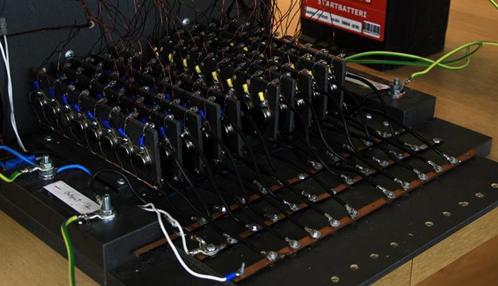

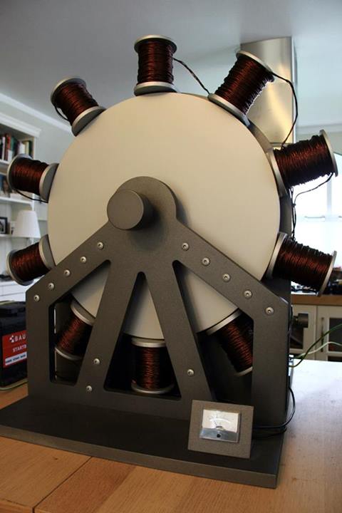

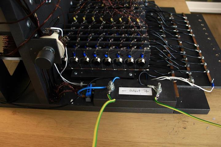

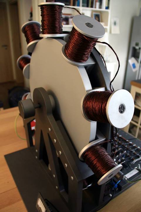

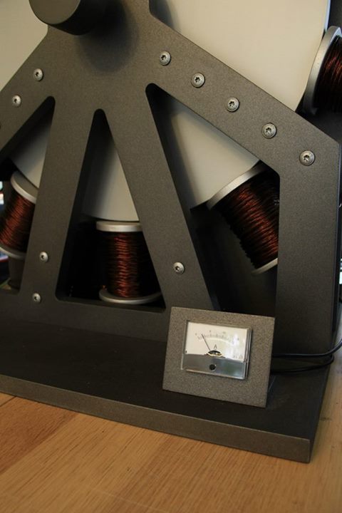

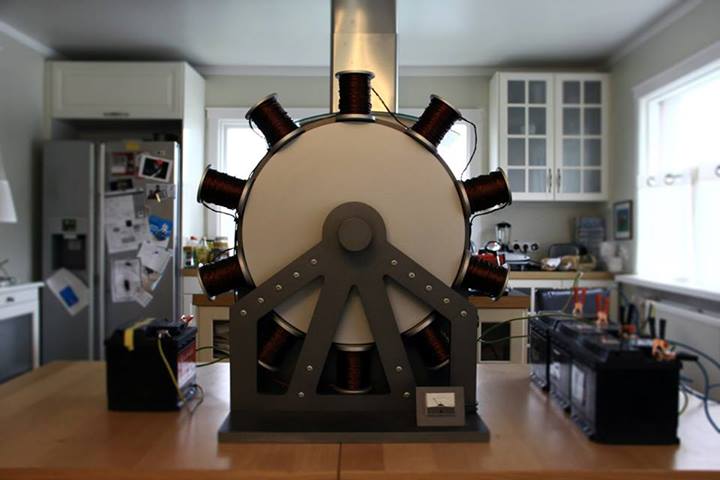

    I have just finished making my 10 coiler Energizer,made of MDF.
    Magnus

    I am just beginning to experiment with it,it seems to work very well but I haven“t mesured it in any way. It runs at about 720 rpm at 12 volts and it runs at about 1100 rpm at 24 volts.
    Magnus

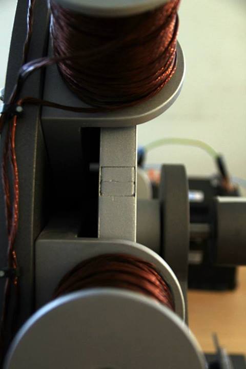

            I used 20 awg and 23 awg for the trigger,the magnets are 22 x 9,5 x 47 mm
              Very nice looking machine Magnus,
              I hope to finish one too next month, just one suggestion, I seems like there is no extra security around the magnets.
              It is not a nice experience if the magnets fly off I can tell from experience.

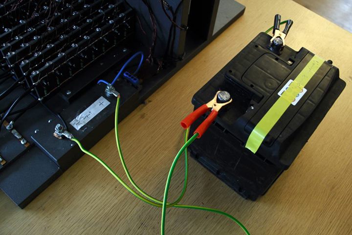

              Would love to see some results of the charging, What kind of batteries do you charge?

                  I'm keen to know about the Magnets Orientation...is that the N-N Squeeze Narrow Beam version..????
                  How much did all this cost you..?
                    Hi Faraday88
                    Yes, the magnets are two north poles pressed together.
                    The cost is about 1800 USD.
                    I could not get the components here in Iceland , so I had to order them from Denmark and England,and that is very expensive.
                    Magnus
                      Hi Karel
                      I am experimenting with 44 ah start-batteries.

                        The transistors do not match, I am a carpender so building things out of wood is my thing,I am just a beginner in the technical matters of the Bedini energizers.
                        I got all the information i needed to build the machine in "Bedini SG The complete beginners handbook" it is the machine in the book ,multiplied by 10.
                        My next step is to get my self an oscilloscope and study it further.
                        I have a 60 watts potensiometer and the base resistors are 47 ohms.
                        Magnus
                          magnus,
                          did you put swicth on each coil?how many amp it takes from primary when all coil is up?
                          Alfin
