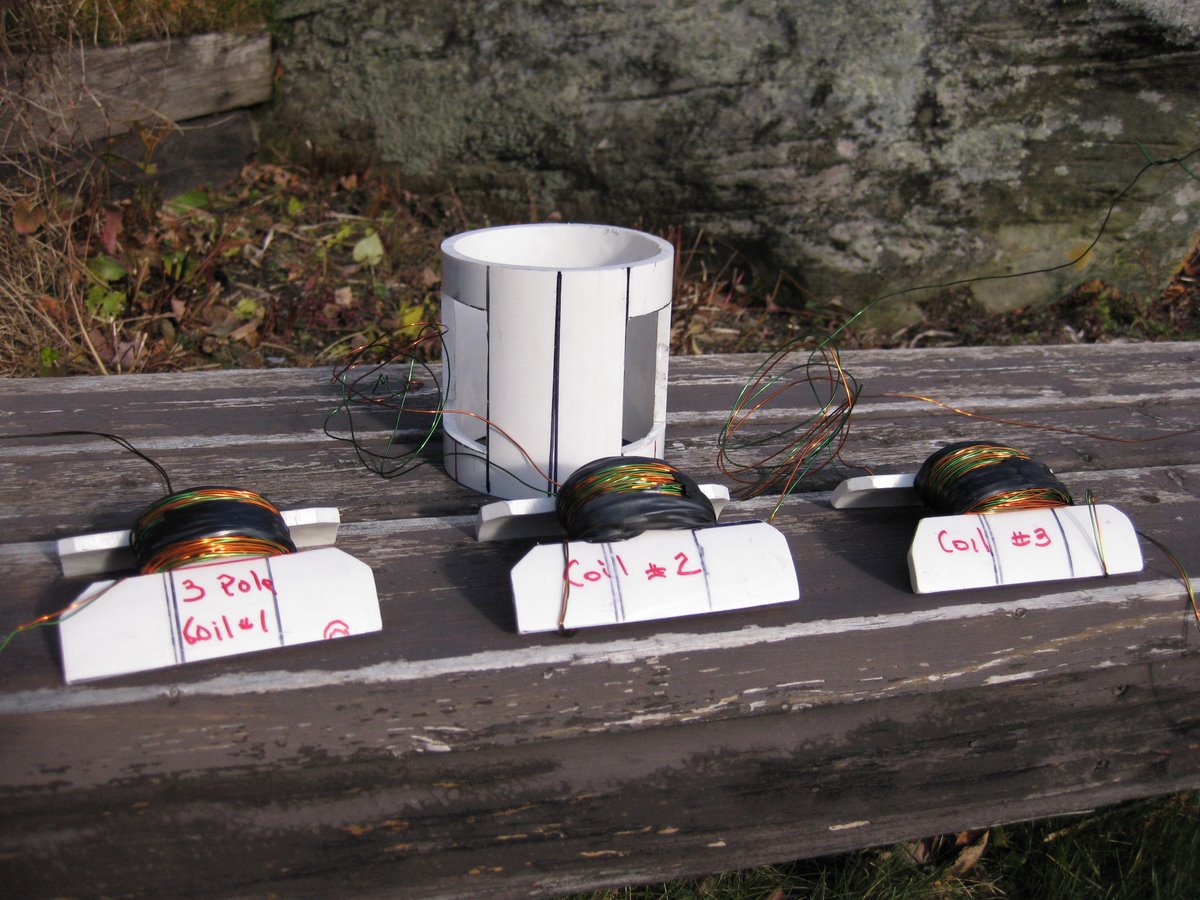

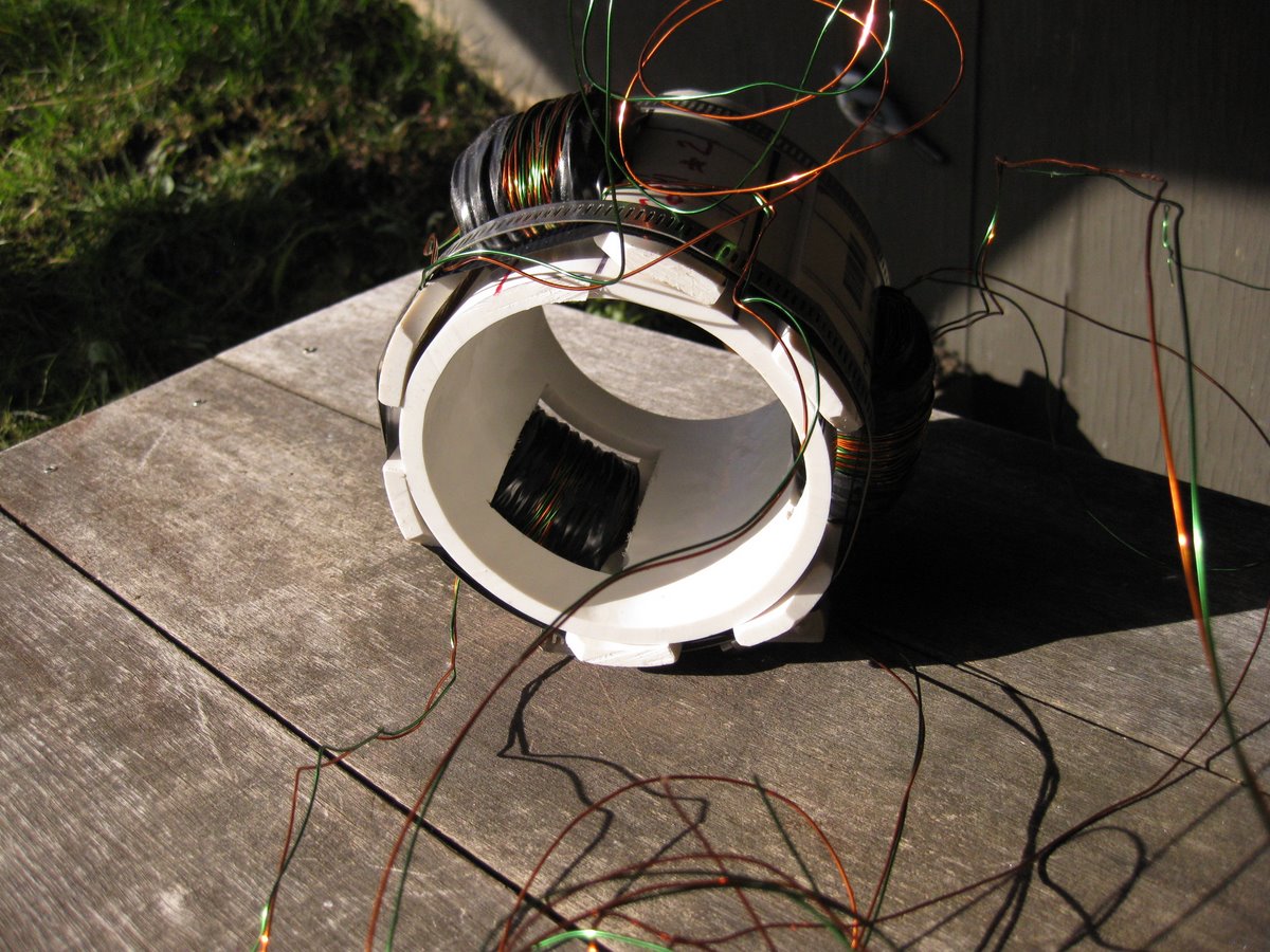

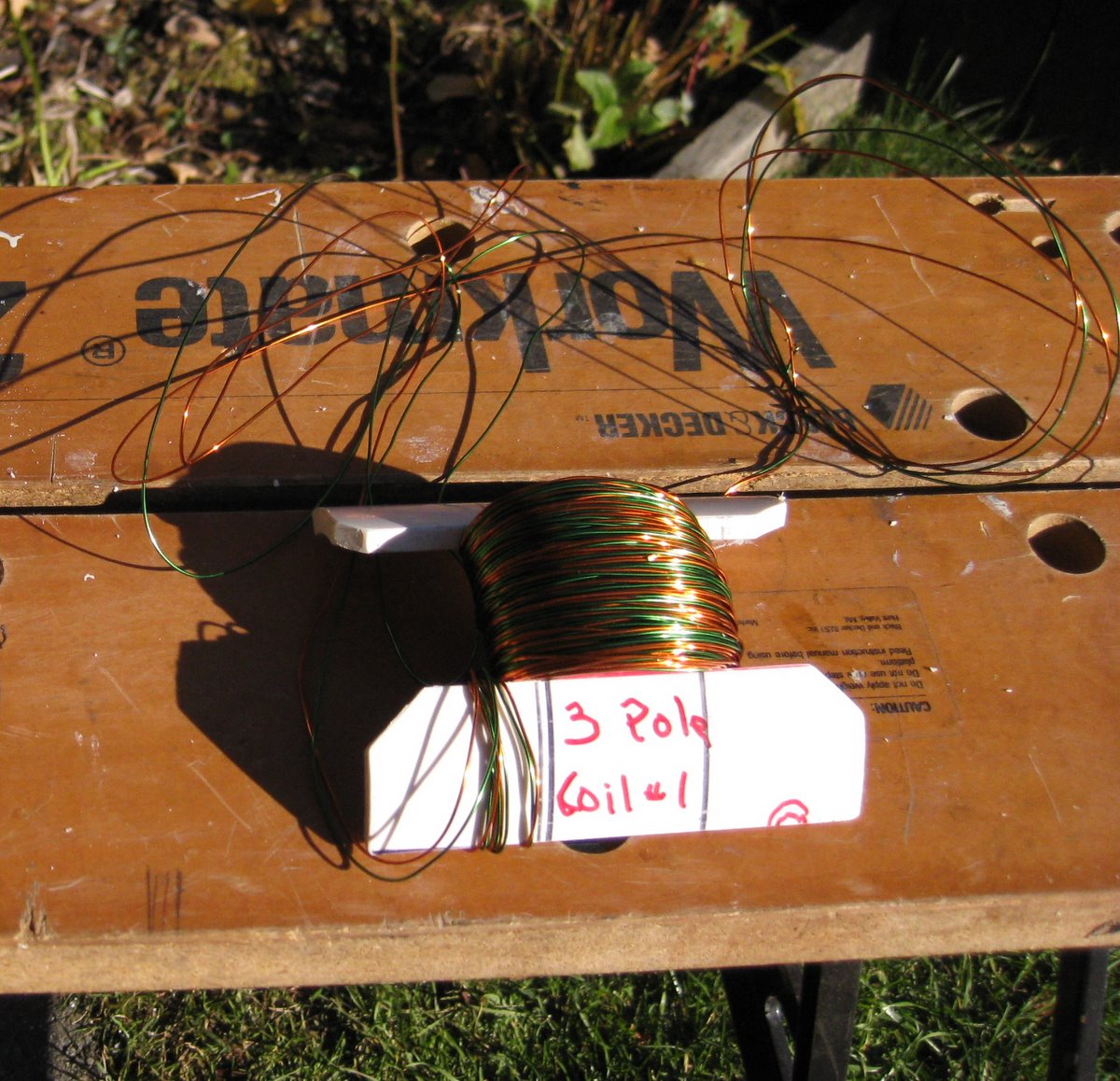

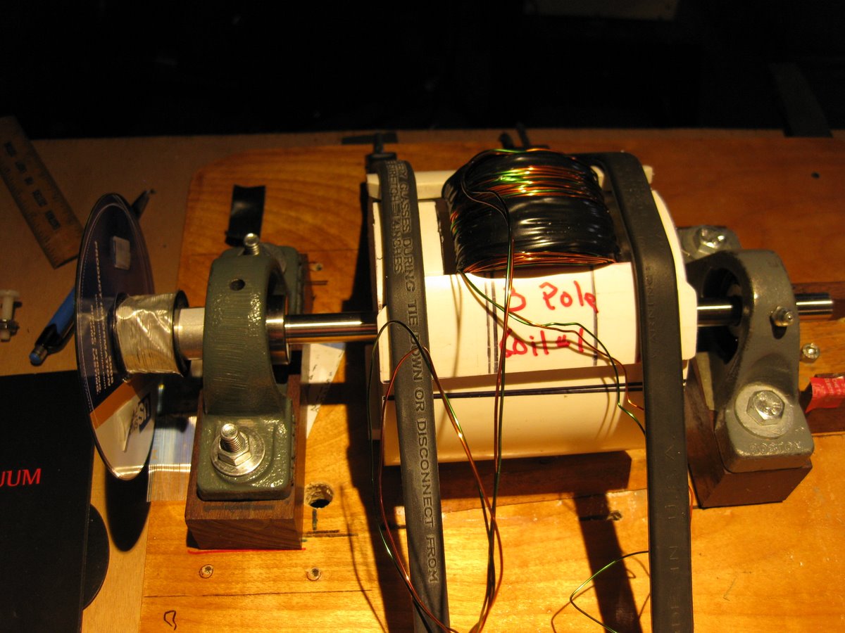

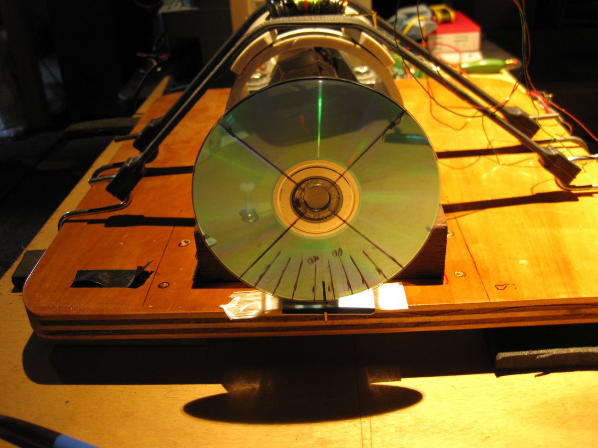

                    6 Pole Motor Assembled
                    Finally completed the coil winding segment of this project and assembled the 6 rotor pole YZFM. Cheating a bit here by using a 4 pole unit with 2 Neo's - pics are below.
                    The next step is to roughly calibrate the physical location of the coil end arcs to 120 degrees apart, clamp and then to insert the rotor shaft, align and check the internal 2 p0le rotor Neo edges for clearance. Once this is completed, well then starts the tedious part along with the acid test to verify that the coil degree arcs for all three coils are about 60 degrees. Will the hypothesis from the earlier experiments be confirmed?
                    Next, checking the coil arc in the open space between each coil. Hopefully, the readings with the coil arc's will fall into place. If not, then reboot.
                    Always a crap shoot when putting together an experimental device for the first time, but then, this is part of the adventure.
