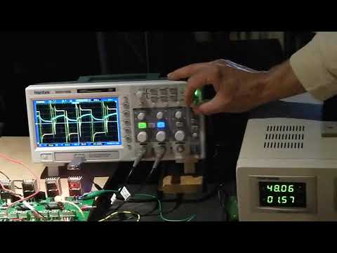

                ZFM Multi Voltage Torque Test
                Hello to all,
                To close out the long running test program of the original YZFM motor a series of torque tests were executed to demonstrate that one of the ZFM design goals was achieved. The final rotor design remained 4 pole with 1"LX1"Wx1/2"T N52 Neo's, but the coil to Neo edge gap was minimized to the practical limit of about 0.040" with an overall duty cycle of 65%. The timing advance is about 50 degrees. As the gap is minimized the Neo magnet edges begin to play a much greater role in the timing and performance. The torque characteristics of the motor are greatly enhanced with this approach with a reduction in achievable maximum speed.
                The Torque test was designed to have a constant torque load of 0.31 ft-lb applied to the motor shaft for the voltage range of 24v, 36v, 48v and 60v. In every instance the input voltage, amperage, RPM and load were recorded. In addition, the BiPolar switch was outfitted with the R. Cole inductive spike recovery circuit fed back to the input side of the BP switch.
                For reference purposes the unloaded performance for each voltage is as follows:
                24.0v 4890 RPM at 0.71A
                36.0v 7200 RPM at 0.80A
                48.0v 9800 RPM at 0.90A
                60.0v 10800 RPM at 1.02A
                The first test under load was for 24v - an acid test for the ZFM with a loaded cold start. The test progressed sequentially through the voltages. The basic performance parameters under the constant load of 0.31 ft-lb are as follows:
                24.0v 2466 RPM at 1.45A
                36.0v 4425 RPM at 1.54A
                48.0v 6088 RPM at 1.57A
                60.0V 7625 RPM at 1.56A
                The nominal output/input efficiency hovered at about 30%. So review the test video via this link:
                The video presents the YZFM operating under load and at the tail end of the video at 60v one leg of the BP switch is disabled. The YZFM continues to run, albeit at a reduced speed and amperage - this can be duplicated at the lower voltages, though some reduction in load is required. During the one leg operation one will note that the underlying BEMF voltage is visible on the Oscope.
                The last part of the video demonstrates the BEMF curve with the spikes from the Cole circuit when the input power is off. This BEMF curve is much more dramatic upon shutdown when the ZFM is unloaded.
                BTW, after the video was completed another test was run at 60v at a torque load of 0.46 ft-lb yielding:
                60.0v 6490 RPM at 1.97A with about the same efficiency. The motor coils were starting to get warmish.

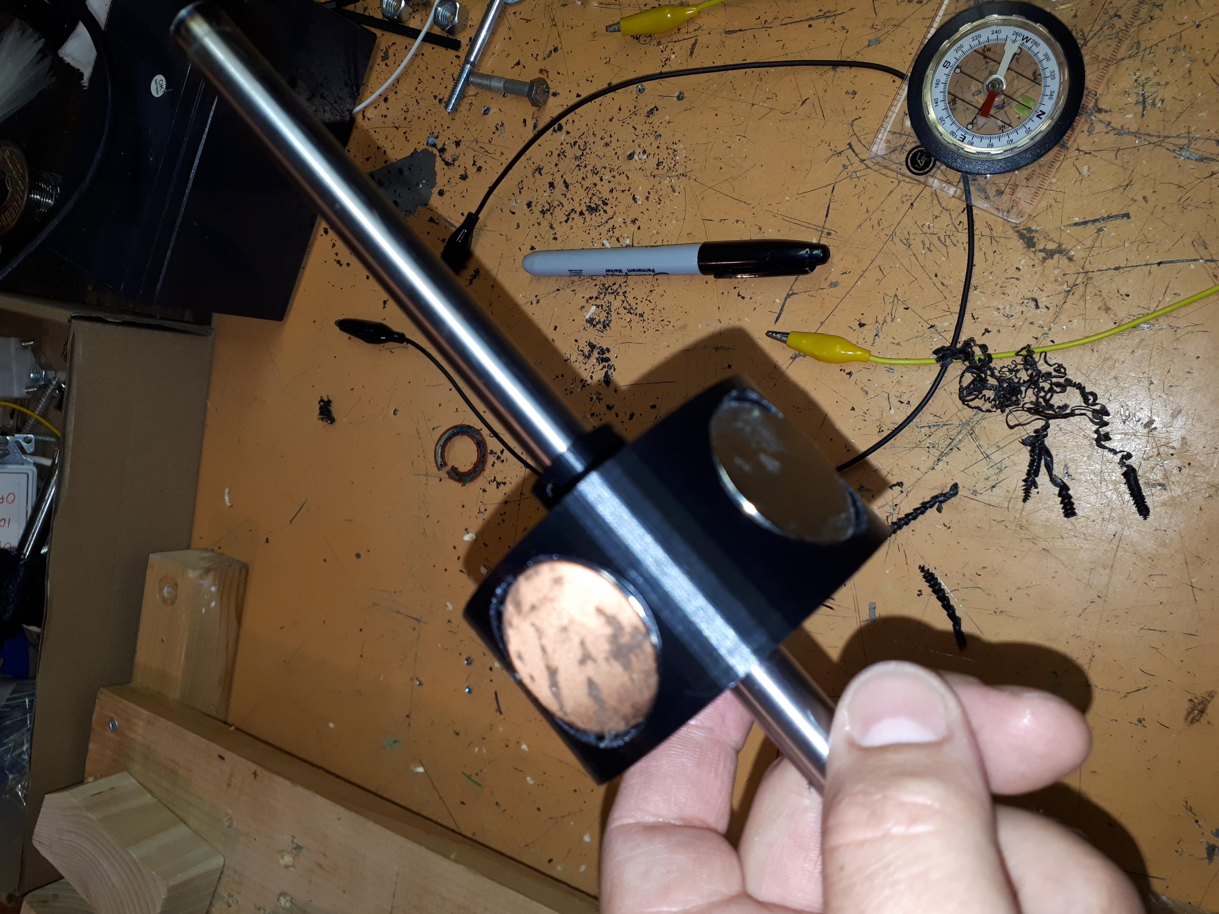

                        All sounds great! Here are a few pics showing where im at. I have inly been at this since buting yiur presentation last week. Much more to come.
                        I have five of those neo disc magnets stacked for each pole - NSNS config.

                            You are off to an excellent start with your build. The 3D parts in your pics look great and are beefy, for sure. When you get around to it detail the coil wire #AWG used (#18?) and Neo size.
                            The turn-on voltage spike on the o-scope looks to be fairly healthy...

                                the wire gauge is 22AWG and each coil is about 8 ohms
                                the magnets i used are here:
                                there are five of these disc magnets stacked for each pole
