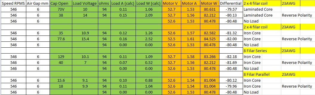

        Some data against some identical generator coils in different formations.
        Each coil is 8 filar, 23awg.
        Series, parallel and a combination.
        The load of 94 ohms was dialed in for an approx 10V supply.
        I have two combinations with different cores for comparison.
        Motor has received some upgrades with some ceramic bearings and aerodynamic upgrades.

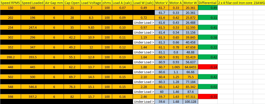

          I used the highest output Gennie coil and perfomed some speed data as attached.
          The differential is the wheel open circuit W + Gen coil output W - Wheel under load W.
          Most notable is the .58W gain at 300 RPM.

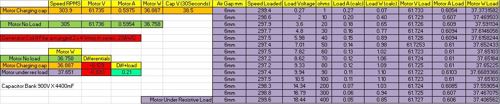

            Focusing in on the 300RPM mark I have used varying resistances to simulate a load.
            While the resolution on the ammeter is not adequate, the results confirm Peter's findings from the advanced book.
            At 800ohms the .01A ticked down .65A equaling the motor input indicating no current being used but im sure down to the thousandth of an amp it would indicate more clearly.

              True, however, it was at +/-100 ohms where the output was at its highest. Good stuff!
              40 watts seems like quite a bit of energy to throw at a prime mover. It might not be as easy to see data swings with that one? Have you considered adding PWM at this point, could help...

                The wheel is PWM.
                I've got a meter with better resolution I can use later on.
                The output is highest at the highest speed, the experiment was to prove if there was a net gain across the coil which there was.
                With a generator at 94% efficiency there should have been a net loss a across the coil.
                The 40W is only bearing and air friction.
                Isolating the prime mover was key to this as I can definitively compare inputs and outputs of the gennie coil, this hasn't been shown before as it's almost impossible to seperate the functions.
                In Peter's measurements 100ohm actually stalled his motor, however his coil was a little different to this coil and he was running the sg prime mover.
                I have no doubt that if you spent some good dollars on a perfectly balanced aerodynamic wheel in a vacuum chamber this would run ou with multiple coils.
                The load itself lends to tuning, dissipating the power needs to be sufficiently strong enough to eject the magnet and long enough to resist it pulling back in. The higher the resistance the longer the dissipation time.

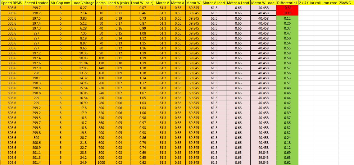

                                Here you go Patrick I cleaned up the data and used a better meter.
                                Keep in mind that using a resistive load straight from the coil is not the way to drain the energy properly.
                                What configuration gennie coil have you found to be a good fit?
