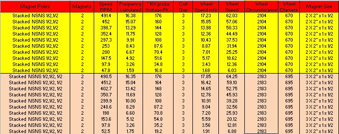

        Here are the results for double and triple stacked 1/2'' magnets.
        The double stacked is once again a higher potential than the 1.5 stack.
        The kicker is the triple stacked makes no differance indicating the core is saturated.
        A larger or longer core would be needed for the triple stack to come into its own.

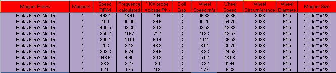

          Test Data on an 8 Filar 18ga Bedini Spec coil in series.
          Neodymian magnets 1" x 1/2" x 1/2".
          As supplied in Ricks 10coiler kit.

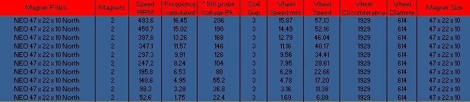

            Neodymian magnets 47 x 22 x 10mm North Out.

            • #36
              John looking good with the Neo comparison. The longer and stronger Neo's appear to stretch out the field that reacts with the coil yielding a beefier spike.
              Two Thumbs up for your effort and data.
              Yaro

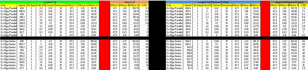

                              Here have some more data.
Name:	8 x 18ga comparisons.JPG
