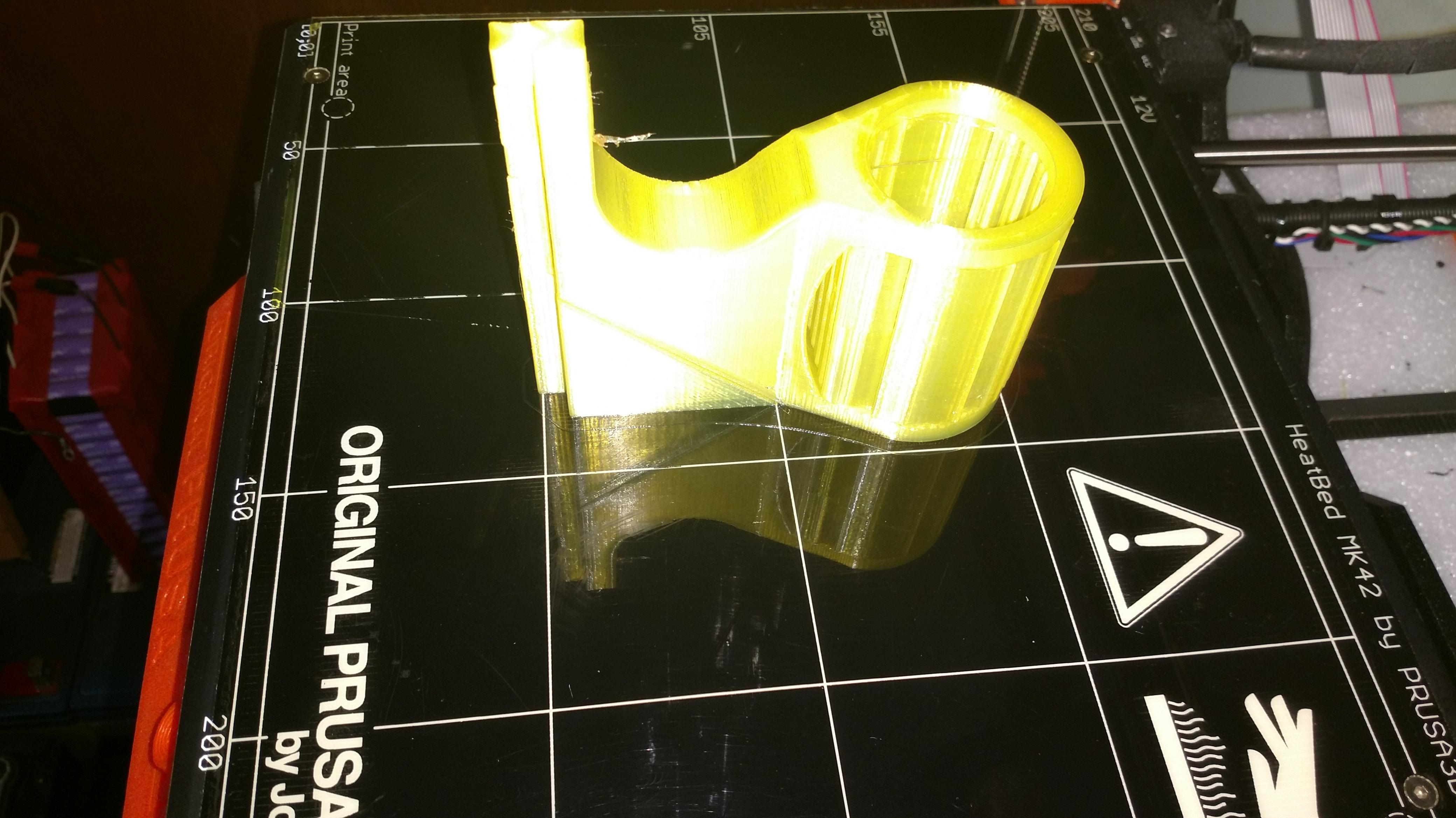

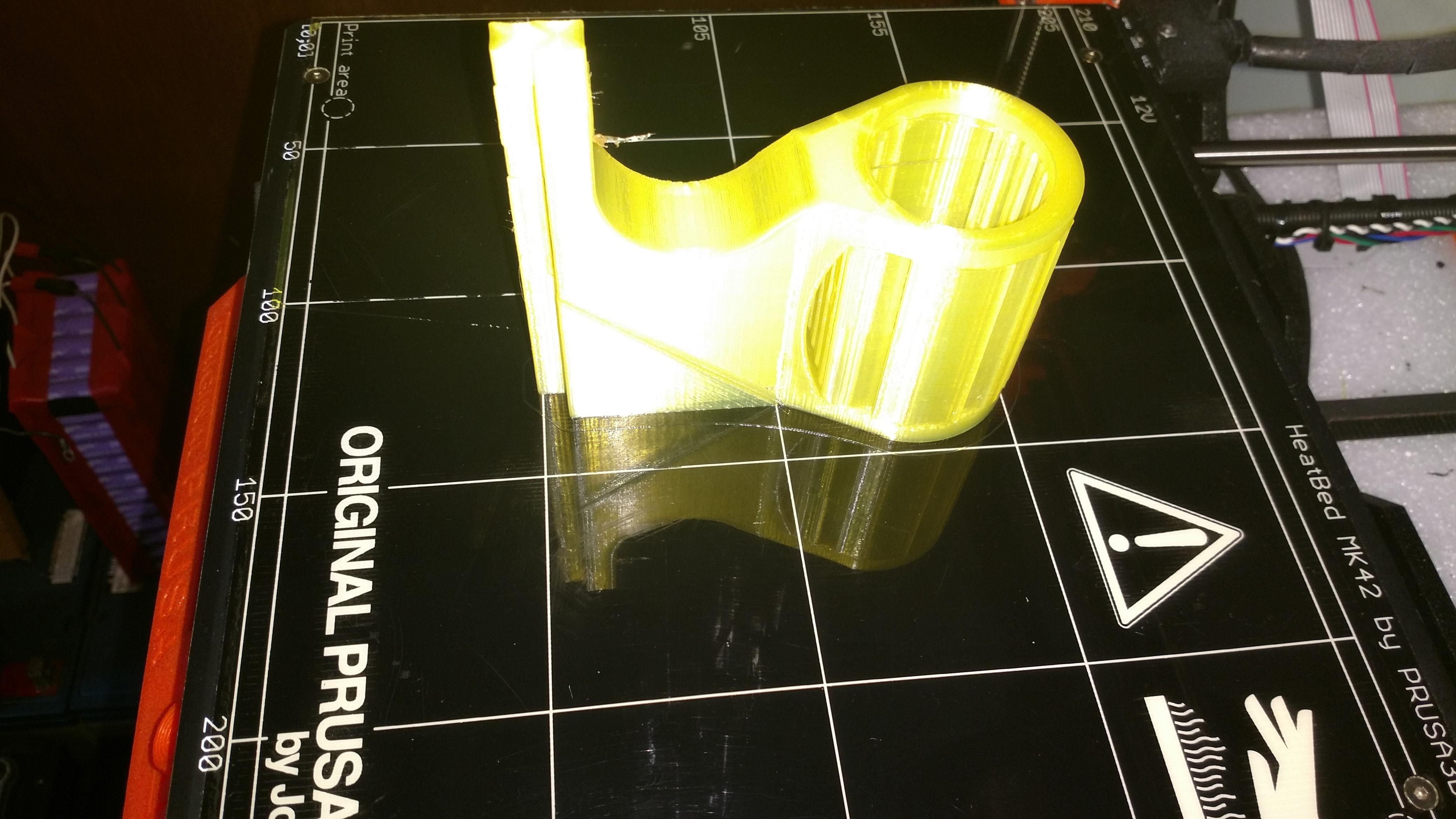

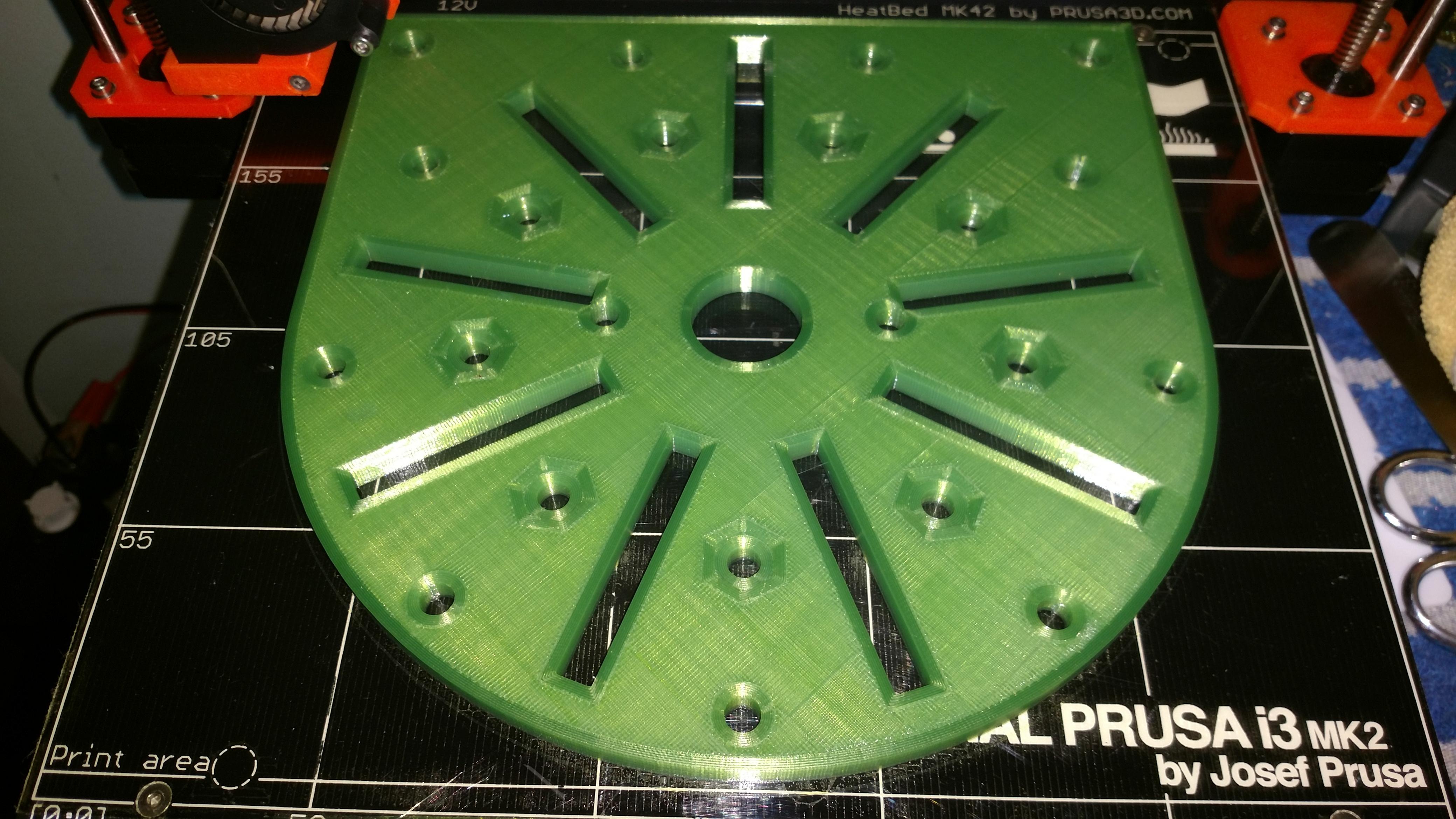

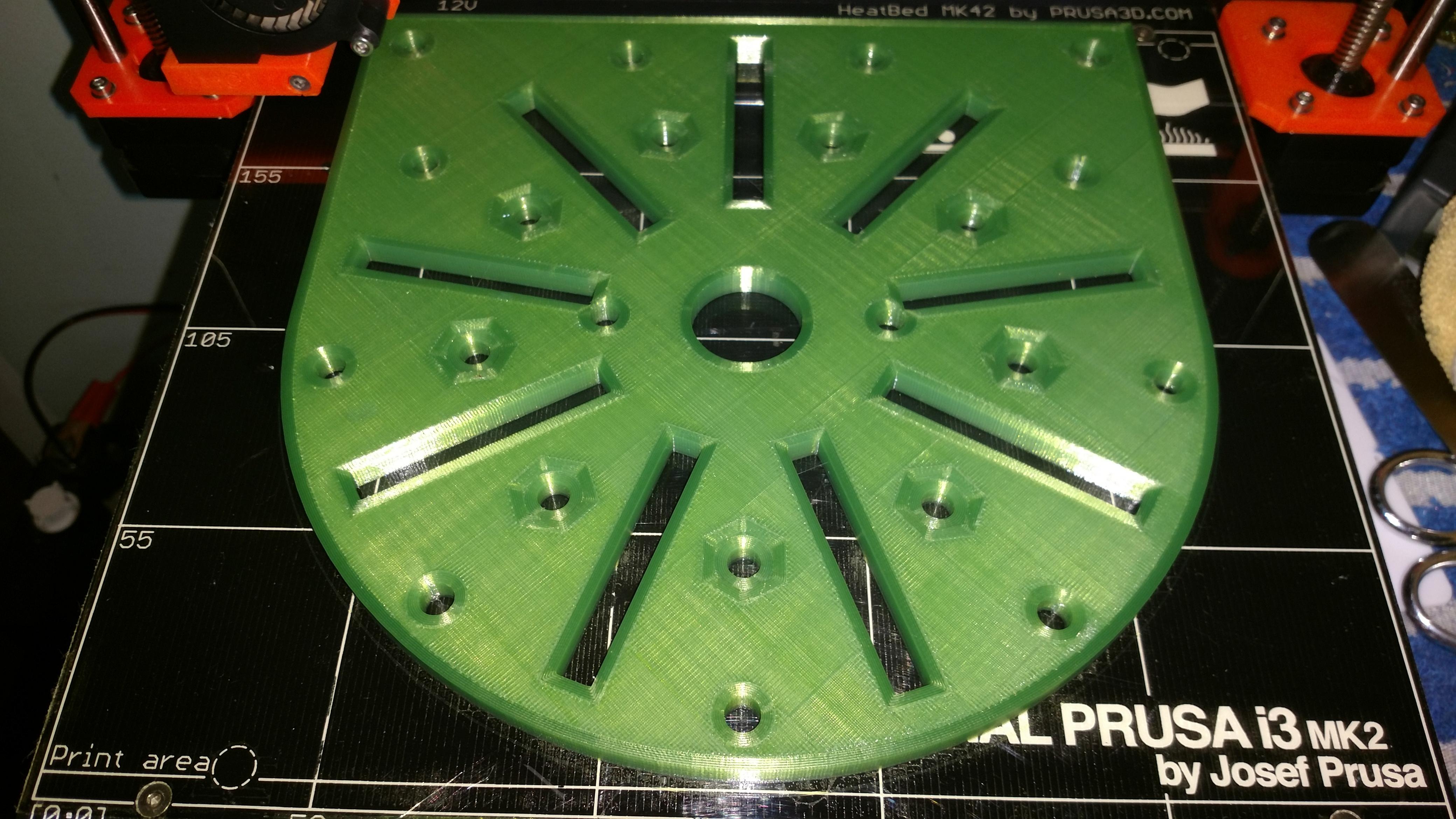

My prints come out spectacular. Have a look at a frame and coil holder I just printed for version 2 of my machine I'm working on. Click into these a few times to get higher resolution look at them.

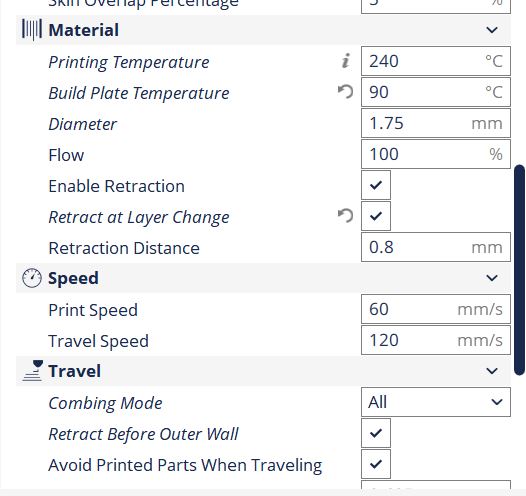

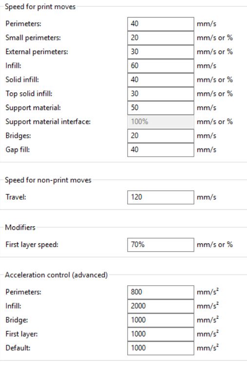

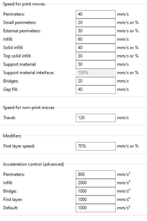

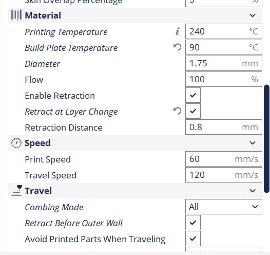

I have a few spools of PETG but have had nothing but problems. perhaps its because I have an E3D V6 hotend on my rostock max, they are known for clogging easily. I was trying to print weatherproof light covers, but the nozzle kept clogging. what is your hotend temp, feed speed, and what size nozzle is on the PRUSA
Sorry I did not see this until now when Doug posted something to this thread. My machine uses the same hotend, I remember in some other thread trying to tell you that but we weren't clicking so I didn't push it. I use a .4 brass nozzle, clones now but the first one was an original. At one point I had a partial clog after using the same one for months and I could not get it to clear up so I put in a hardened steel nozzle instead. That caused me a lot of problems, I later found out that you need to crank up the heat with those because thermally they behave much differently. Anyway I got some clones and they work just as good as the original (link below)
https://www.amazon.com/Mercurry-3D-E...PLA+3D+Printer
Here is a shot from my slic3r settings to show print speed and also cura. Most of the time I print at .35 layer which is not as nice but gets my parts done reasonably fast, sometimes I will go with .2. I set the nozzle temp for 240C and the bed at 90C.
Maybe you got a bad batch of filament? I find the PETG very easy to work with and it is very strong as long as you make the walls thick enough. You can even make things that are semi-flexible with it by making things that are not so thick, it bends a lot without breaking.
