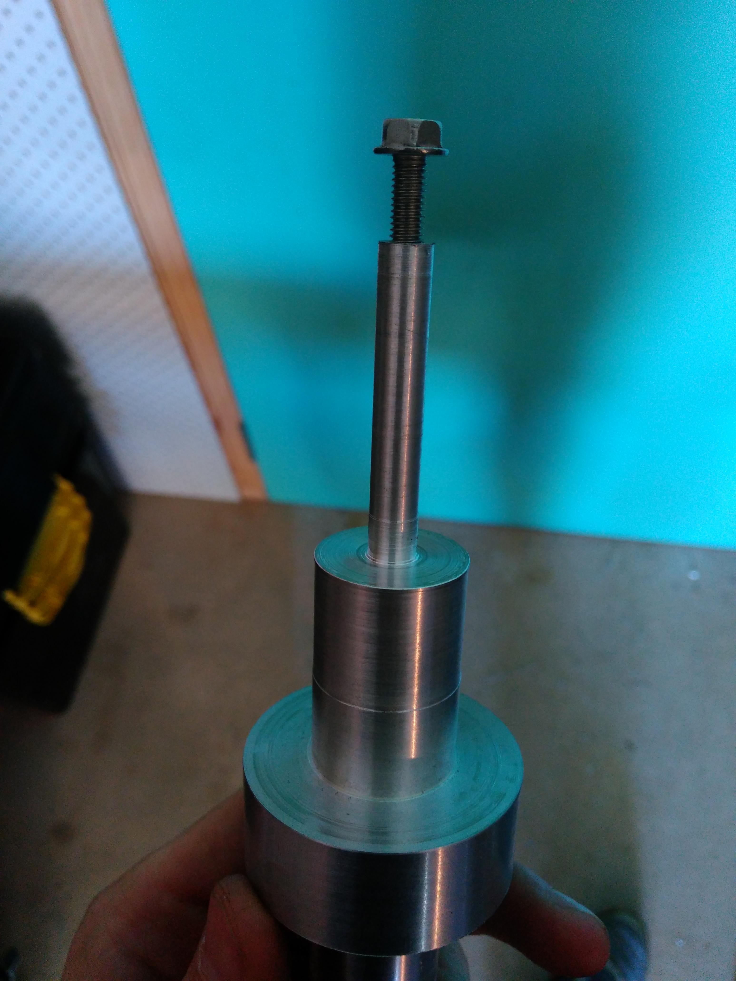

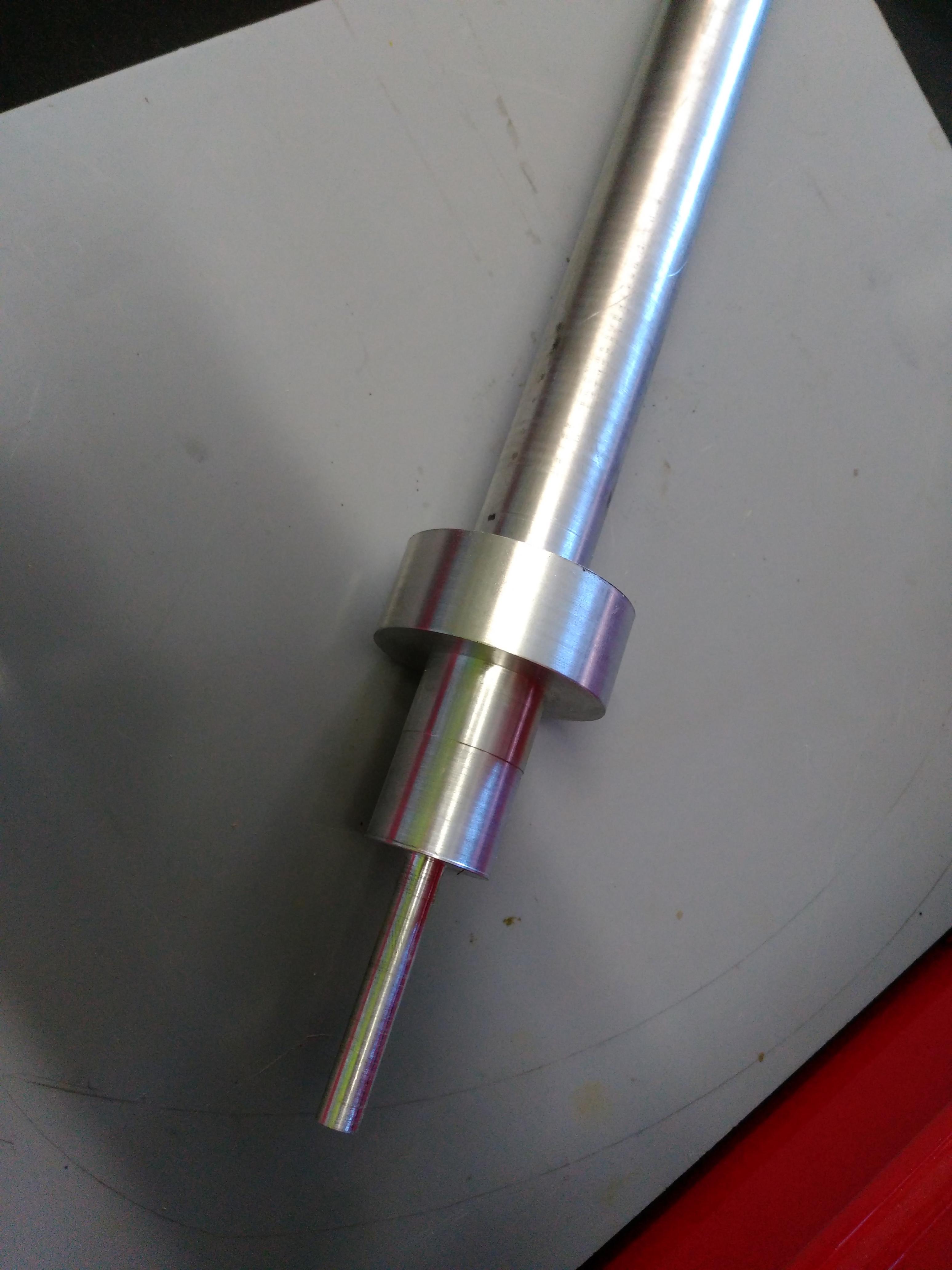

    Shaft machined.
    Cant spend it when your dead.

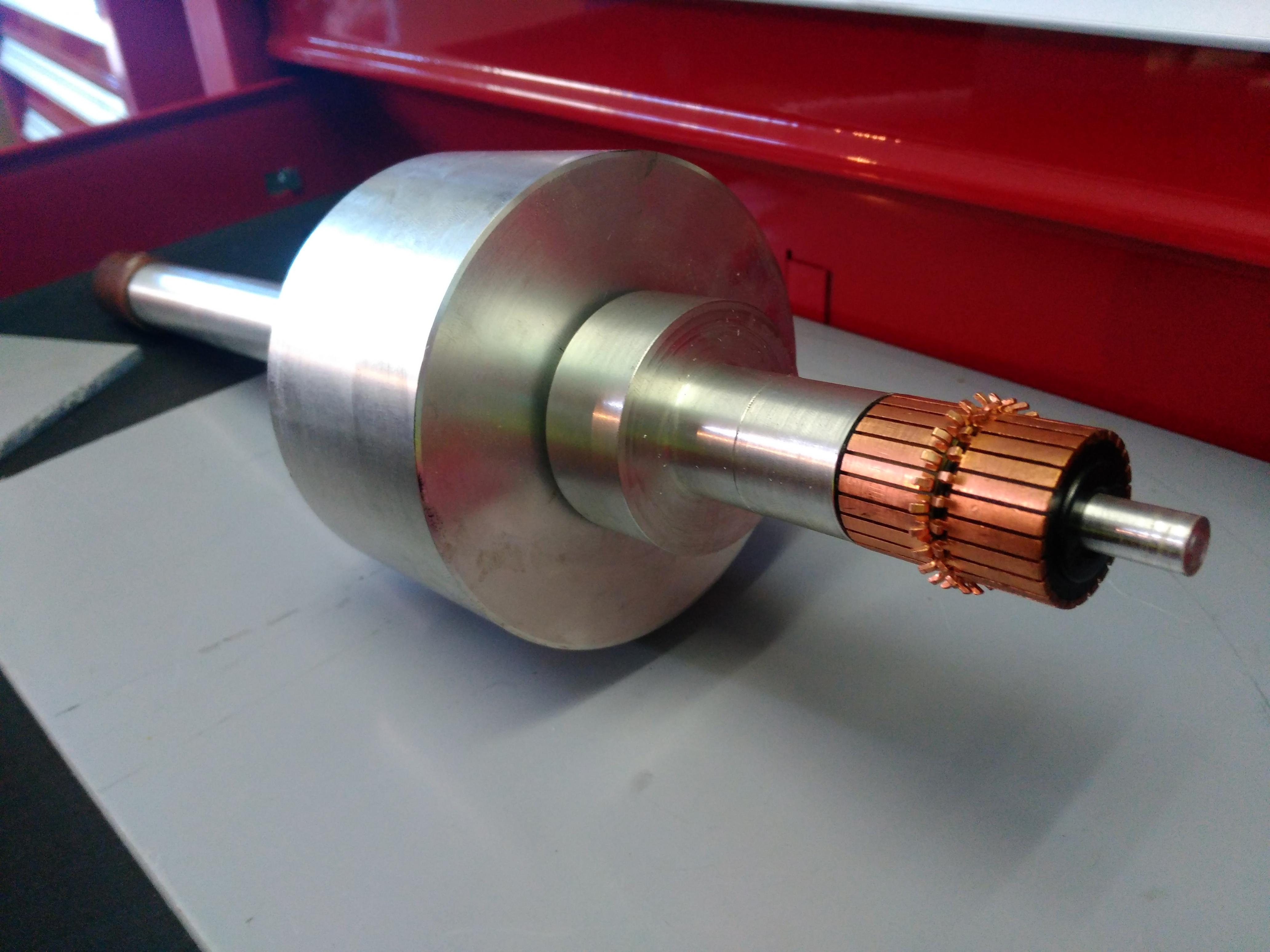

      Rotor, shaft and commutator segments assembled.

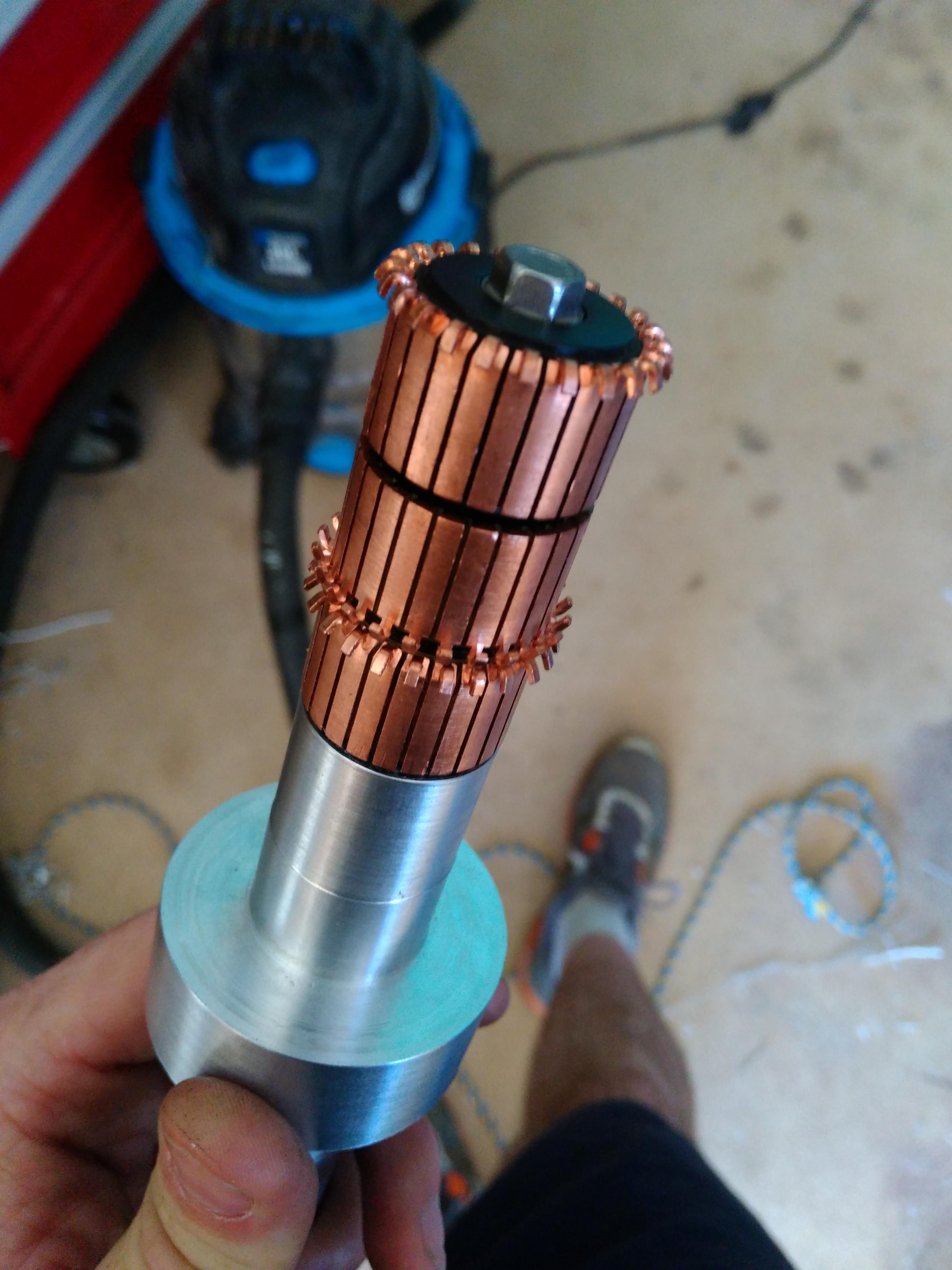

            Shaft tapped with 3 commutator segments.
            The first two are back to back and will be soldered appropriately.
            The third will be a slip ring for the time being.

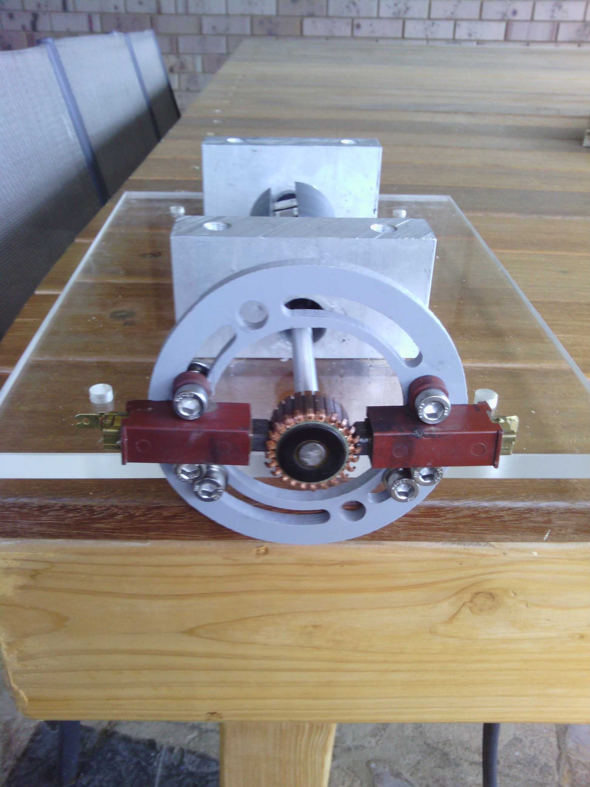

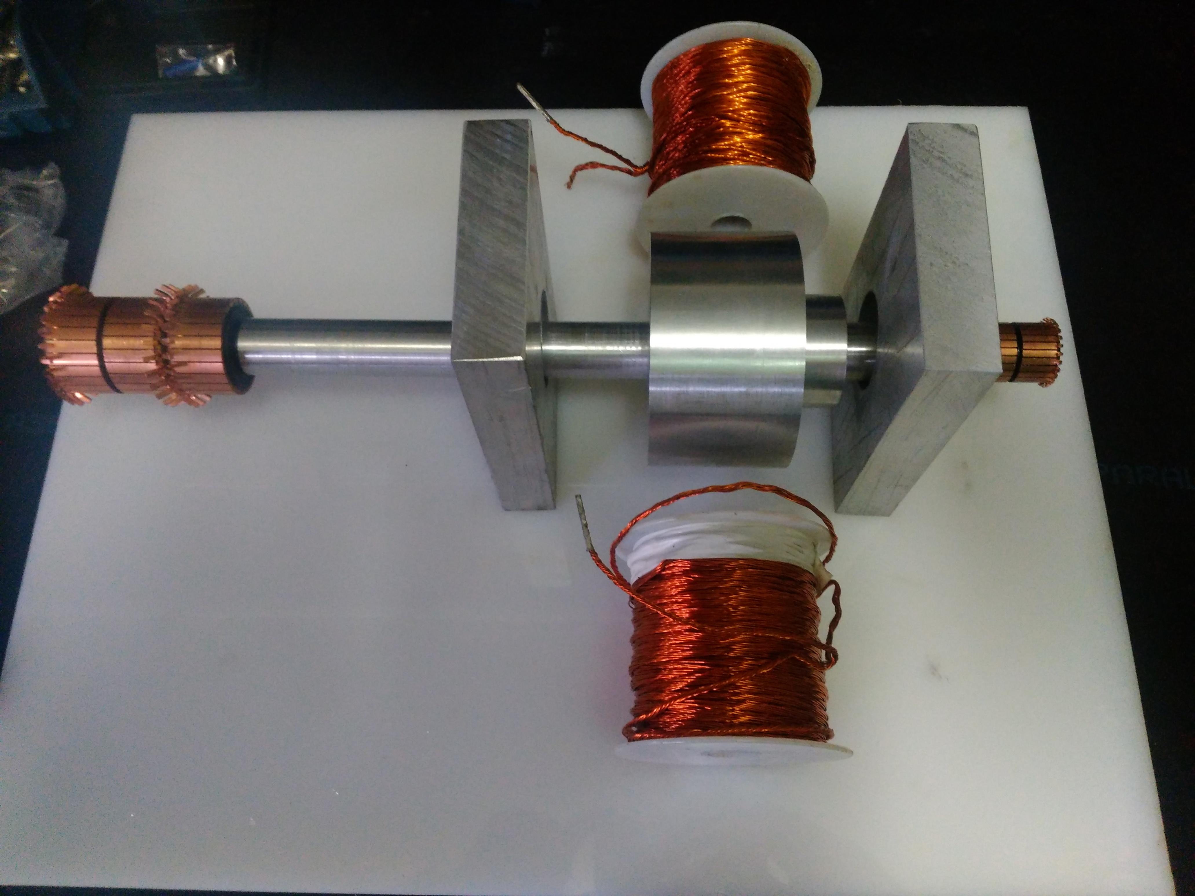

                  My new larger Commutators turned up.
                  So did my 20mm polyethylene sheet.
                  Still waiting on bearings for my blocks.
                  Couple of Voldemort's old coils and its starting to look like something.

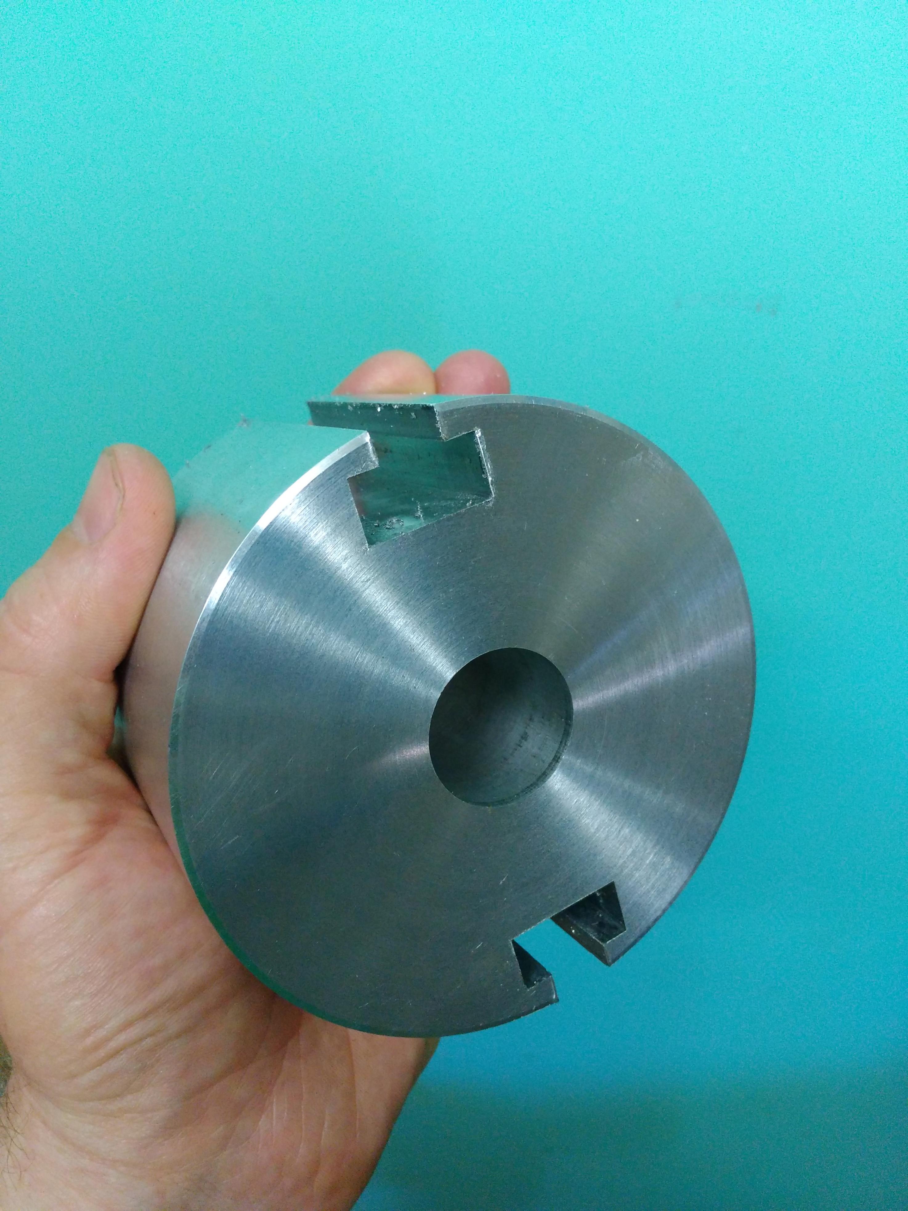

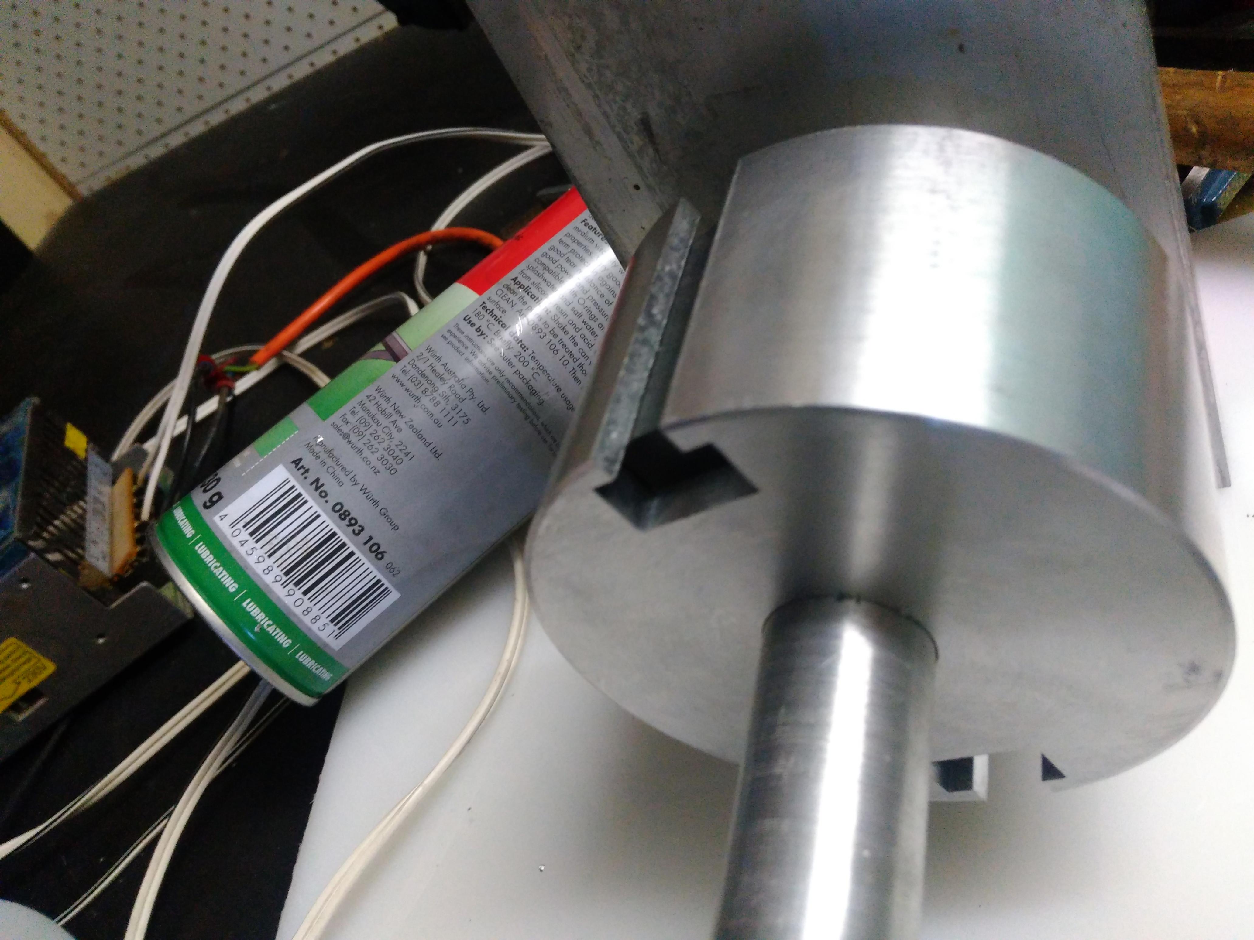

                      Rotor is slotted and magnets fitted.
ID:	49100Click image for larger version
                        Looking good John. Just 2 magnets on the rotor in this version?
                          Hi John,
                          For the moment yes. This is a test bed for larger versions.
                          I was contemplating just one magnet with an inert weight to counterbalance.
                          The shaft, bearings, commutator etc can all stay the same and a larger rotor can be installed with more magnets if necessary.
                          If this works I'm thinking of turning the 10 coiler into a mechanically switched monster.

                              The brushes will be mounted to 6mm PVC in a geared mount for tuning while running.
