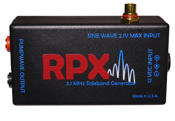

                  Just fyi... this is what the new RPX Sideband Generators look like - I think they came out really good!

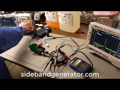

                        When I bring the probe from the spectrum analyzer close to the banana jacks, I can get the 3.1MHz signal easily.
                        For the sw radio, I honestly have no idea. I do know that when John ran the larger 10 watt units (with the linear amps) that he could pick up "tones" across town on his radio. That is how he described it at least.
                        The function generator is very sensitive so can pick up weaker signals than what your radio will pick up and amplify.
                        When I have the RPX unit on and the function generator is OFF, I get 6.7 VDC hooking the multimeter probes direct to the banana jacks with nothing plugged into those jacks and 292mv AC.
                        With the function generator ON, I get 6.2 VDC and it slowly climbs and about 2VAC and it slowly drops.
                        This is measured with a Fluke 79III multimeter.
                        Testing a random other unit - 6.7 vdc and 310mvac with generator off.
                        On = 6.3vdc and slowly climbs and 1.9vac and slowly drops.
                        Your voltages are higher and I don't know why. What multimeter are you using?
                        I also can't say whether the SDR should be able to act as a spectrum analyzer. It's really not the right tool for the job - just my opinion but I wouldn't trust it.
                        All these units are tested twice before they even get to our hands for shipment by a very competent and professional circuit board assembly company. They do high end work for DOE, military, and many private companies - the quality is beyond belief. They're also fully trained in John Bedini's exact measurement method to verify the 3.1MHz fundamental and sidebands using the exact same protocols and they're even using the same equipment (since I provide it to them).
                        At 19 seconds, you can see one of their techs that does a lot of their testing turn on the battery (without the function generator on yet) and get a 3.1MHz fundamental on the function generator. The first test they do is after everything is assembled. Then when everything is proven to work flawlessly and so far we have a 100% success rate, then potting compound is added to seal the circuits. The potting compound gets hot and after it cools down, this is going overboard, but I have them test each unit all over again. It isn't necessary, but my personal standards demand it. When it passes that second test and they're all done, we pick them up and they get boxed for shipping so we know that they're working 100% perfect when they leave our hands.
                        Do you have access to an actual spectrum analyzer?
