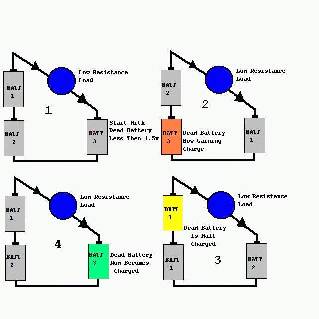

    So based on this:
    I've been doing this:
    I neglected to draw in the trigger bulb regulator, but I think you know where it goes - on the trigger... :-)
    On mine this was tricky to tune, it did not want to start right off the bat. I went back to the normal primary battery with charging battery, tuned it, then switched to the TS hook up and it was much easier.
    Not going to claim anything, but if you have 4 batteries and an SSG lying around, it'll be worth your while to give it a go.
    try it with 1 ONE transistor first just in case you hook something up wrong.
    Kind regards - Patrick A.

    Hi Patrick,
    That looks interesting, but I must be a little dense - I don't see how the coil collapse feeds anything to the batteries the way you have it drawn.
    Doesn't the discharge just short circuit back into the coil through the diode across it? I may be overlooking something obvious and would appreciate an explanation of how it works.

        Hi Patrick,
        I think I see what the circuit is doing all except for one thing. How does the top diode keep from providing a short circuit back to the coil and force the coil discharge to take the higher voltage path through the other diode and recharge the serial connected batteries? Isn't the top diode forward biased in parallel with the other diode and two series batteries. If the top diode was a transistor that opened and closed simultaneously with the main transistor, I could understand how it works.
        I also don't understand the need for the diode in parallel with the parallel connected batteries.

          It's not the diode that "keep from providing a short circuit back to the coil ", it's the natural path provided by the diode going to the negative of the 24 volts which "allows" the discharge to be placed there (across the 24 volts).
          Very smooth yes?
          And yes I asked if you thought the diode across the paralleled batteries was needed. I have it running on my 7 transistor set up and did not want to remove it while running - do you say I should remove it?
            Hi Patrick,
            I understand the natural path provided by the diode going to the negative of the 24 volts. What I don't understand is what keeps the coil discharge from taking the lower resistance path through the top diode instead. Does the top diode switch more slowly than the other one? I always thought electricity took the "path of least resistance" or is there something going on with the radiant that I'm not grasping?
            And just because I don't understand the purpose of the diode across the paralleled batteries doesn't mean I think you should remove it. If it works ok that way why not leave it? I'm just trying to understand it's purpose and why you put it there.
            My understanding of circuits is mostly based on conventional theory, and somewhat limited at that. I have a hard time grasping all the concepts involved with radiant and pulsed DC.

              I hope my questions are coming across sincerely - my understanding of ckts is through trial and error :-)
              Your educated inference as to how the energy is flowing sounds reasonable. All I know is the spike does go to the 24V series bats thereby recharging them that's where the energy comes from to run the SSG. The paralleled bats get their charge from the same place the 24 volt seriesed batts.
              I know this via trial and error, if you remove the diode from the neg of the 24 volts, the spike does discharge across the coil. This is very evident from the bucking reaction that follows.
              Remember my previous posts - you can send that spike to a 2nd 3rd 4th coil and speed the wheel up as well... I'm actually pretty surprised no one gave that one a try.
              well, nuph said... I hope to hear from someone who gives this a go.
              Cheers - Patrick A.
