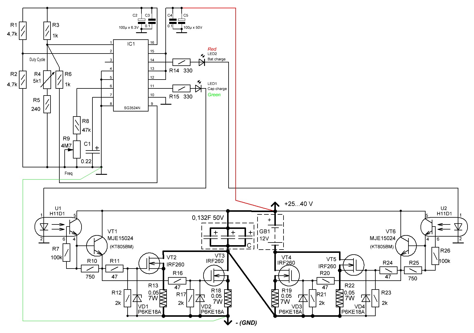

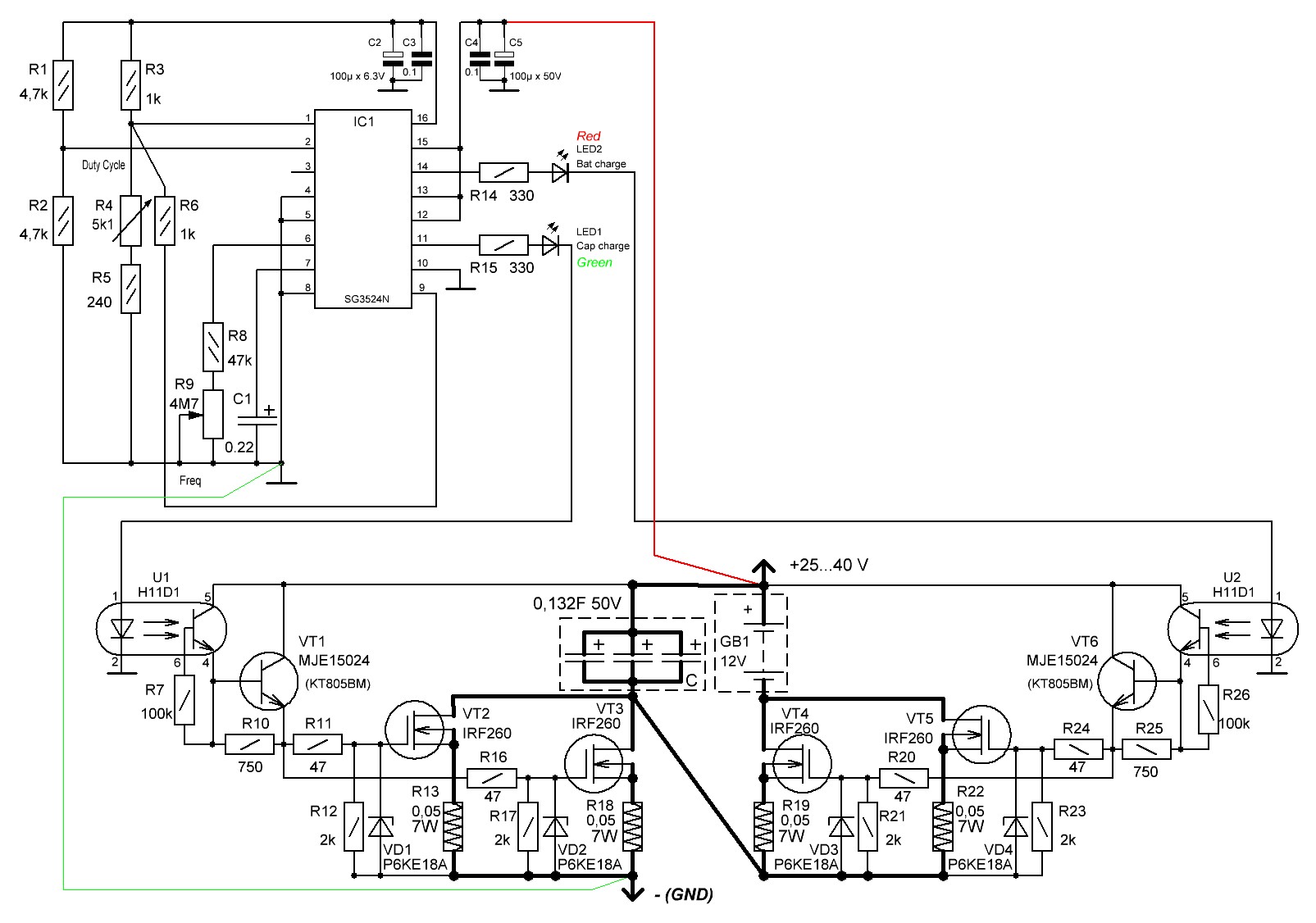

Hi everybody,
I have a question about John Bedini's US2003/0117111 patent. John always says that it is very important to interrupt negative rail when charging a battery. And all of his schematics do just that. But in this patent one could see interruption of positive pole of battery. If it is a mistake in schematic?
