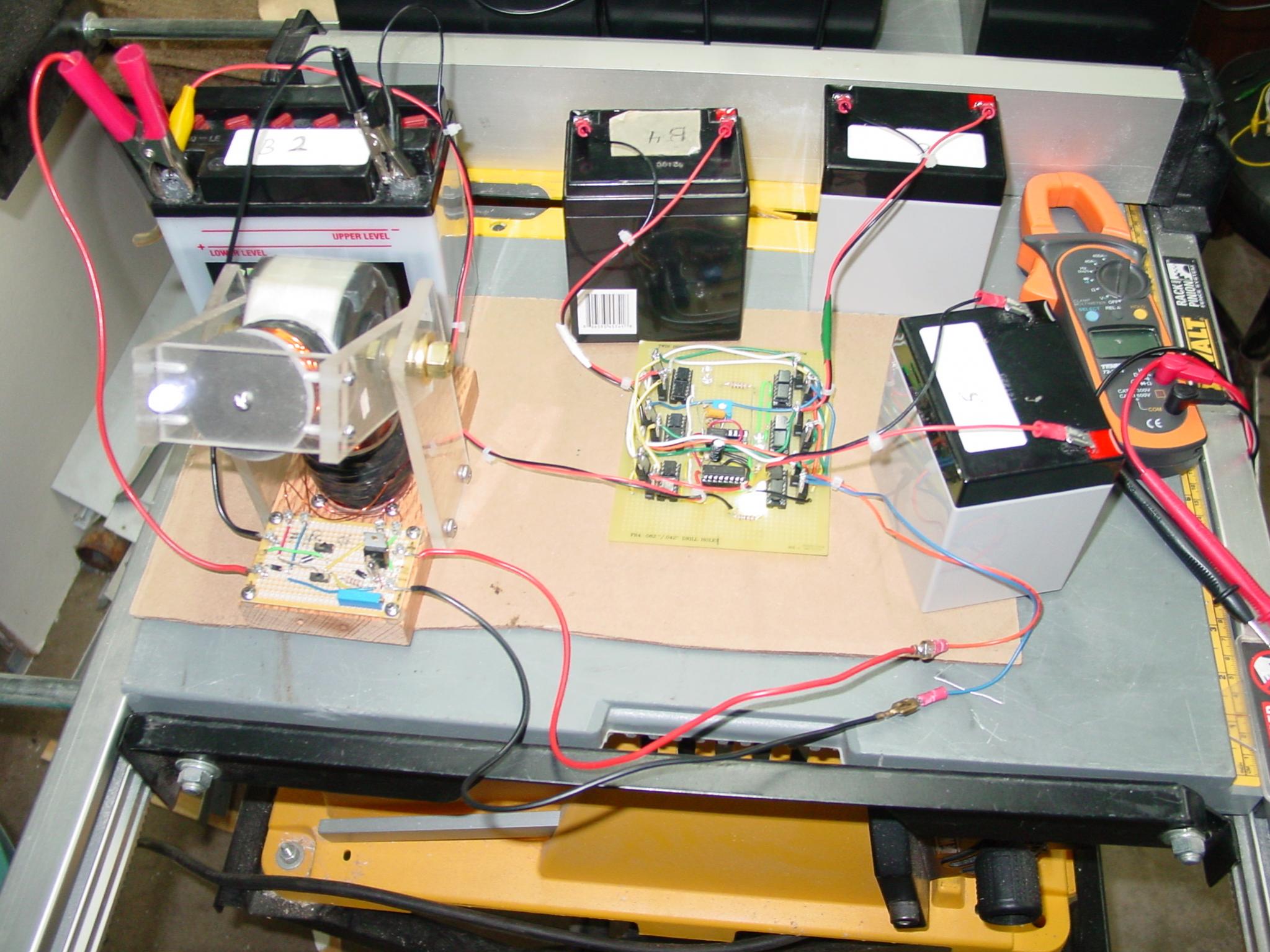

Here is the mod to eliminate the Magnetic Hall Sensor and to use the trigger winding to trigger the driver circuit.
The 3 motor winding's plus the the trigger winding, are all wound together as a quad-filler coil.
RV1 is a 10 turn pot and slowly turn while spinning the wheel until the motors spins itself. Because all winding's are the same length and all on one coil spool, only a single tuning winding is needed. Enjoy and have fun.
