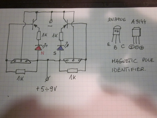

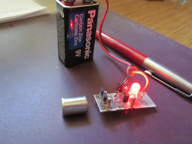

          Simple one and works just fine. I used bi color LED with common anode - Click image for larger version
ID:	47065Click image for larger version
          V

            blackchisel- Thanks for the schematic and picture. In the future that can be a circuit project of mine however I would prefer for now the properly manufactured equipment
