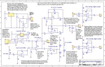

    here is a better site and where my gauss meter circuit came from

        No, that hall will prob. not work..... it is most likely a on/off output only.... check its part # to see
        you want a linear output hall effect sensor...A1302KUA-T or A3516LUA
        and so long as the 5V is stable, it should work.... but you will still need a higher +/-supply voltage's for the op amp circuit to run from
        LM741 opamps will work too
        allegro is good about sending free samples....

          the gauss meter opamp circuit will also work with these hall effect current sensors and make nice instrumentation for your experiments

          Use a volt meter like this one for the opamp output on the gauss meter and the current meter projects
