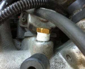

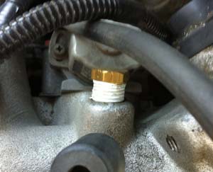

    One of the biggest vacuum "leaks" on an engine is the PCV valve since it is basically a wide open port to the crankcase so there can't be much vacuum in the manifold because of this.
    So, if we remove the valve or cap it off, we seal one of the biggest vacuum losses there is, which will increase the vacuum and will therefore increase the amount of fuel that is vaporized for better efficiency. Instead of slipping anything over my PCV valve to cover up the hole, I removed the whole thing and put in a pipe thread plug with a bit of Teflon tape on the threads.

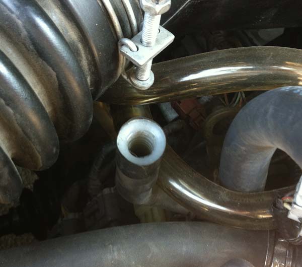

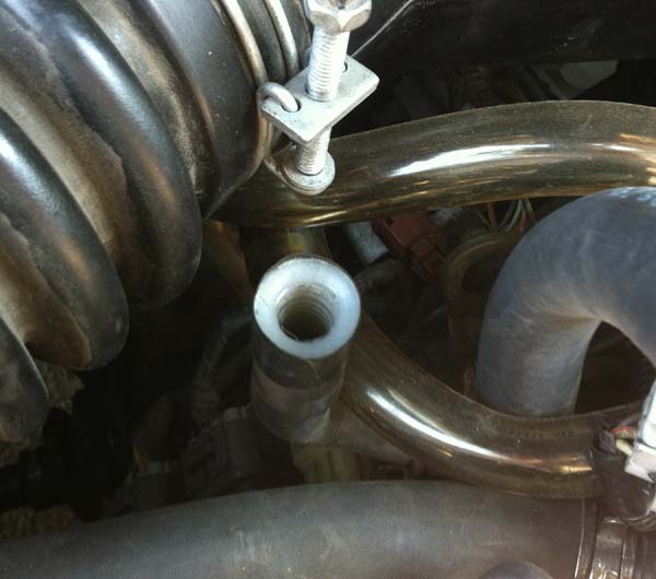

    And the hose that did direct the blow-by to the PCV valve, there is usually a Y on the end - one end goes to the PCV valve and the other end goes to the air intake box before the throttle body. So, you can just block off the one that went to the PCV valve by plugging the hole with whatever.
    The blow-by is still ducted to the air intake box so you aren't venting it to the environment and are not defeating the emissions - all the blow-by is being recycled back to the intake. You're actually reducing emissions when you increase the efficiency because more fuel is burning.

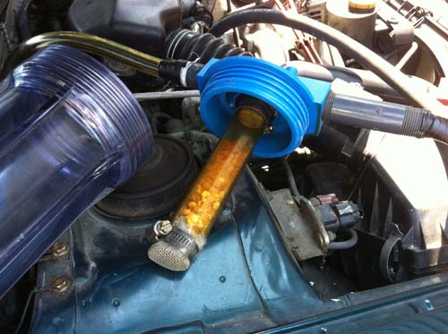

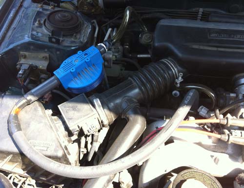

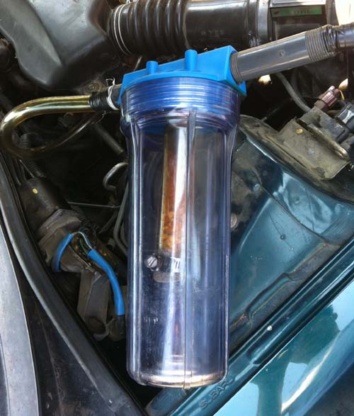

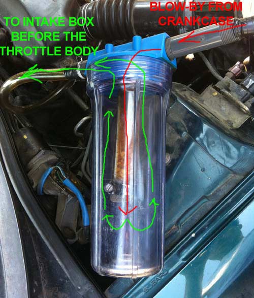

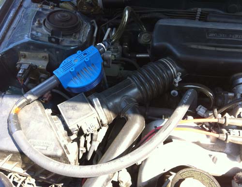

    Now if you want to take this to the next level, remove the hose that goes to the air intake with the blow by and run it through a vapor separator and the output of the this goes back to the air intake box before the throttle body. The vapor separator uses a process called ADSORPTION (not absorption) to pull the dirty particles out of the blow-by when it comes in contact with the silica gel bead filter.
ID:	50836Click image for larger version
ID:	50837Click image for larger version
    adsorptionThe process by which molecules of a substance, such as a gas or a liquid, collect on the surface of another substance, such as a solid. The molecules are attracted to the surface but do not enter the solid's minute spaces as in absorption. Some drinking water filters consist of carbon cartridges that adsorb contaminants. Compare absorption.
    adsorption Gas molecules are attracted to the surface of activated charcoal but are not absorbed by it.

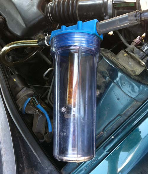

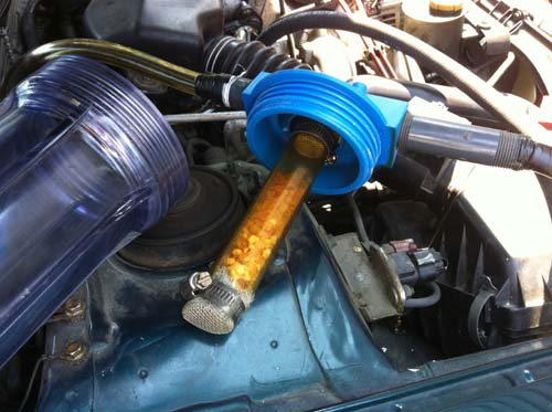

    The sludge will condense on those beads and will drip to the bottom of the container for easy disposal. That means you are only ducting purified blow-by vapor back to the intake. That will allow your oil to last longer, keep the intake cleaner without all that buildup, etc... and by having higher quality blow by vapor without the heavy particles, you have a better burnable vapor that further increases your efficiency, reduces emissions and extends engine/oil life.
    You can see Elmer W. Bush's patents on the blow-by vapor separators: https://www.google.com/search?tbo=p&...mer+W.+Bush%22
    The name brand "Condensator" is very expensive but you can make your own at very low cost - the old patents on this are long expired so anyone can do anything they want with this concept. There are many companies making their own versions and some use copper BB's as the filter media but I use the gel beads. I bought a gallon of silica gel at the pet store - it is used as kitty litter. Was about $15 - and will make hundreds of filters. Also, that silica gel isn't round so it won't go rolling everywhere if spilled - it is salt rock shaped so won't roll around.
    Normally, you take the hose from the blow by going to the PCV valve and put it through a vapor separator and back to the PCV valve, but you haven't addressed the vacuum loss issue. Combining the PCV mod with the vapor separator, you get a synergy.
    Mine is bigger than I need but I just used what I already had on hand. I used a pre-sediment filter in reverse (output is input and input is output - that is how you make the input go down the center) as the container and nothing but hoses and clamps. I wanted a rugged high quality one and not some flimsy plastic junk. You could make one out of a plastic empty peanut butter jar if you want - up to you.

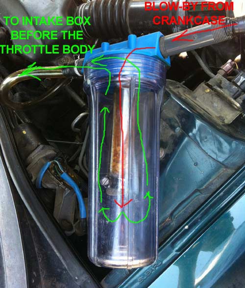

    vapor separator
    This is how the vapor separator works.
    Usually, I have some clear water and gas at the bottom - several tablespoons and that gives off good vapor that gets sucked into the intake.
    There is NO sludge in the bottom. The beads are not getting darker. So with these mods and the groove, I'm obviously getting very clean burning
    since the condensed sludge isn't increasing.
