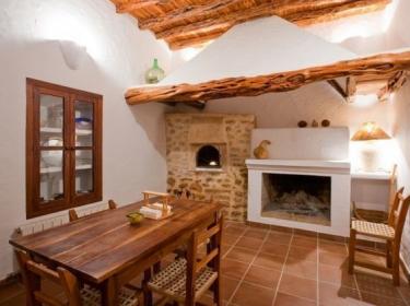

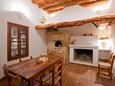

          Hello very good you are looking for adobe buildings.When i was in Bolivia i learn many things and advantages what adobe has (radiation free..)
          I was involve and still in many projects on building with stone tek and domes structures.Here the traditional house is face south and the wall are 60 to 80cm wide so fresh in summer and if u close the main door before sunset in winter the keep warm.The roof has a special tek. that is made with algae from the mediterranean sea,after we dry we used as isolation on the roof,then on top of that we put clay and there is when the roof is making a very crazy thing...when is sunny like most of the year is making cracks and then the humidity from the house going out.When is raining the clay close so then we have a alive roof how we say....Then the oven for make the cooking is placed in between two rooms so you heat the main rooms etc.....

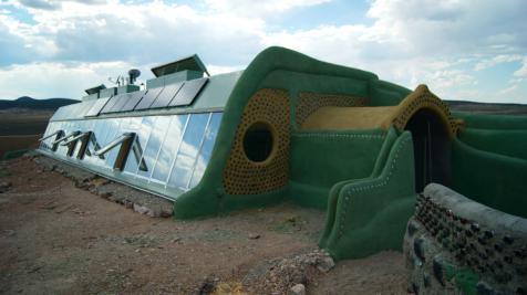

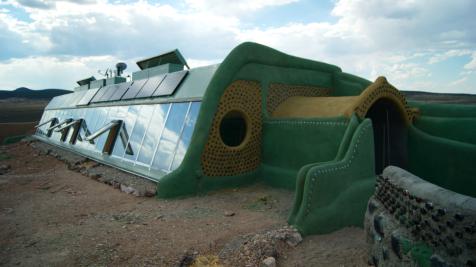

          But also this EARTHSHIPS houses i like a lot from Michael Reynolds.
            earthship Click image for larger version

            ibiza kitchen reformada Click image for larger version

              I worked for Reynolds for 5 years and am building my own Earthship now. Will start a thread in anybody is interested. Earthship is Autonomous house. Exterior walls are rammed earth encased in rubber (tires) They harvest water, process their own waste with grey water and black water systems (my house will not have black water), make their own electricity, and have a built in greenhouse as part of the desighn
                Have also added a small can/bottle/cob greenhouse to the bus im living in while I build my house
                  Yes, everyone please share, post pictures etc...
                  Very interested in solutions to obstacles etc..
                    I'll be adding more pics today to this album that are Earthship related (bottle walls etc). The privacy settiing is public so anyone should be able to look at this.
                      some stuff from 2011. can walls, bottle walls, beginning of a structure with 18" thick mud bottle walls. I wouldn't make bricks myself..make mud and build the wall instead of make mud, make bricks, then build wall
