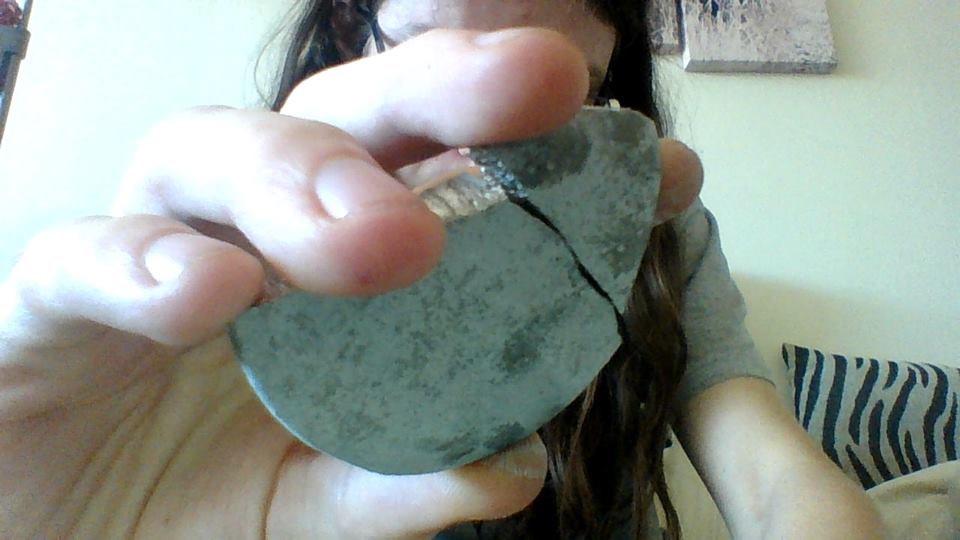

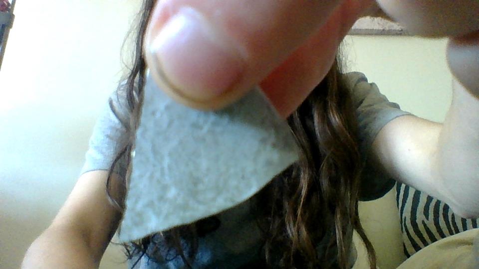

Some pics of the alloy before activation, currently waiting for the pieces to build the activation vessel. This is a AB4.3 alloy of La-Ni-Co-Al
the outside is an oxide coating from the annealing process, easily brushed off to reveal the lustrous silvery metal alloy underneath. I have about 150g, all of it going into 1 electrode ![Smile](https://www.energyscienceforum.com/core/images/smilies/smile.png)
the electrode material is going to be PTFE-60% etOH sol with high conductivity silver intercalated graphite powder, and this alloy in powdered and activated form
the support will be nickel metal mesh. counter electrode is nickel metal mesh.
coming together quite rapidly, i am excited to see how the proof-of concept performs
