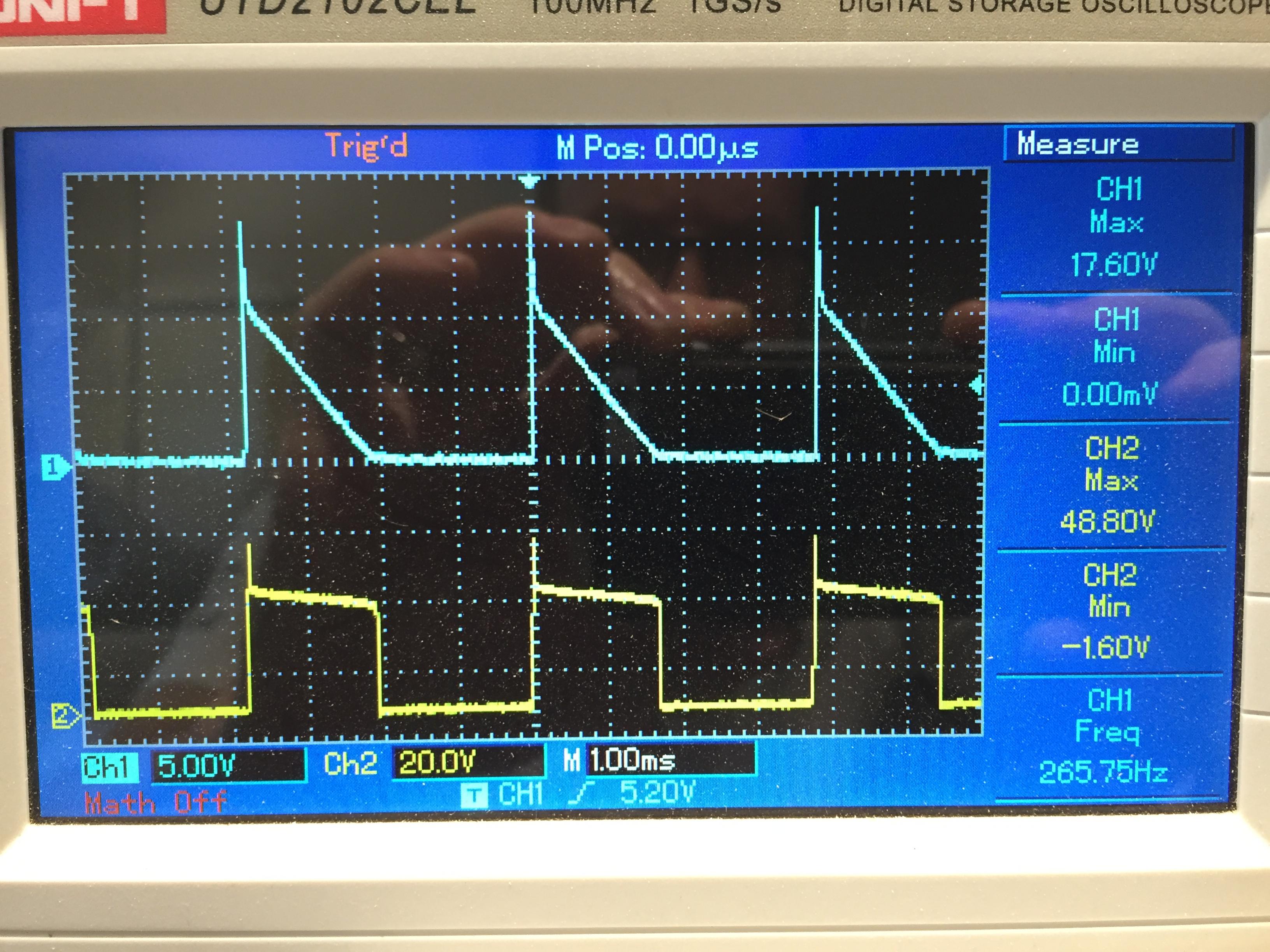

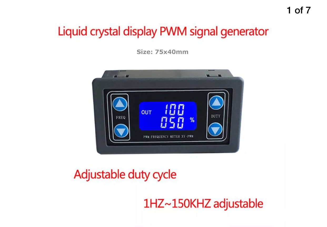

In a simple test, and running at only 2kHz, the battery being charged rose from 12.7V to 15.8V in about 8 seconds and then I could hear gassing inside. This was a battery that was new and had not been used before. For a battery that was about 75% charged the voltage rose from 12.6V to 14.3V in a similar time. Clearly the state of the battery and its chemistry regulates the input of energy to some degree (probably due to the varying impedance) and in the former case the circuit current dropped to around 0.2A compared to about 0.4 A with the partly discharged battery.

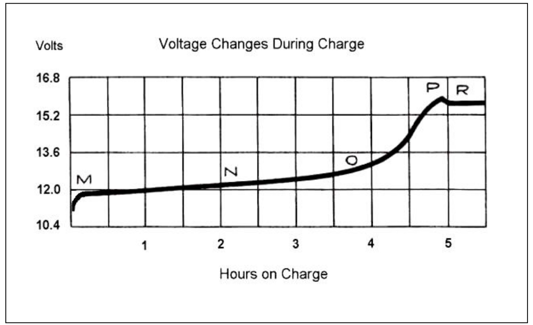

3. Is it possible to damage a battery by feeding it continuously with the HV pulses? Conventional lore proposes a three stage charging process (Bulk, Absorption and Float charging) and to bring the voltage down from 14.4 to 13.4 for the last Float stage and which can be continued indefinitely. It is said that keeping the voltage up at 14.4 or above (15.8V in my case) past the Absorption stage for a long time can damage the battery, especially if continued gassing is maintained and where an SLA battery can't chemically reprocess all of it. Maybe charging with ZPE has a self regulatory property that prevents damage?
